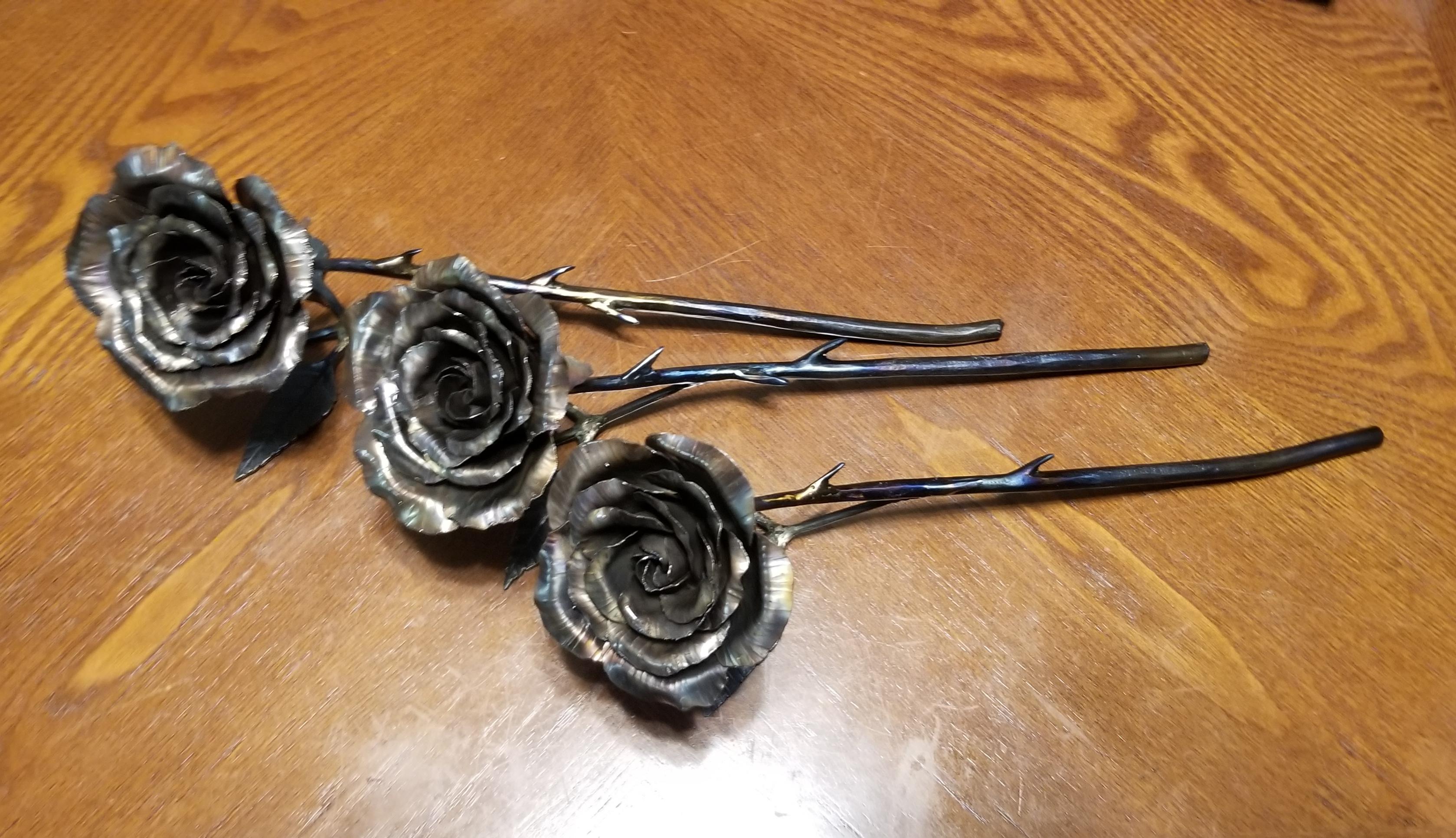

Daswulf Posted January 25, 2019 Share Posted January 25, 2019 Not sure if I'm just not with it or what but I'm struggling getting some roses done. Got 3 out of 6 on the stem, shaped and ready for leaves. Thought I'd have 3 done tonight but they have been fighting me. Quote Link to comment Share on other sites More sharing options...
Mudman Posted January 25, 2019 Share Posted January 25, 2019 those are looking great daswulf Quote Link to comment Share on other sites More sharing options...
jlpservicesinc Posted January 25, 2019 Share Posted January 25, 2019 Das, nice work.. I love the peening texture.. Quote Link to comment Share on other sites More sharing options...
Daswulf Posted January 25, 2019 Share Posted January 25, 2019 Thanks. It only takes an extra 5-10 minutes per rose to hammer and it adds a bit more life to them. Quote Link to comment Share on other sites More sharing options...

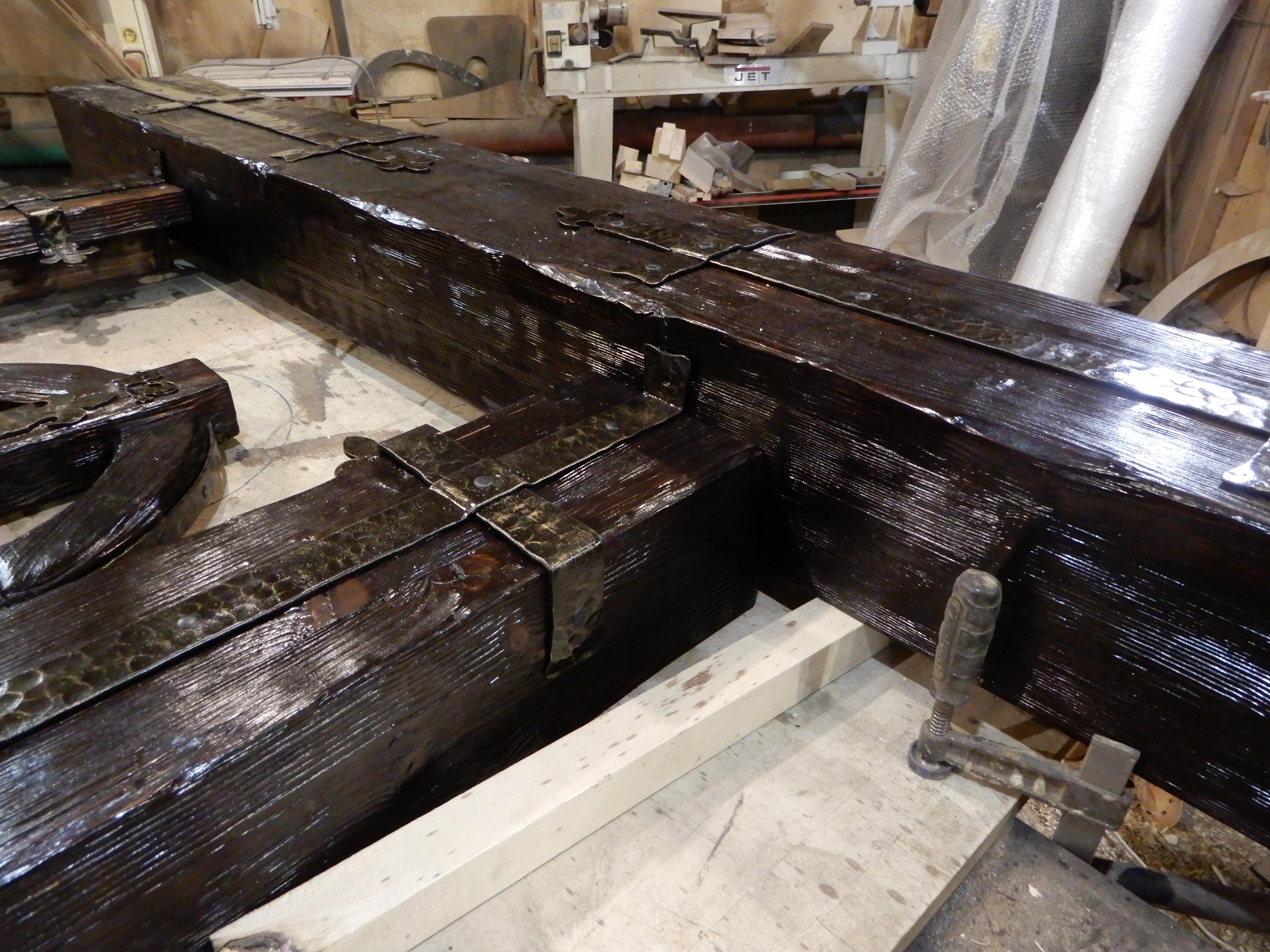

alexandr Posted January 25, 2019 Share Posted January 25, 2019 It remains to drive into place and install. Quote Link to comment Share on other sites More sharing options...
Frosty Posted January 25, 2019 Share Posted January 25, 2019 That is beautiful Alexandr, I can not imagine the customer being anything but thrilled. Did hi order fire tools and maybe a fire wood rack too? I love his fire place but our climate isn't really the place for something like that. Bob: Those are really good tools for chasing critter heads. The part I found really did the trick was putting an angle downwards at the top to act as a stop. It prevents the head from sliding down in the vise and being scored and you don't have to clamp HARD with the vise. When the steel is HOT it's easy to smoosh or score the work deeply. I have one similar to the one you made and it works well. The one I used most though was just a piece of 2" x 2" angle iron. 2" because I don't chase stock larger than that so it bridges the gap in the jaws and rests on both. I'd learned what angle I like best for working clamped it in the vise and welded a short length of 1/2" square to the vertical flange as a story mark and rest. The last mod was to skip trying to cut and bent for a stop or forging surface or whatever for the head to rest against. Instead I welded a piece of 5/8" maybe, I didn't measure, where the head hangs off the end. The one real PITA that takes the super simple out of it is having to weld an extension to the vertical flange so it all clamps in the vise properly. If I make another I'll just cut a section out of the angle iron instead but I had that one all welded up before the light came on. Forgetting obvious things like this is why I try not to get upset when someone points out the obvious to me AND why I tend to point it out to others. It can be too easy to forget the thing that's so obvious you just assume you included or excluded whatever. These are super handy attachments to have on or near your vise. Frosty The Lucky. Quote Link to comment Share on other sites More sharing options...

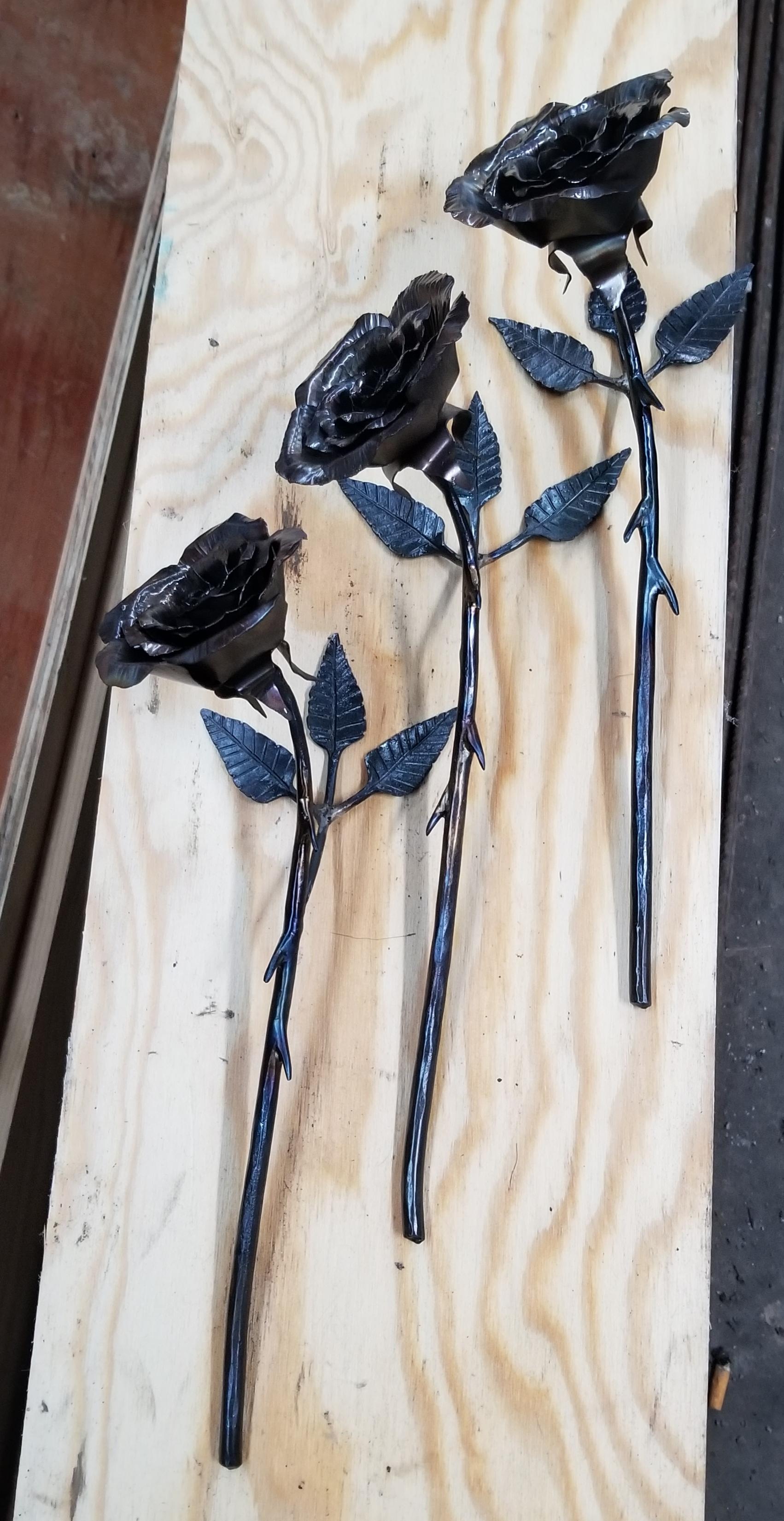

Daswulf Posted January 26, 2019 Share Posted January 26, 2019 Three of six roses done. Quote Link to comment Share on other sites More sharing options...
bobasaurus Posted January 26, 2019 Share Posted January 26, 2019 Das, those are some great roses. I like the leaf details too. Frosty, do you have a photo of your vise rest? I'm not picturing it, but it sounds handy. I used mine today to make my first dragon head, and you're right about it slipping in the vise and scarring the shaft: Quote Link to comment Share on other sites More sharing options...
Daswulf Posted January 26, 2019 Share Posted January 26, 2019 Thanks bob. Awesome for a first dragon! Quote Link to comment Share on other sites More sharing options...
jlpservicesinc Posted January 26, 2019 Share Posted January 26, 2019 Das, nice roses.. I do like the texture on the peddles.. Bob, Nice start.. Another thing I have never done.. LOL.. Quote Link to comment Share on other sites More sharing options...

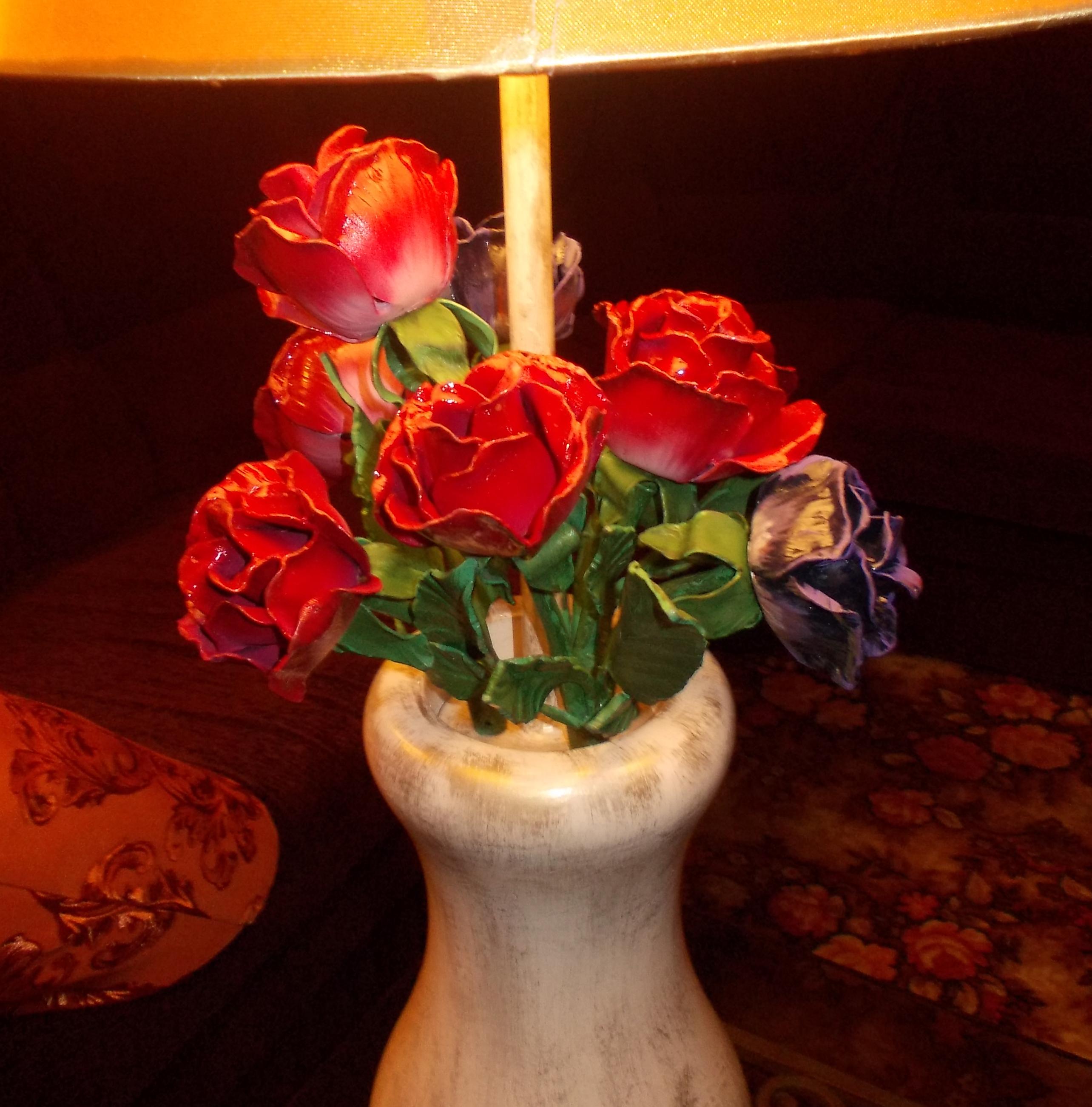

alexandr Posted January 26, 2019 Share Posted January 26, 2019 Hand painted iron roses in the room of a young little princess. Quote Link to comment Share on other sites More sharing options...
ausfire Posted January 26, 2019 Share Posted January 26, 2019 And hand forged furniture too, alexandr. What a lovely room for a little girl! Quote Link to comment Share on other sites More sharing options...
