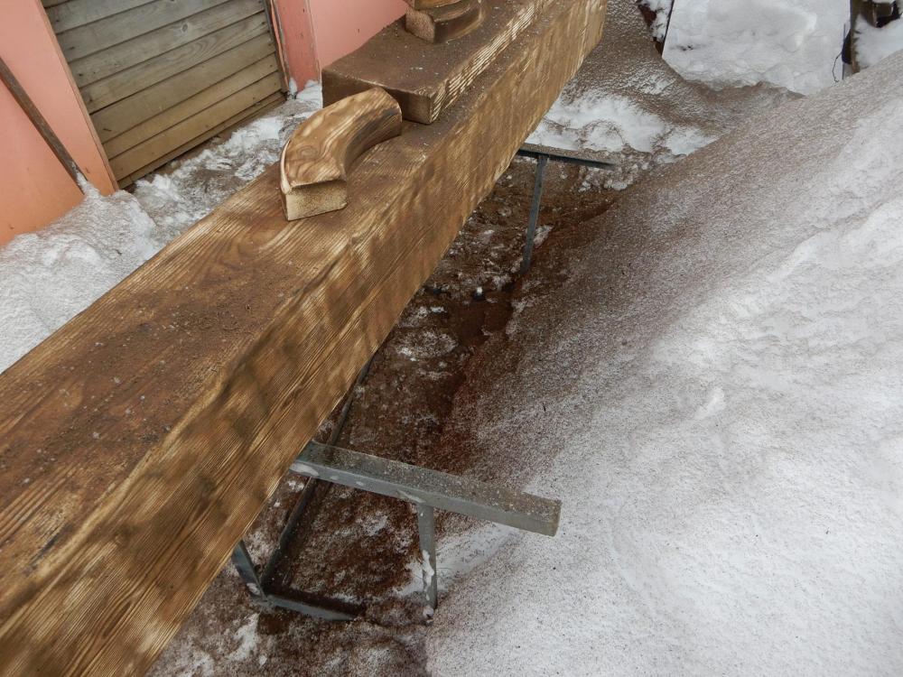

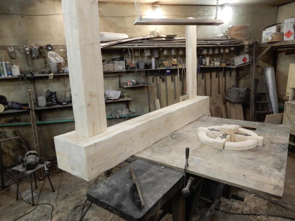

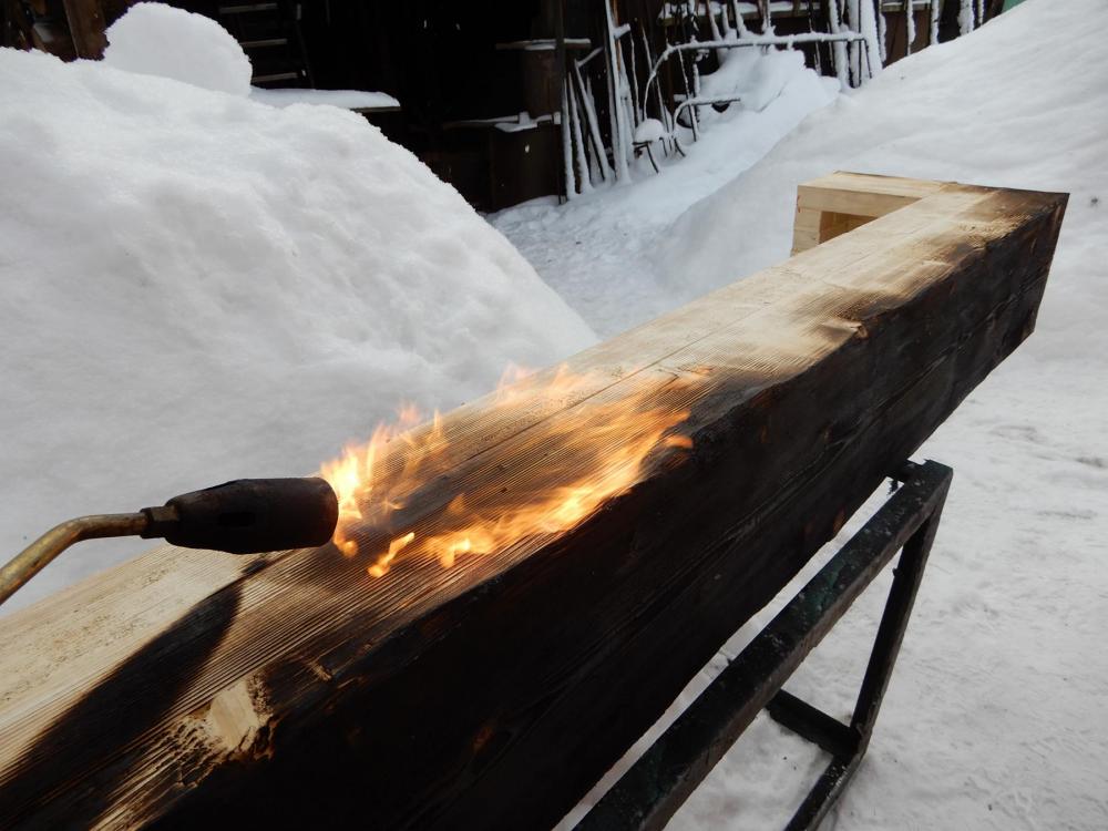

1 hour ago, alexandr said:
In the autumn I made a chandelier. I began to make the decor of aged pine on the fireplace in the same style. The work is very dusty, worked on the street. Today frost -15. I had to dress warmly.
Alexandr,
Congratulations on another beautifull  work.
I know you cannot send me, somehow, your very enviable skills. However, could we come to some agreement with regards to your boots ? This morning was -27 Cº  over here.

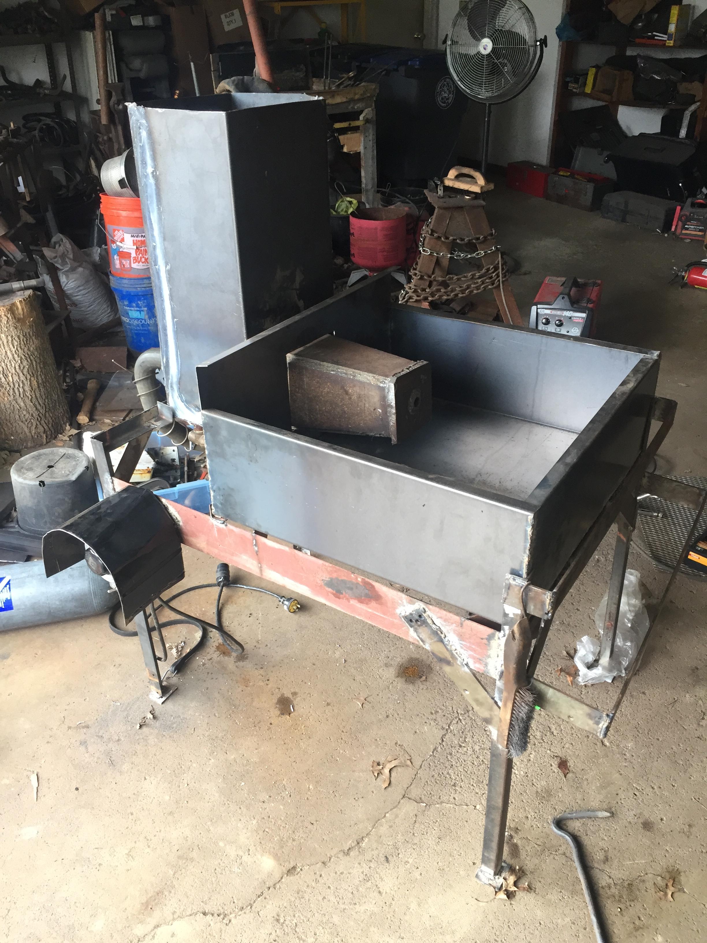

The bosh is the reservoir for the water-cooled tuyere on my forge. It’s the vertical part on the left in this photo:
If it were to freeze, the ice expanding could easily pop a weld and make the tuyere leak. We don’t want that.
Thank you for the quick answer.
My water drum beside the forge is steel. I had installed (too mechanicaly chalendged to do it myself …) a block heater. Took me years to think about it and the village mechanic. No more  winter long emptying a (too) small water bucket and carrying a new supply every morning. It was the emptying that got to me the most ! This  block heater idea might be possible for you as a solution for the colder periods. I have mine on a timer. It heats the water drum (November to April more or less) for 1/2 hour every hour and 1/2.
Since I do not like my steel drum and would prefer a wooden cask, I'll have to see if a block heater can be installed on this. I'll ask the village mechanic who is mechanicaly gifted …
