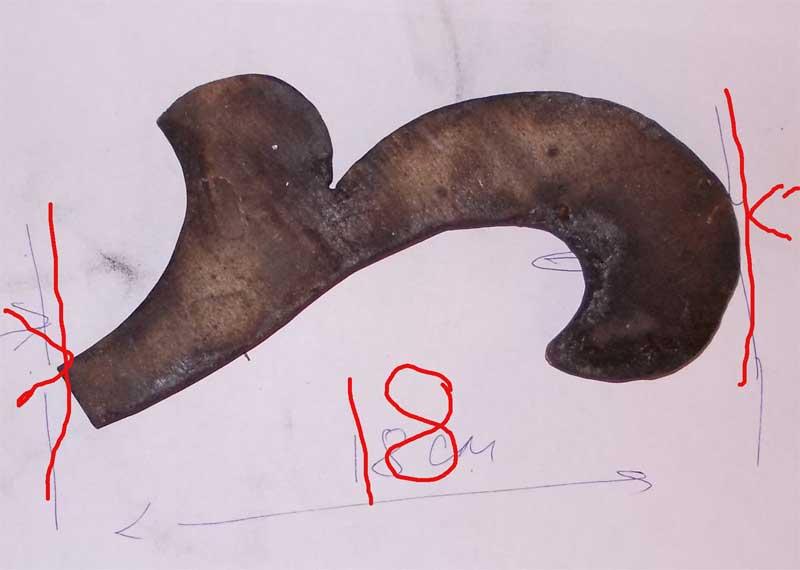

jlpservicesinc Posted January 7, 2019 Share Posted January 7, 2019 Nice work.. May I suggest a preform before you get going making it wider.. A pre-form is a basic shape that is much smaller size wise but has the needed material to make the shape full sized once forged.. Also check out the video on directional forging or peening practice.. The combination of flat face, round face and peen will get your leaf cleaned up nicely.. @Ted Ewert nice hinges.. did you punch the holes or drill them.. Sorry I didn't see them earlier.. Quote Link to comment Share on other sites More sharing options...
Pr3ssure Posted January 7, 2019 Share Posted January 7, 2019 Yeah, I thought about that after I posted it. So it may be that it's straight I was having trouble. I just need to look at it tomorrow. I need to get a cross peen hammer. Well, I have a 2.5 pound one I got from Lowes so I need to find it. Although that's a little heavy for me right now. I'm using a ball peen that's 1.5 lb and I have a straight peen 2.5 lb as well. Quote Link to comment Share on other sites More sharing options...

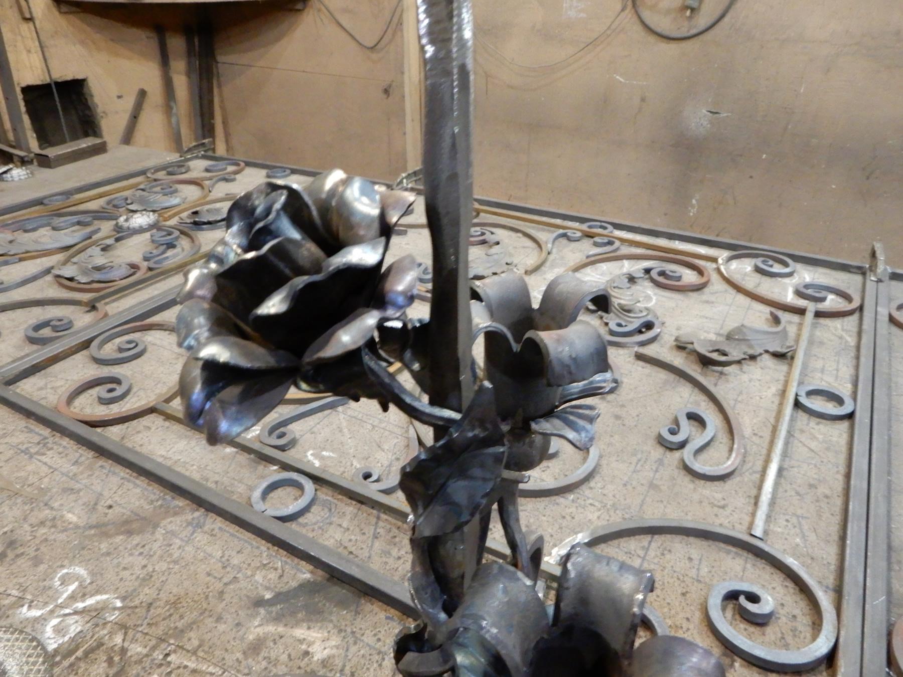

alexandr Posted January 8, 2019 Share Posted January 8, 2019 21 hours ago, Pr3ssure said: My first attempt at a leaf. HI! Try this way. Laser cutting or plasma. In one hour I make more than 100 leaves. Quote Link to comment Share on other sites More sharing options...
Pr3ssure Posted January 8, 2019 Share Posted January 8, 2019 Wish I had a laser or plasma cutter. There's an OxyAcetylene torch in the shop though, so I'm not without. I just need to get better, my cuts are a little hairy to say the least. Those roses and leaves look wonderful though. Quote Link to comment Share on other sites More sharing options...
alexandr Posted January 8, 2019 Share Posted January 8, 2019 I do not have my own laser cutting machine, I order it in another workshop. I have a plasma, but it takes a long time to cut it. Quote Link to comment Share on other sites More sharing options...
Daswulf Posted January 8, 2019 Share Posted January 8, 2019 Yeah, I'm not that good with a plasma cutter. Takes me a while to clean up my cuts. Boy would it be nice to have a cnc plasma cutter. lol theres always something nicer out there. Use what you got till you can upgrade IF you even need to upgrade. Besides its fun hammering out a leaf. Now hammering out 100 leaves in an hour would take a lot of practice. Quote Link to comment Share on other sites More sharing options...
alexandr Posted January 8, 2019 Share Posted January 8, 2019 43 minutes ago, Daswulf said: Use what you got till you can upgrade IF you even need to upgrade. Besides its fun hammering out a leaf. HI! I'm not young anymore. Make it easier to work wherever possible. 51 minutes ago, Pr3ssure said: There's an OxyAcetylene torch in the shop though I use acetylene only for local heating and brazing. Quote Link to comment Share on other sites More sharing options...
Daswulf Posted January 8, 2019 Share Posted January 8, 2019 Oh, Pr3ssure, got a picture of my veining chisel last night to show what I mean about the curve. This one works well for me. You don't want it sharp either. This is just mine, others do it differently but this works well for me. Made from coil spring. Quote Link to comment Share on other sites More sharing options...
alexandr Posted January 8, 2019 Share Posted January 8, 2019 40 minutes ago, Daswulf said: Now hammering out 100 leaves in an hour would take a lot of practice. These leaves are made of twig. 20 pieces at a time, for more power is not enough. Quote Link to comment Share on other sites More sharing options...
Glenn Posted January 8, 2019 Share Posted January 8, 2019 Plasma works well if you are cutting several of one design. Build a template and it gets easy. Just remember to cut out out extra for shelf stock. Quote Link to comment Share on other sites More sharing options...
alexandr Posted January 8, 2019 Share Posted January 8, 2019 8 minutes ago, Glenn said: Build a template and it gets easy. Just remember to cut out out extra for shelf stock. One plywood template is enough for about 10 blanks. Quote Link to comment Share on other sites More sharing options...
