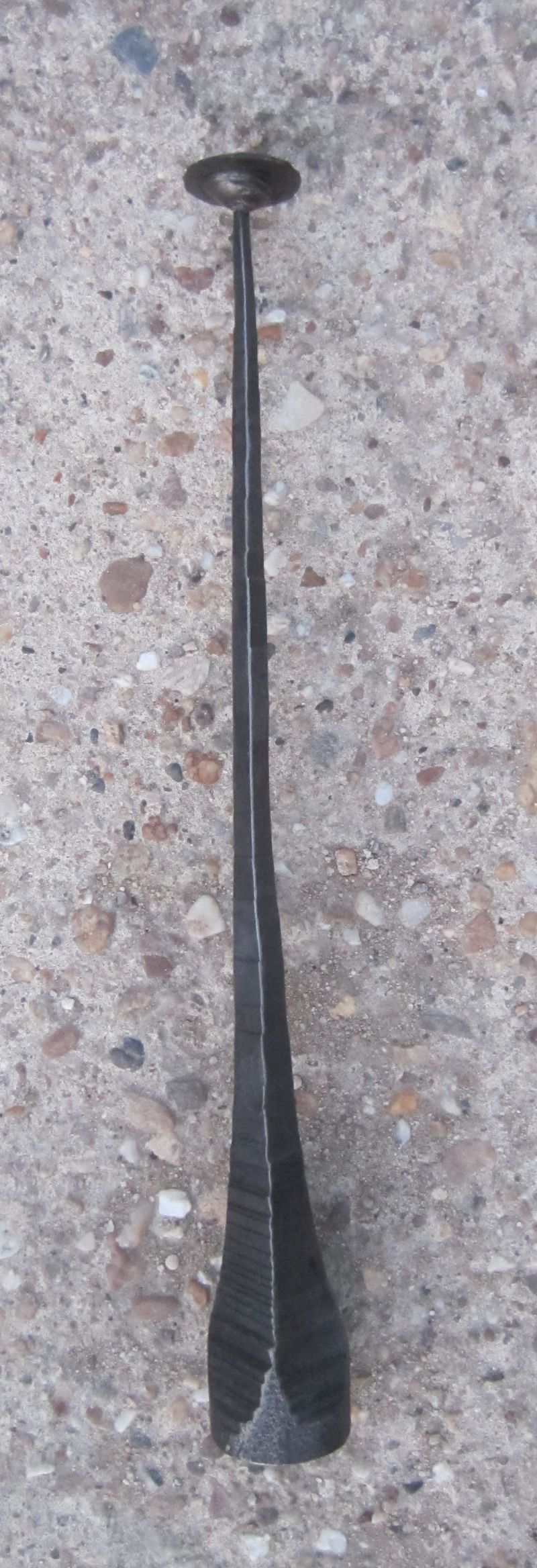

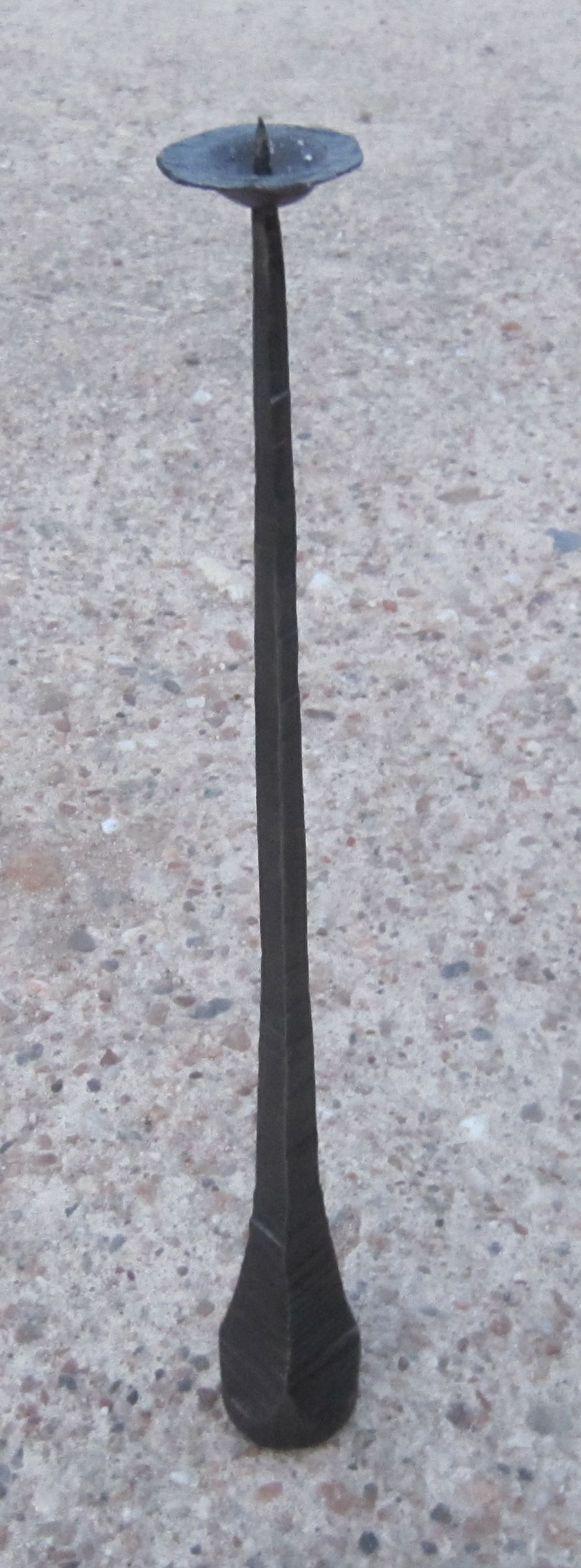

I made this candlestick a couple weeks ago. But just today got pictures of it:. Starting stock was 40mm dia mild steel, all stem work done with power hammer. Very difficult to photograph, you have to use your imagination to interpret the pictures :) It's not chubby but has got bottom weight,,,
58fe64ee095d0_201704gyertyatarto40kr.thumb.jpg.204e9e52a5fa3db3645925879d62eb78.jpg58fe64ef8d0bb_201704gyertyatarto40kr1.thumb.jpg.d61d1d7bd185f23efd41842edd037626.jpg
58fe64dd0e2c7_201703tapergyertyatarto1.thumb.jpg.e944e799f62153524d084ceff15d0d79.jpg

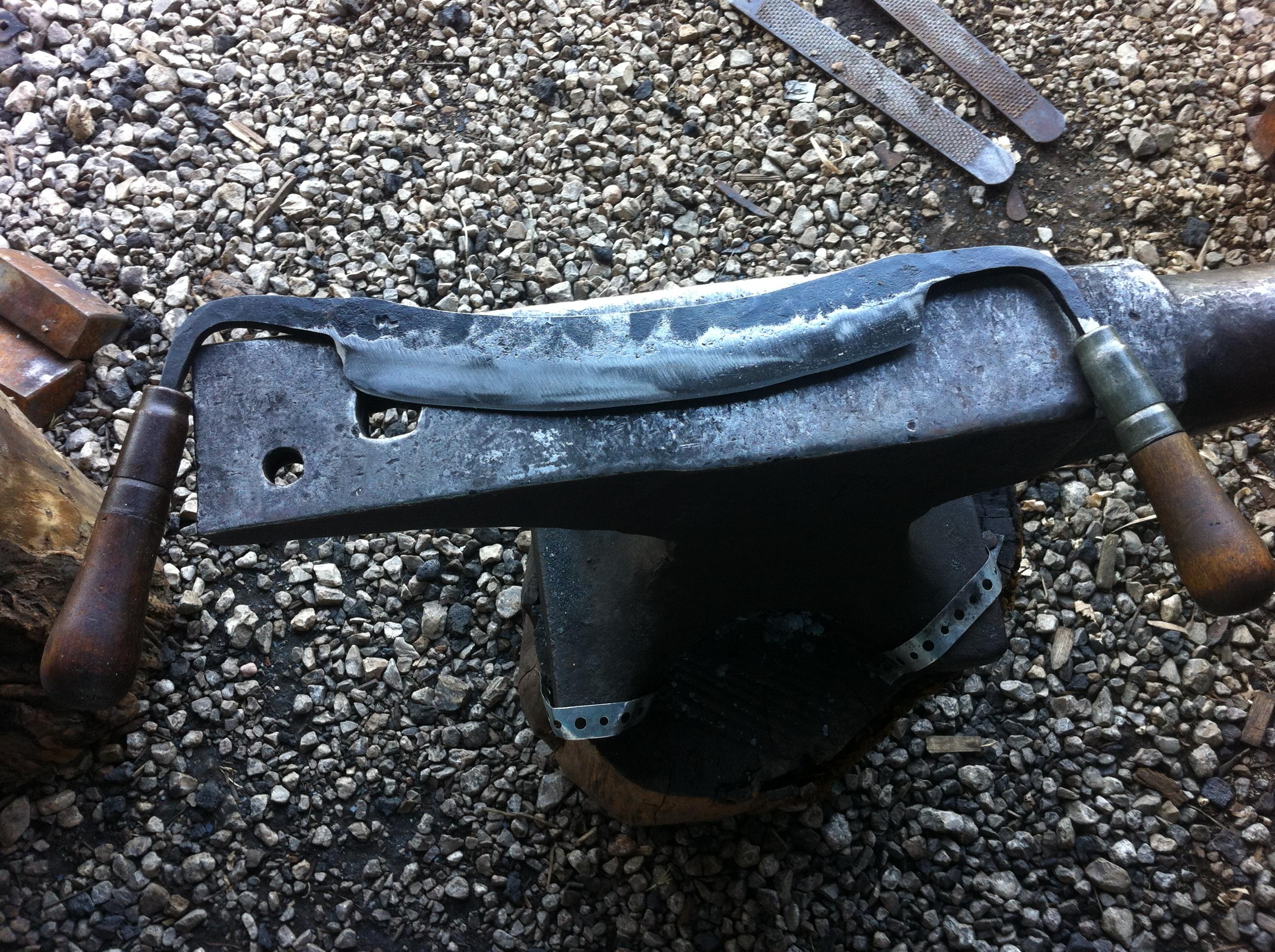

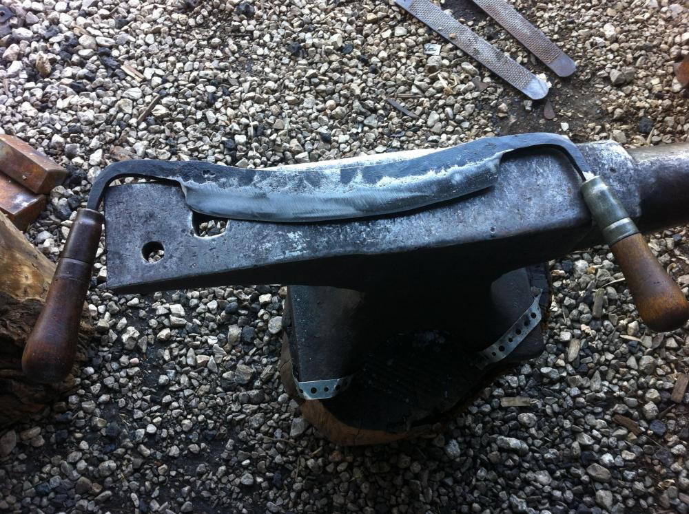

Also forged a quick and dirty drawknife out of an old high carbon WI buggy spring. This will stay in my shop deffinantly! not good enough to leave!!

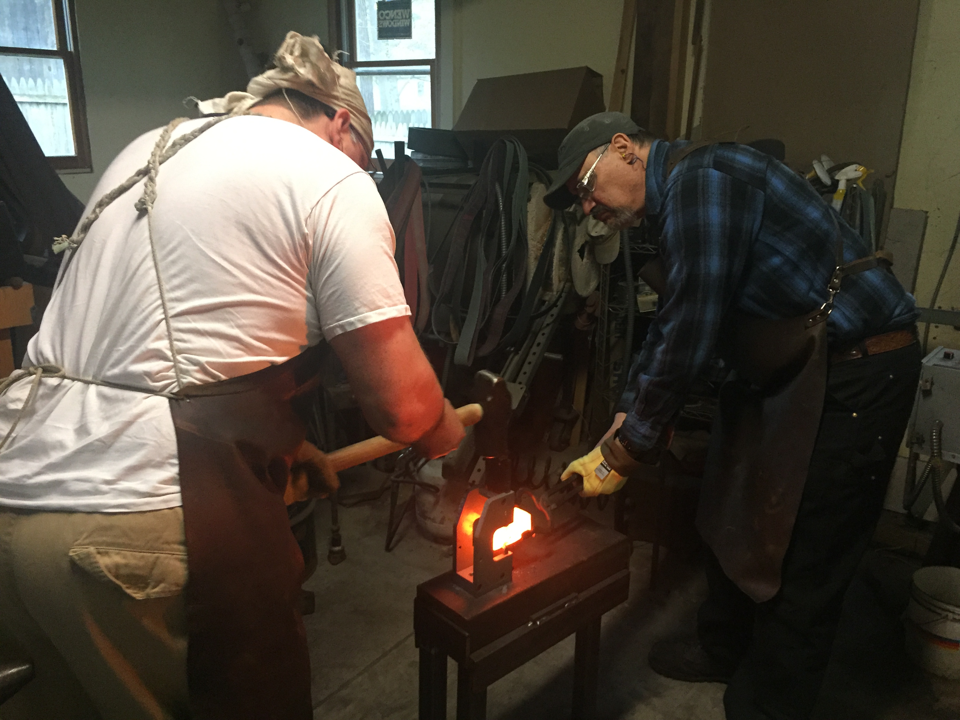

Here it is as forged, cooling on Dan's striking anvil (with a very tired Andrew in the background). I'll post another photo once it's been ground, heat treated, and handled.

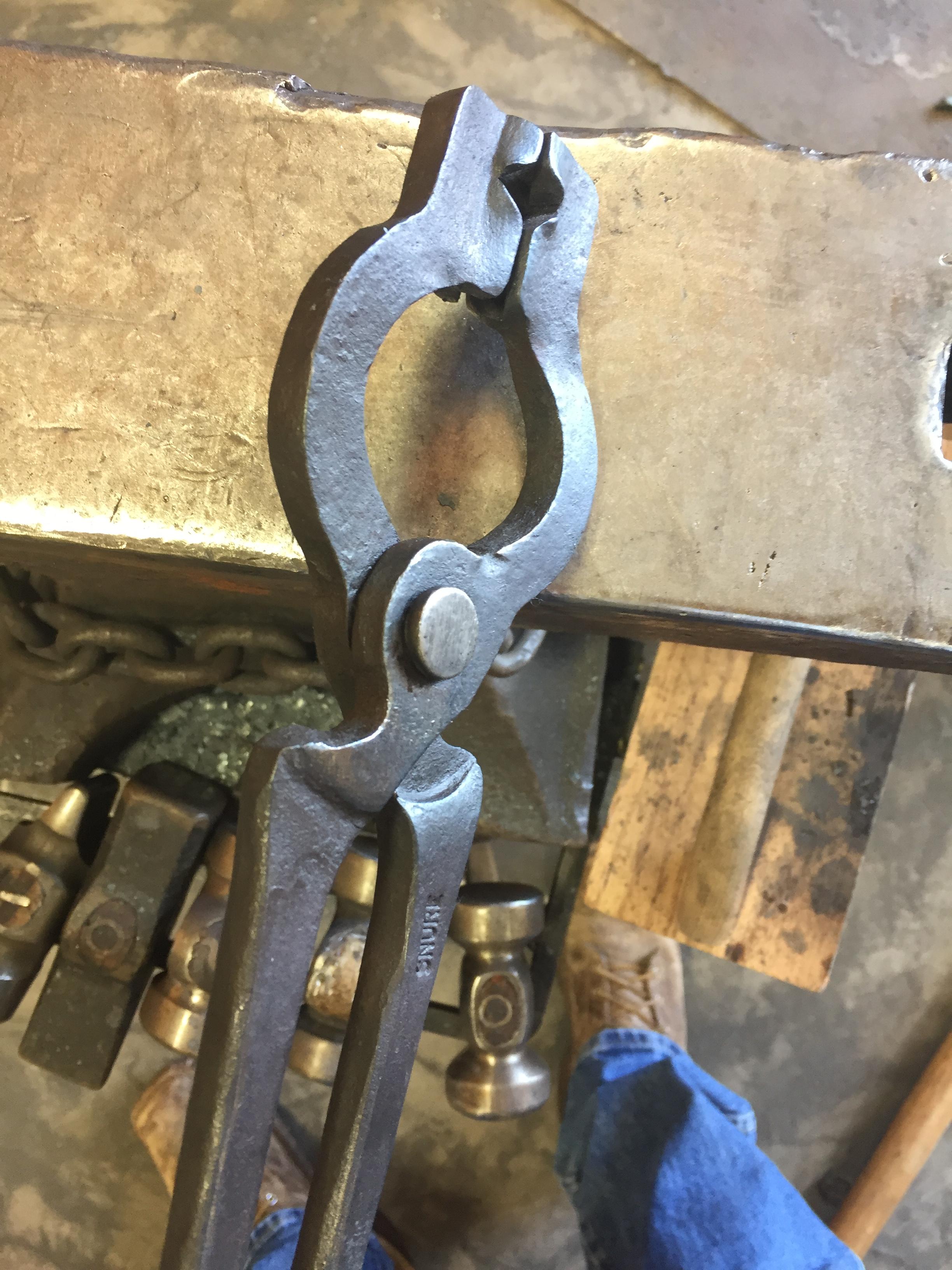

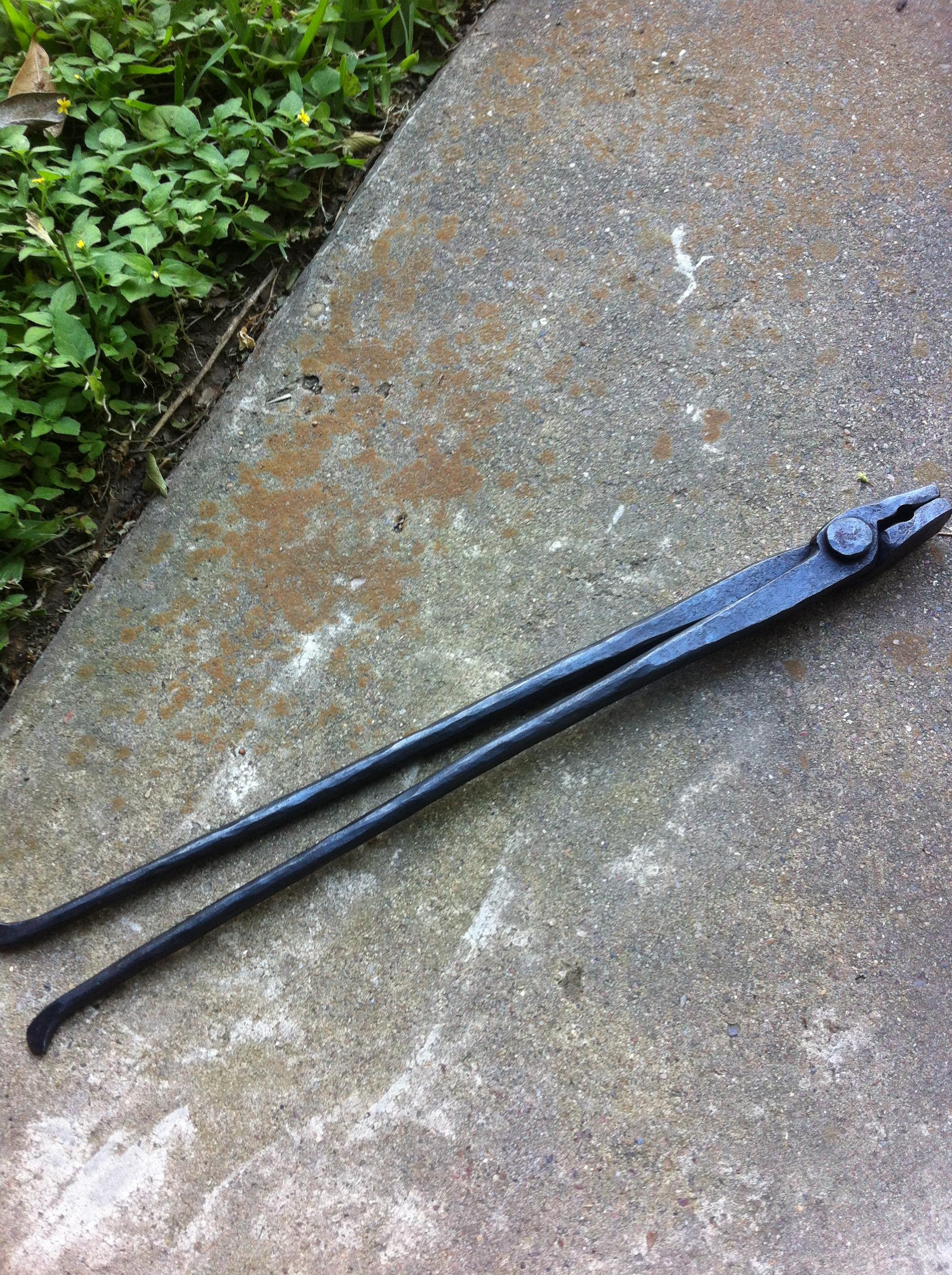

here is a pair of tongs I made to replace a not so good pair I had made early on. I gave the other pair to a guy who came and bought some coke today (we got another 2,000lbs in). Its amazing how excited people can get over trashy tools!
Also finished that drawknife, and man it cuts!
I didn't bother polishing the bevels to a high grit because it will stay in the shop and would just be a waste of time for me.

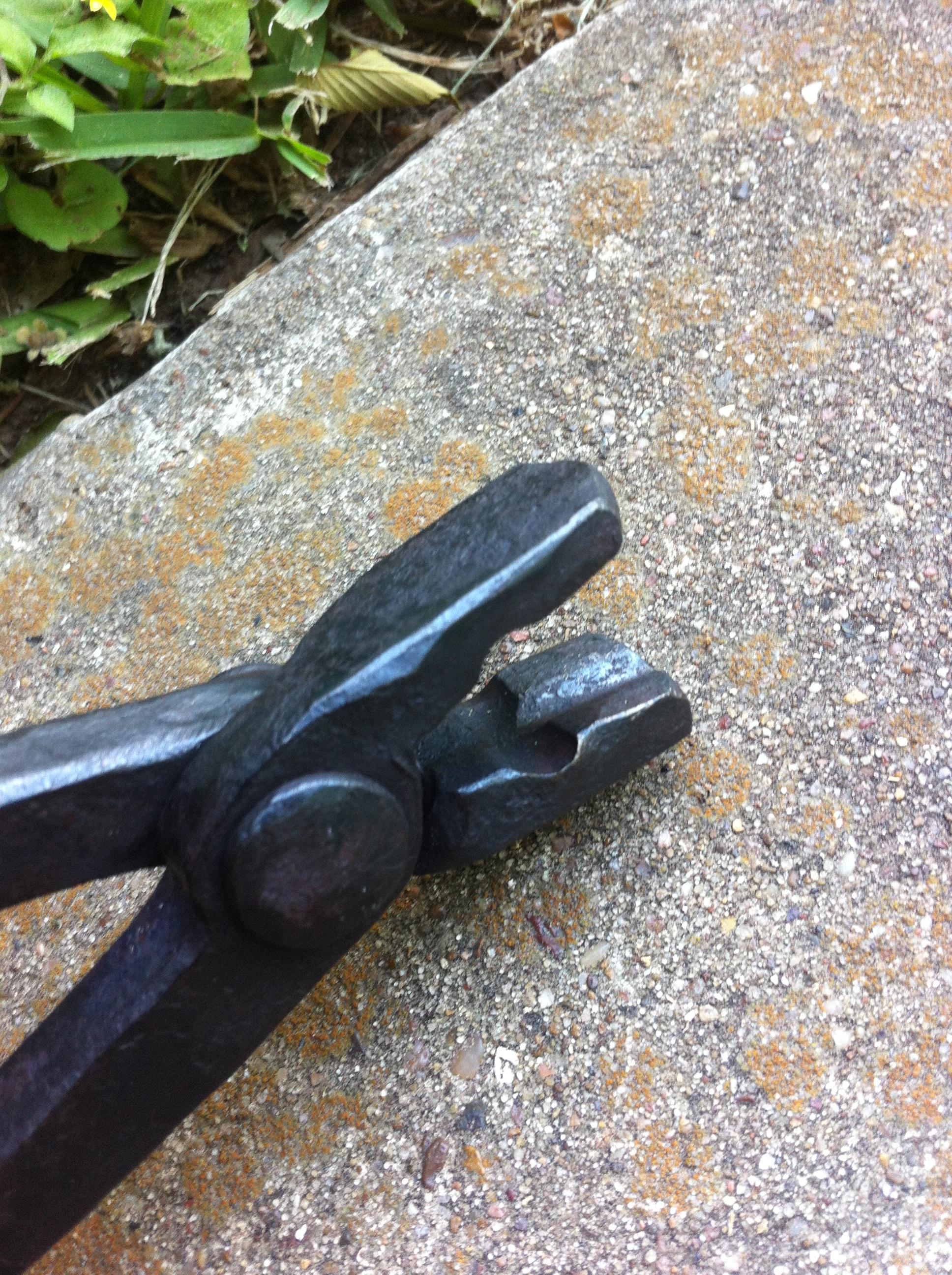

On 27/04/2017 at 0:39 AM, Ranchmanben said:

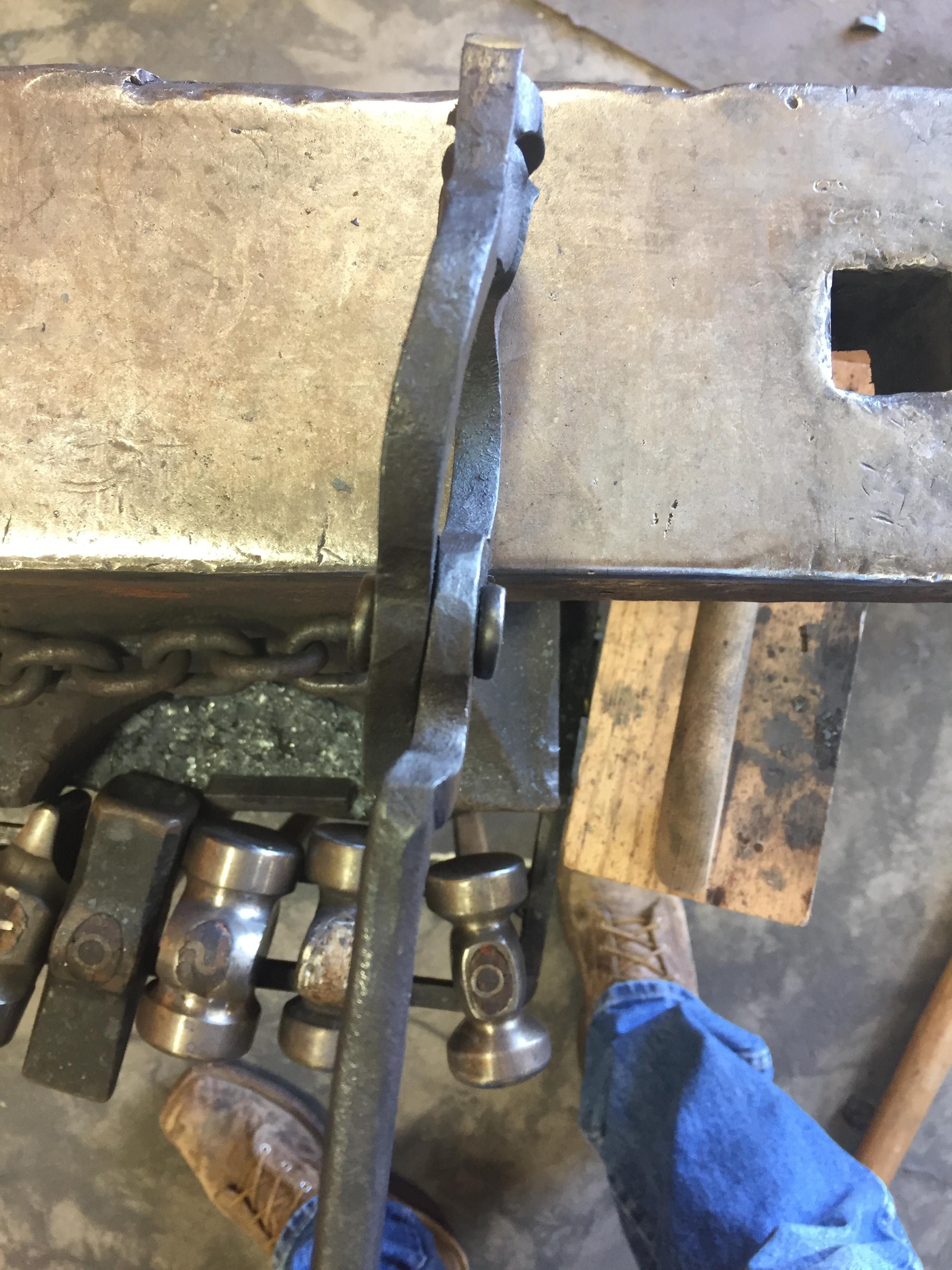

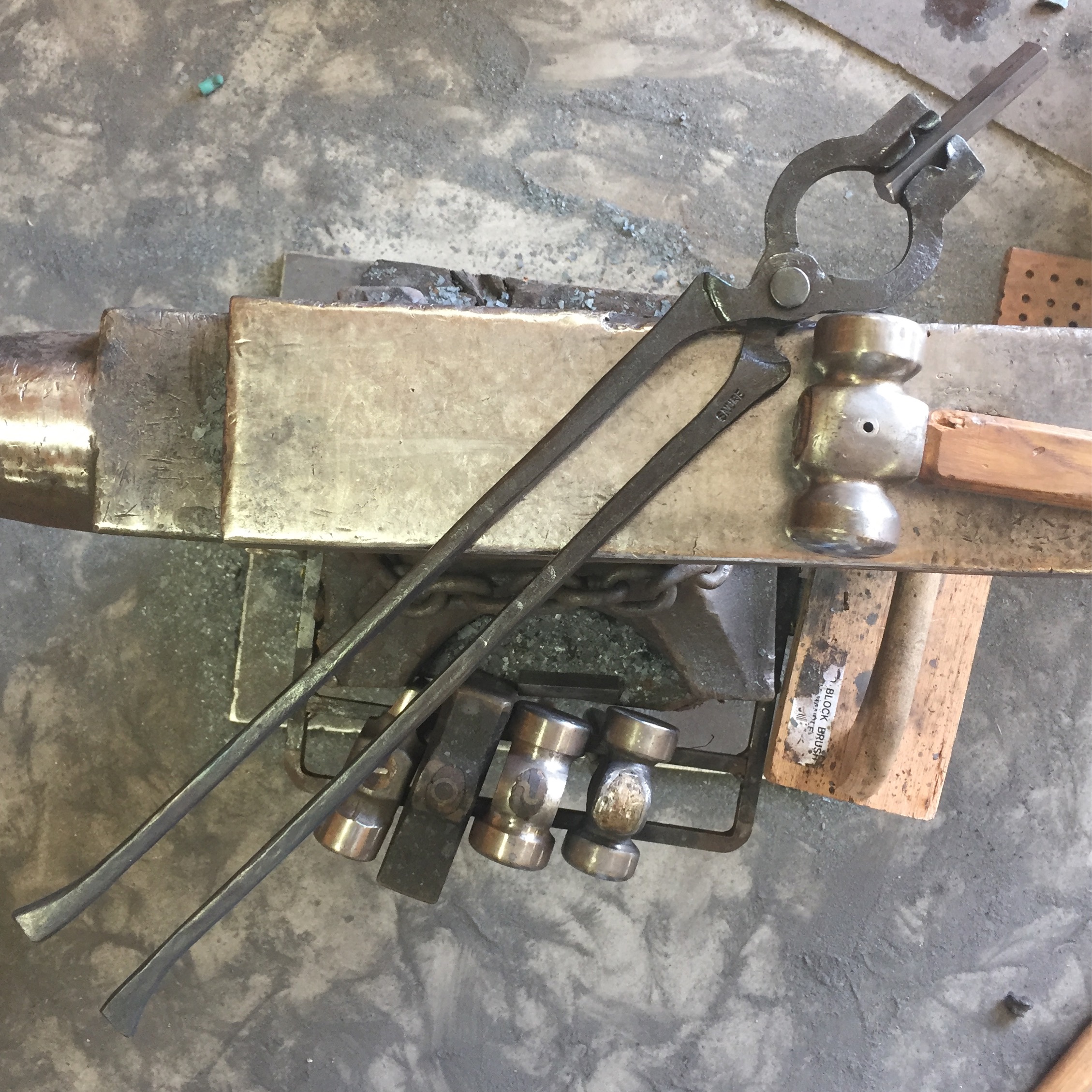

Got a little time this afternoon to beat out a set of 3/8" bolt tongs
IMG_1980.thumb.JPG.68a9a41d3750eabdd81b12b11bcb6a7a.JPG.bb13f8756c08b146b48200684565e1fc.JPG
Very good, I like the fresh and clean forging.
I have often left "no nip" lumps on the ends of my reins which double as ring retainers, but not quite so elegant as yours.
Is there a practical/process function for the shoulder/offset I have ringed, or purely the aesthetic function?
Alan
p.s. I have just looked at your other tong progression thread, and am now doubting my first interpretation of the image. I am not sure if what I am seeing is a joggle with a scratch or a shoulder! Whether the rein at the ringed point is coming towards me or going away! Could you post a photo of a 3/4 view of the jaws? :)
Are there shoulders on both sides of the jaws...so the jaws come off the reins centrally. Or is the transition a joggle?
Alan
Thank you Alan, I didn't really need this set of tongs but I like making them. That ring is how I do my offset. I'd seen it done similarly on Riley Kirkpatrick's tongs and decide to incorporate it into mine.
All is clear...it is a joggle...the play of light in your other photo puzzled me. Thanks for the illumination!
On one of his videos, Clifton Ralph has a tool with a series of profiles as a bottom block on his power hammer which enables him to produce cross-chops / bolt tongs in one heat! Very cunning. Worth a look even for those without a power hammer, to get some insights into efficiency.
Thanks again for the new photo.
Alan

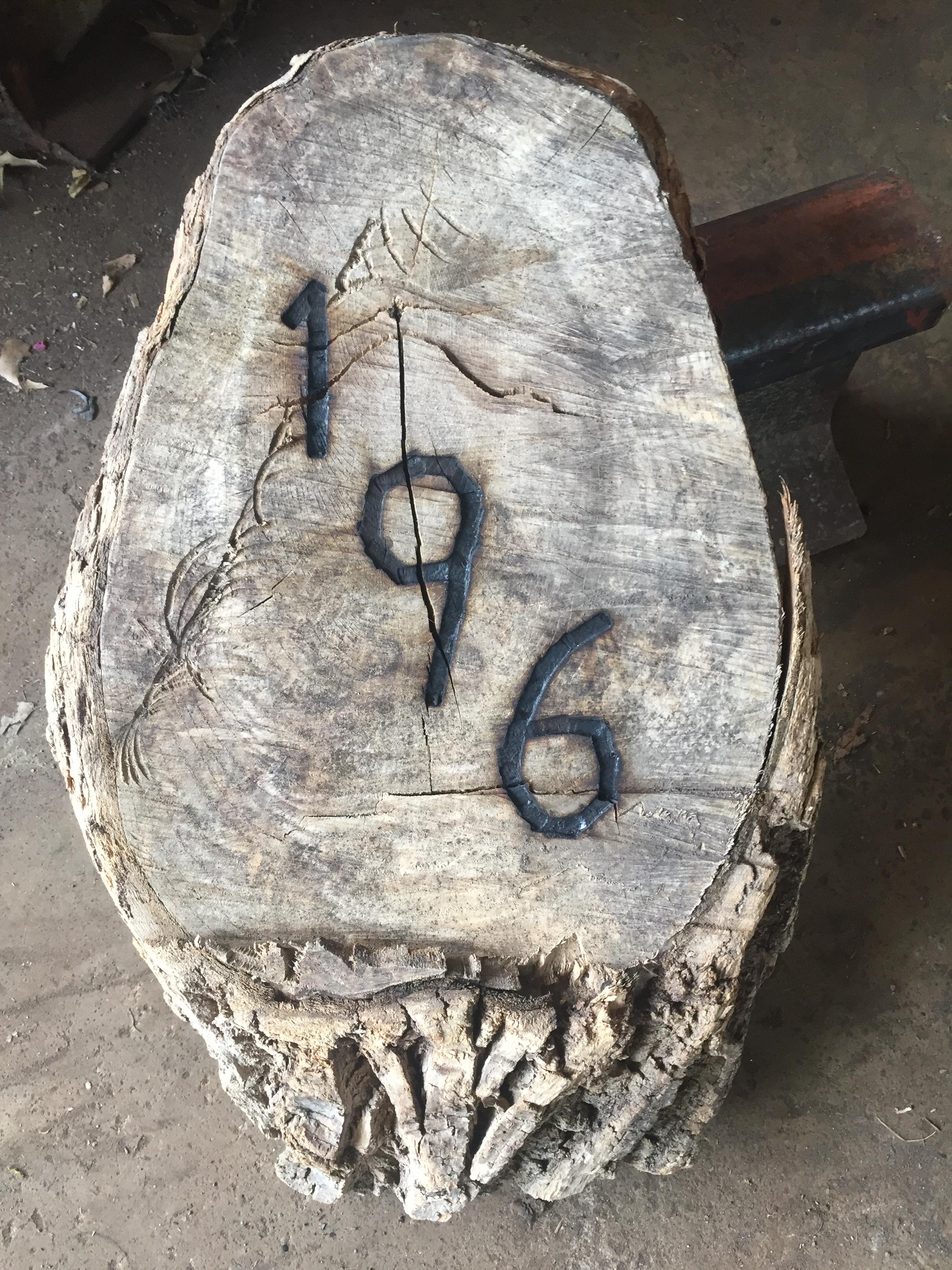

Bit of an unusual project: my mechanic asked me to burn the number of his camp into a rough-cut board.  Considering how well he keeps me stocked with axles and springs, I was happy to oblige.
Didn't make any special branding iron; just used the end of a length of 1/4" x 3/4" bar.
