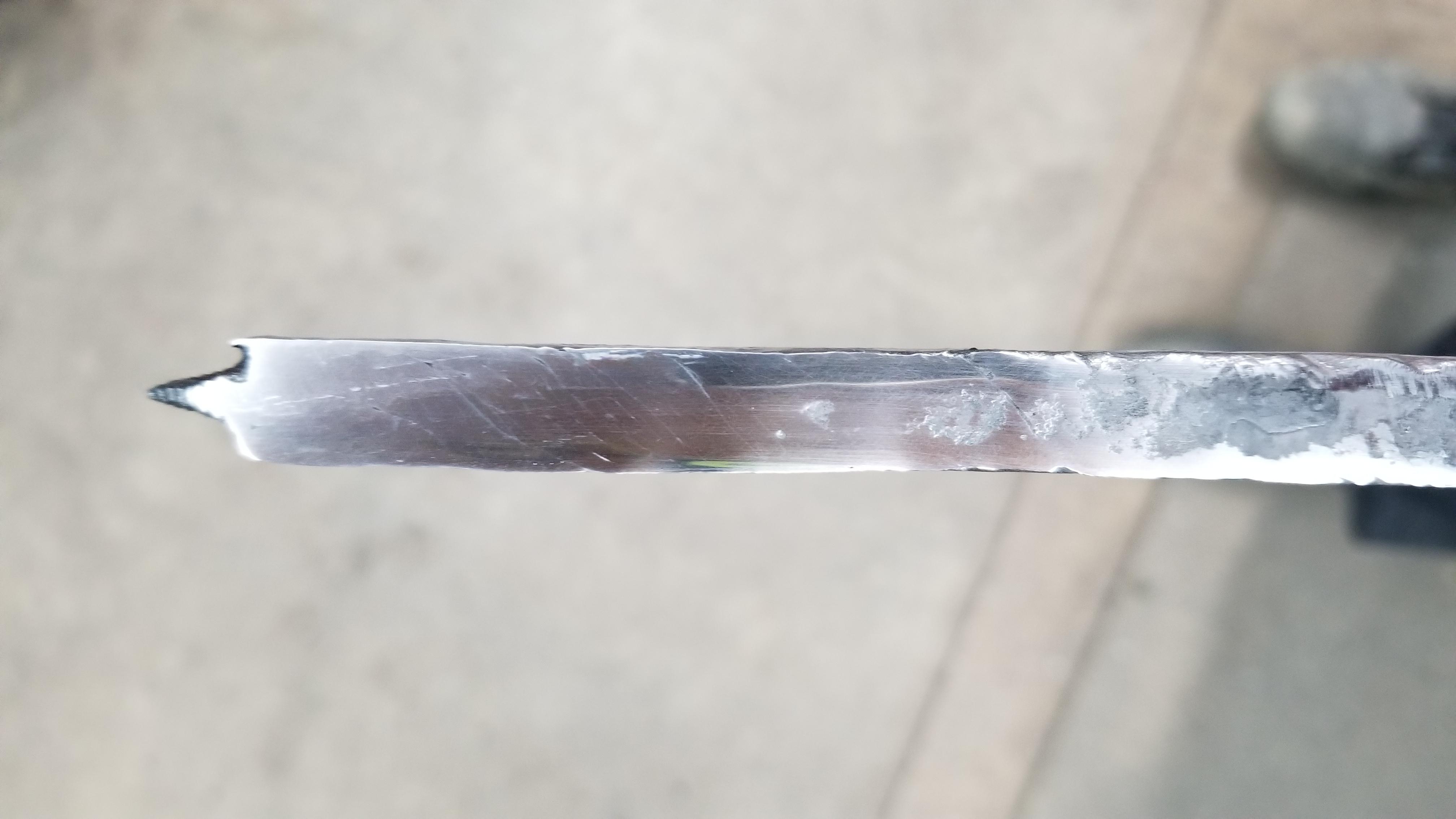

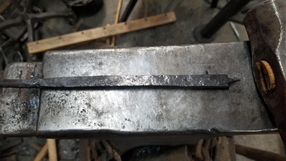

Daswulf Posted December 6, 2018 Share Posted December 6, 2018 Last night I forge welded some piano wire wrapped around an auger bit as suggested in the followed me home thread. Tonight I was curious if it would have any pattern and it did. Not great but I also didnt get crazy with it. It's a little over 30 strands of what was labled (18 1/2) piano wire placed in each flute of the unknown size bit ( forgot to measure it.) Mig welded near the tip, Then heated and wrapped around in the flutes. Then forge welded to a 3/16"x1/2" bar. Cleaned up a portion and etched in heated vinegar to see the pattern. Might forge it into a small blade at some point. Quote Link to comment Share on other sites More sharing options...
JHCC Posted December 6, 2018 Share Posted December 6, 2018 Interesting. I should talk to the piano techs in the conservatory. Quote Link to comment Share on other sites More sharing options...
Daswulf Posted December 6, 2018 Share Posted December 6, 2018 Might be worth it. I could have started this better after trying it. I'm still surprised I got it welded. After I cut all the strands and had them mig welded to the bit I was losing hope while trying to wrap them in the flutes. And really didn't think I'd get it forge welded together. Through calm persistence I got it. There were bigger wires but they were actually copperwound. I'll save those for sculpture ideas. I think twisting the two groups of piano wire first might have helped. Quote Link to comment Share on other sites More sharing options...
ausfire Posted December 7, 2018 Share Posted December 7, 2018 Ah! Nothing like 'calm persistence' Das. You got an interesting pattern there. Now I'm thinking I might regret turfing out miles of piano wire. I kept all the tuning pins for junk art purposes but dumped the wire. We had lots of old junky pianos at our Museum. Do you know a steam engine will run all day on a piano? Quote Link to comment Share on other sites More sharing options...
Gazz Posted December 7, 2018 Share Posted December 7, 2018 Das, nice going on the auger bit! I am thinking the copper wound piano wires are actually plated steel and maybe a brief soak in some muriatic would remove it. You could also try some cable mixed in with the piano wires and then twist the whole billet. I have been saving auger bits for various projects and have made poker handles with them by winding twisted heavy wire into the flutes and I may even have a picture somewhere. Quote Link to comment Share on other sites More sharing options...
Daswulf Posted December 7, 2018 Share Posted December 7, 2018 5 hours ago, ausfire said: Do you know a steam engine will run all day on a piano? There has to be a good joke in there somewhere but I know what you mean. Lol Yeah you should have held on to it. The small stuff I used was really tough to bend. Gazz, I thought that about the copper on the bigger wires at first but I took a small grinder to the copper on the biggest one and went half way through the winding without hitting any other metal. Maybe these are solid copper windings? I'll play some more when I find time. The wound wires could be good for scrap art pieces as well. I do think some alternate wire mixed in might enhance the pattern a bit. Quote Link to comment Share on other sites More sharing options...

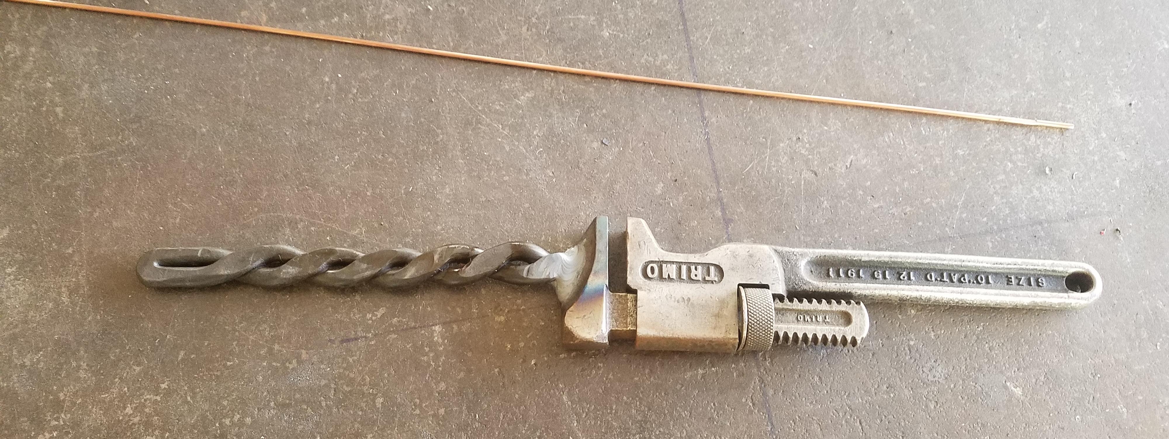

psacustomcreations Posted December 7, 2018 Share Posted December 7, 2018 Todays goal was to add a handle to my twisting wrench and try out a new twist. I flattened the 3/8" bar to make it more in the shape and feel of the existing handle. I also tried a leaf shaped curtain rod holder. The leaf is ugly but I have a better understanding of the order of operations to make these in the future. Suggestions for improvement are always welcome. Quote Link to comment Share on other sites More sharing options...
