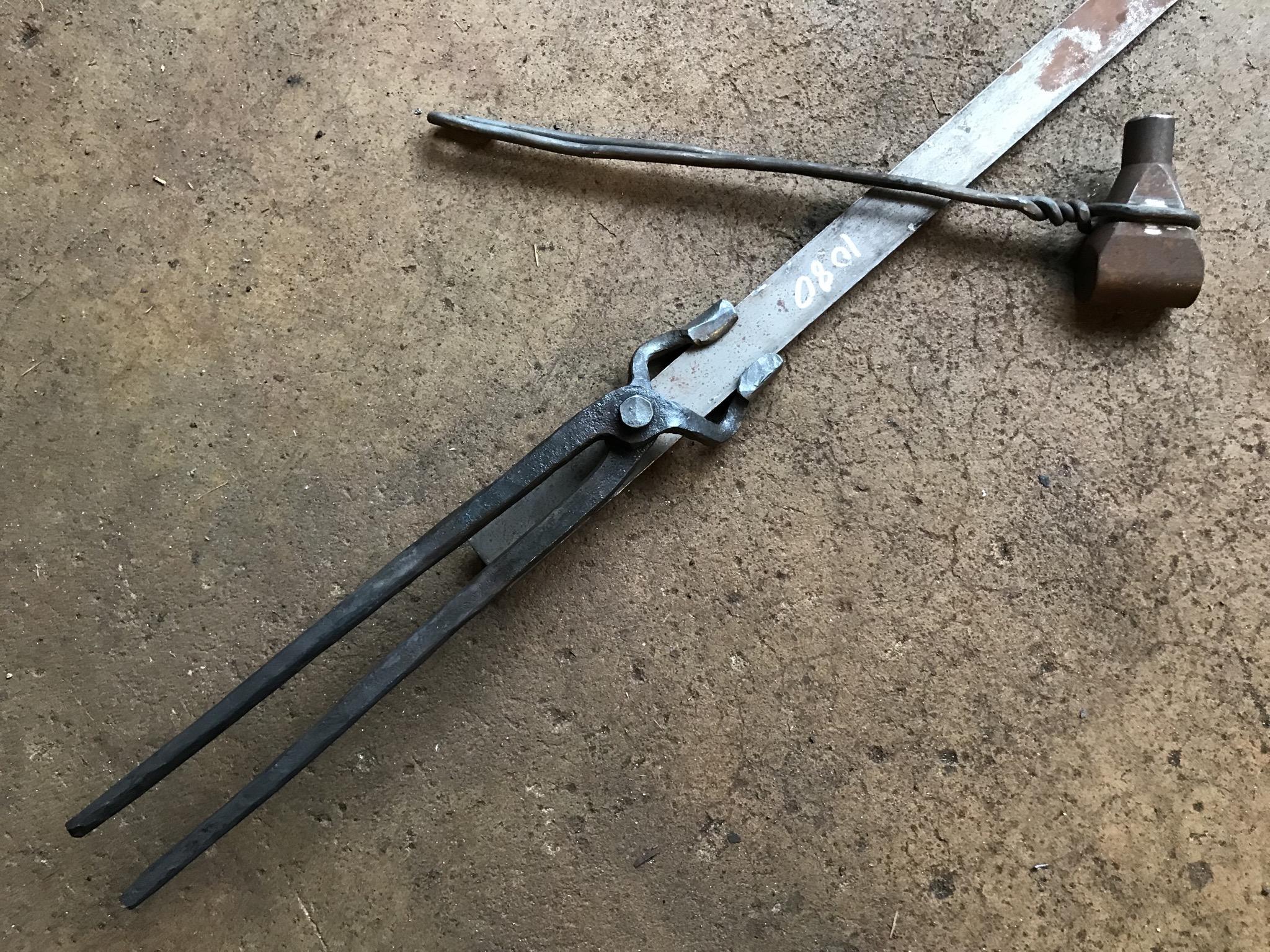

JHCC Posted October 7, 2018 Share Posted October 7, 2018 Turned a jackhammer bit preform into a rodded top fuller and banged out a pair of offset tongs to fit the 1080 bar stock I picked up at Quad-State. Link to comment Share on other sites More sharing options...
jlpservicesinc Posted October 7, 2018 Share Posted October 7, 2018 John, Nice tongs.. While I appreciate the work put into the fuller I just have never liked rodded handles.. Link to comment Share on other sites More sharing options...

Ranchmanben Posted October 7, 2018 Share Posted October 7, 2018 That’s a nice looking set of tongs John. I’ve gotten to where I like a rod handle for use with the power hammer but I like a bigger grip of some sort. Link to comment Share on other sites More sharing options...

JHCC Posted October 8, 2018 Share Posted October 8, 2018 3 hours ago, jlpservicesinc said: John, Nice tongs.. While I appreciate the work put into the fuller I just have never liked rodded handles.. 3 hours ago, Ranchmanben said: That’s a nice looking set of tongs John. I’ve gotten to where I like a rod handle for use with the power hammer but I like a bigger grip of some sort. Thanks to you both. I haven’t developed a strong preference for wooden handles vs. rodded. In this case, though, being able to use the preform without any modification (beyond notching it for the rod) was a big plus. Link to comment Share on other sites More sharing options...
JHCC Posted October 8, 2018 Share Posted October 8, 2018 Tong update: just noticed a cold shut on one of the jaws. Hopefully I can file it out, but otherwise I'll have to be making another pair. Ah, well: live and learn. Link to comment Share on other sites More sharing options...
JustAnotherViking Posted October 8, 2018 Share Posted October 8, 2018 If they are otherwise suitable for the intended stock and personal use, why not just grind it out, and fill it back in with weld rather than making another pair? Link to comment Share on other sites More sharing options...
JHCC Posted October 8, 2018 Share Posted October 8, 2018 BECAUSE I'D GET TO MAKE ANOTHER PAIR!!! Seriously, though, I'll have to see how it works out. They may be perfectly adequate; I just have to see how deep the crack goes and how much metal is left after filing. This was my first pair with this type of nib, and I'd be happy to give it another try. Link to comment Share on other sites More sharing options...
ThomasPowers Posted October 8, 2018 Share Posted October 8, 2018 Or you could just make the one piece that is messed up and rivet it in place of the bad one... Link to comment Share on other sites More sharing options...
JHCC Posted October 8, 2018 Share Posted October 8, 2018 Harder to do with split-rein tongs, but not impossible. Link to comment Share on other sites More sharing options...
