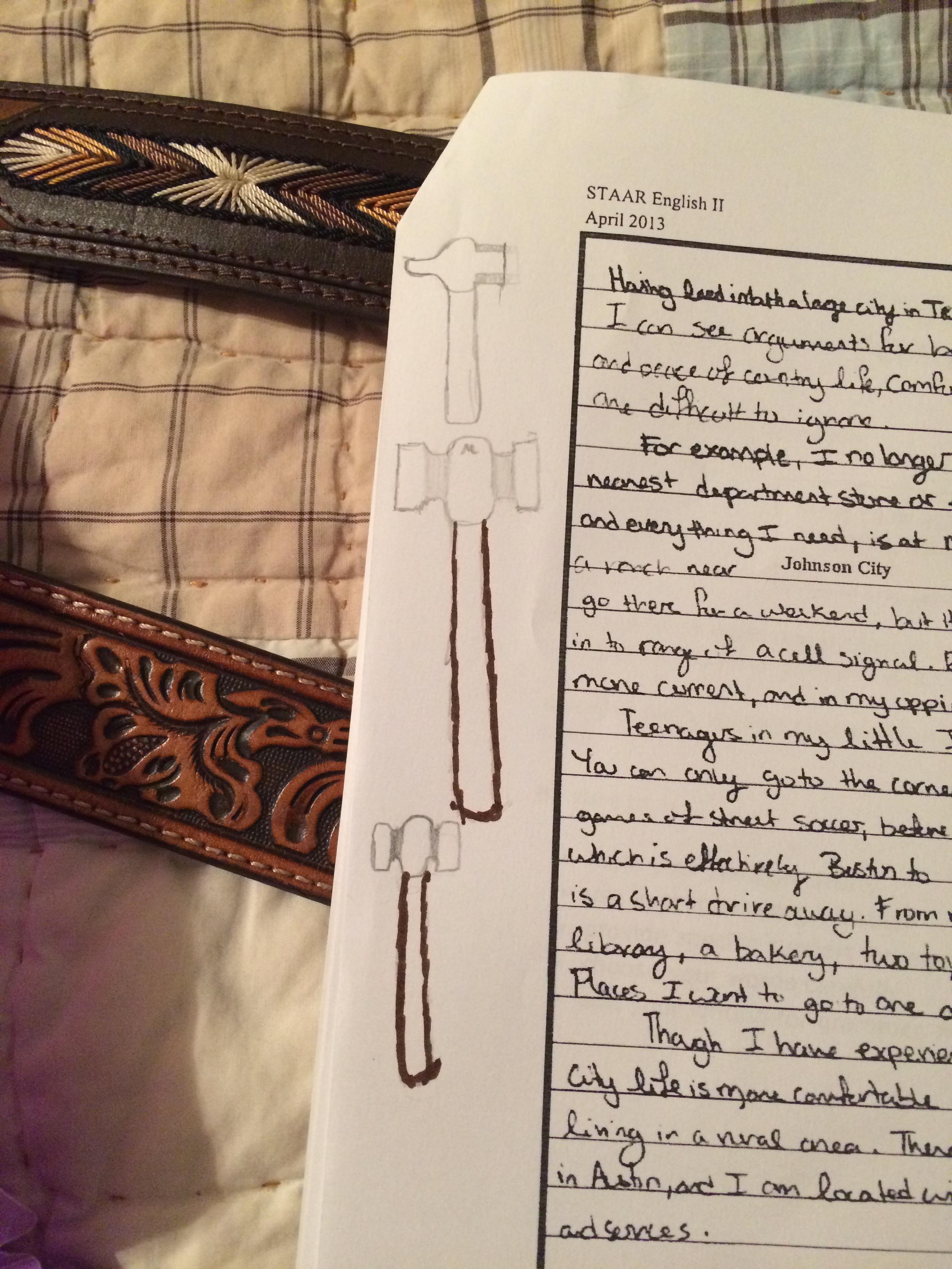

Mark Ling Posted October 4, 2018 Author Share Posted October 4, 2018 JLP- I was at school, and I realized, I reckon i do draw a little. Maybe not at times when I should be but I do draw some. Here is a page in a packet we got in english about the state wide writing test, I did some drawing. That's how most of my notes and papers look haha. I do like the cross pein style I drew and wanna try it out sometime soon. Thanks Steam boat! Littleblacksmith Link to comment Share on other sites More sharing options...
BryanL Posted October 4, 2018 Share Posted October 4, 2018 I second Frostys request. Beavers, we want a picture! Littleblacksmith, I do the same thing. I end up with projects sketched out on a post it at work. Link to comment Share on other sites More sharing options...

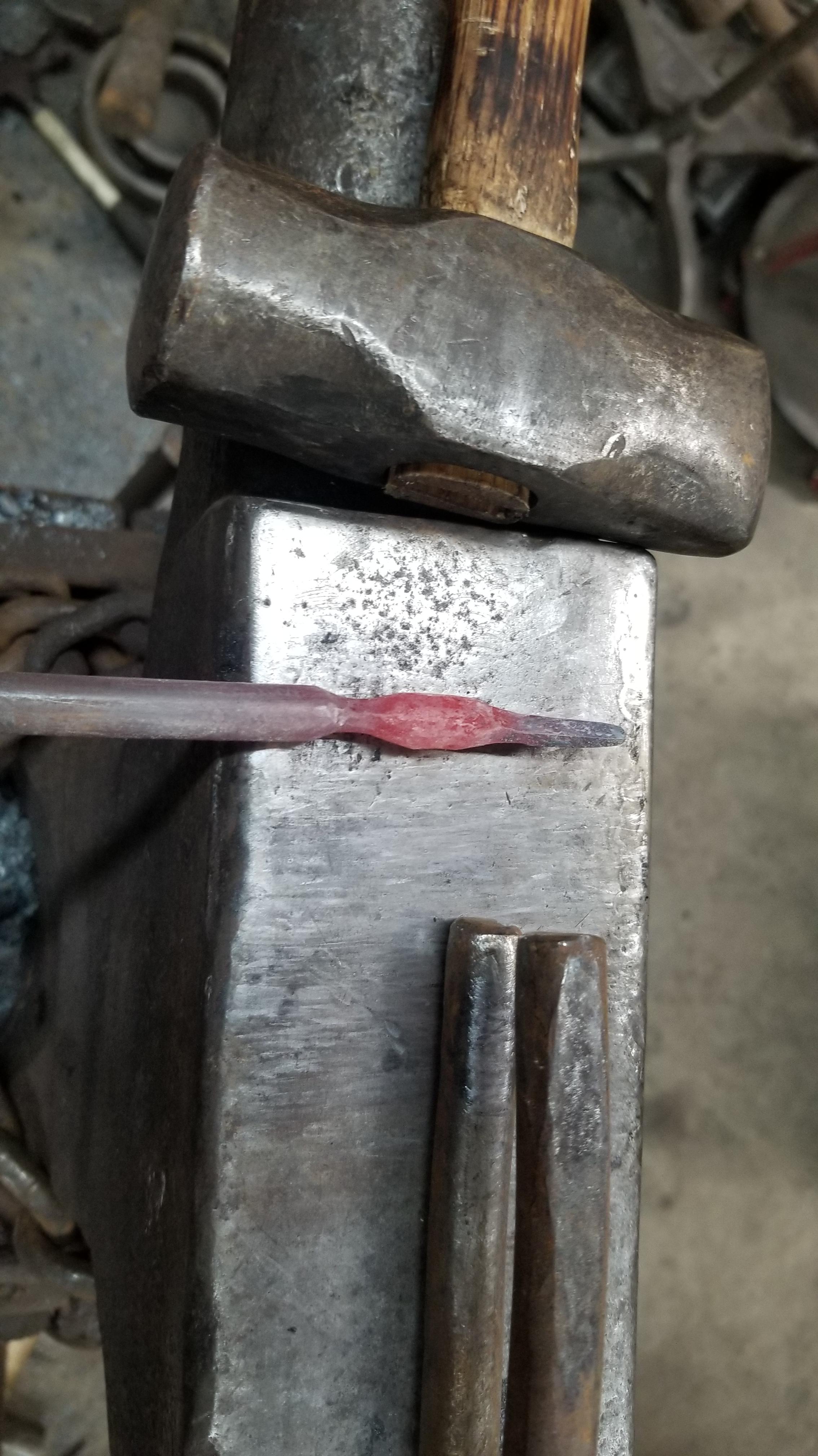

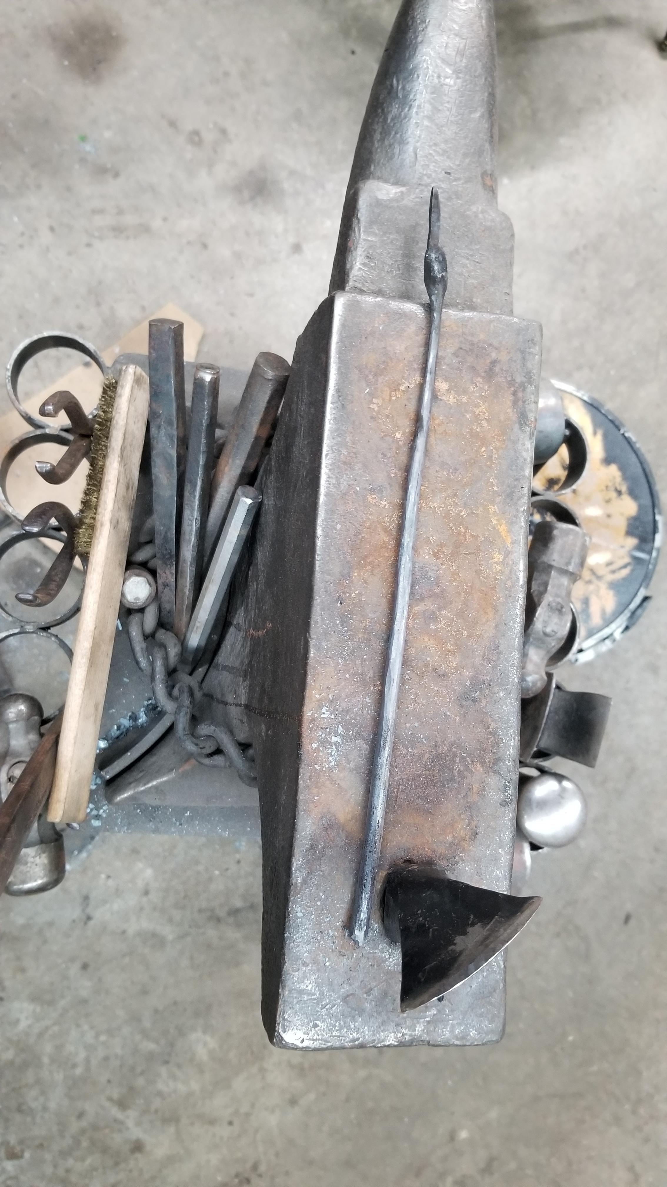

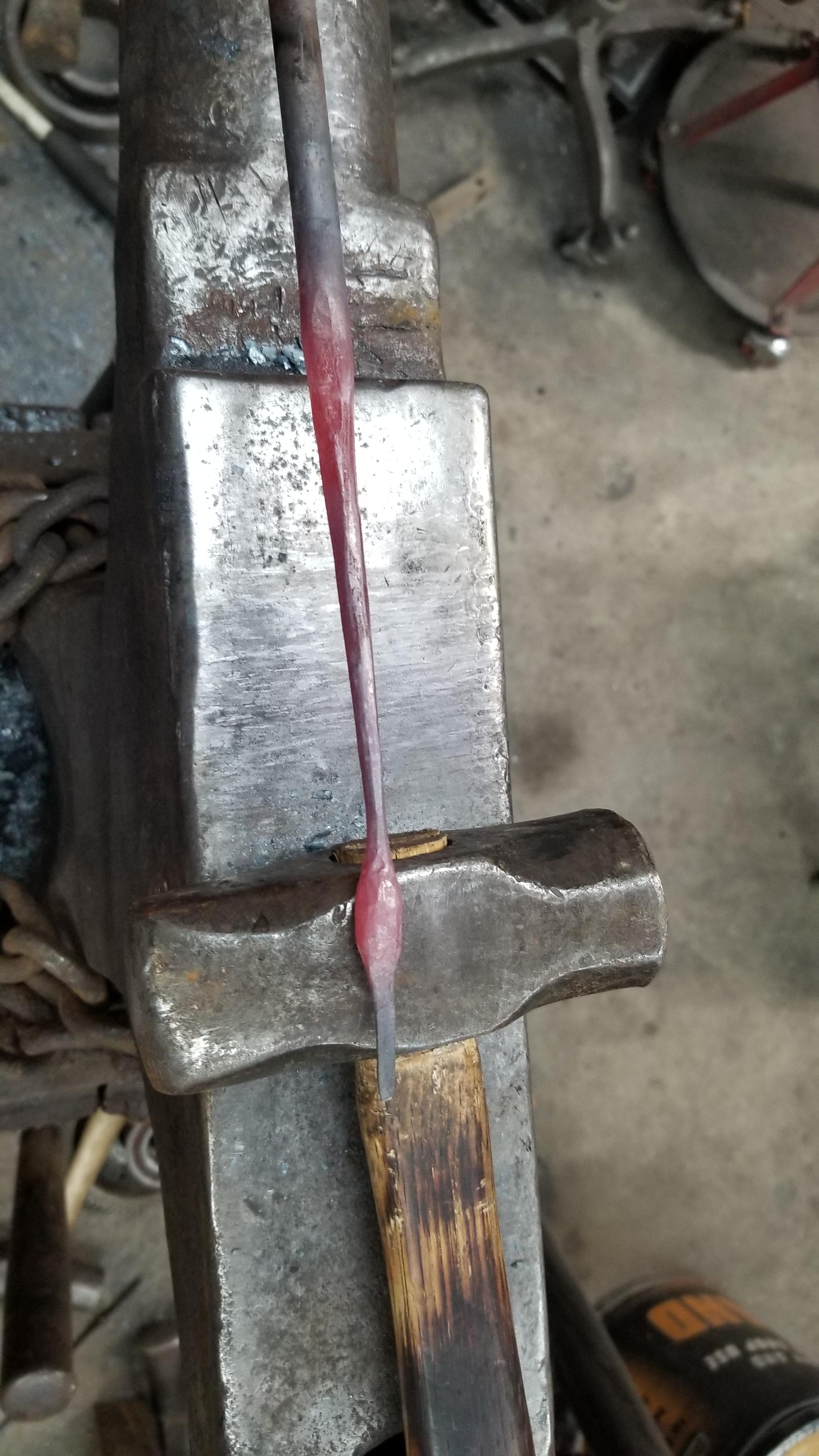

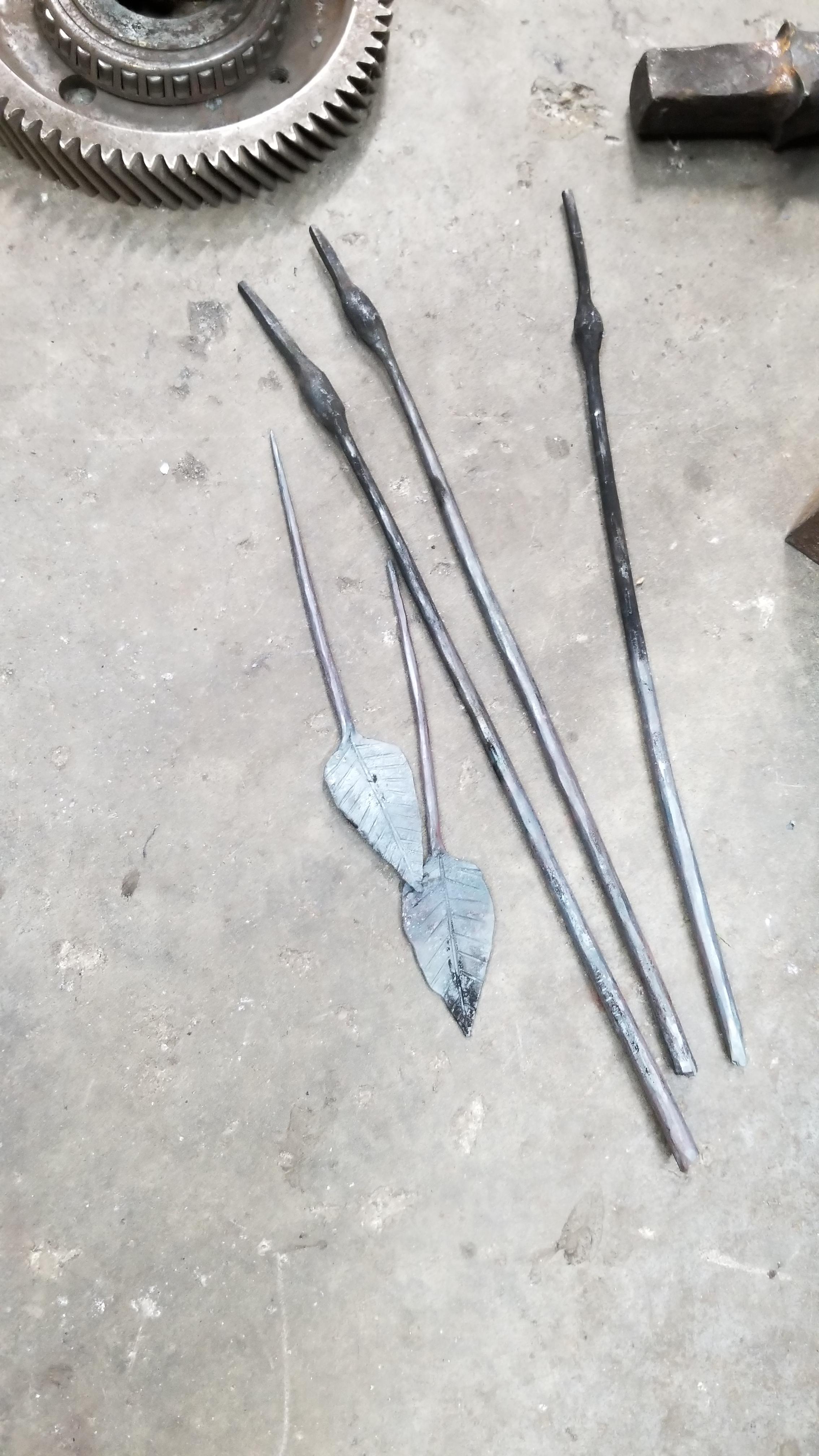

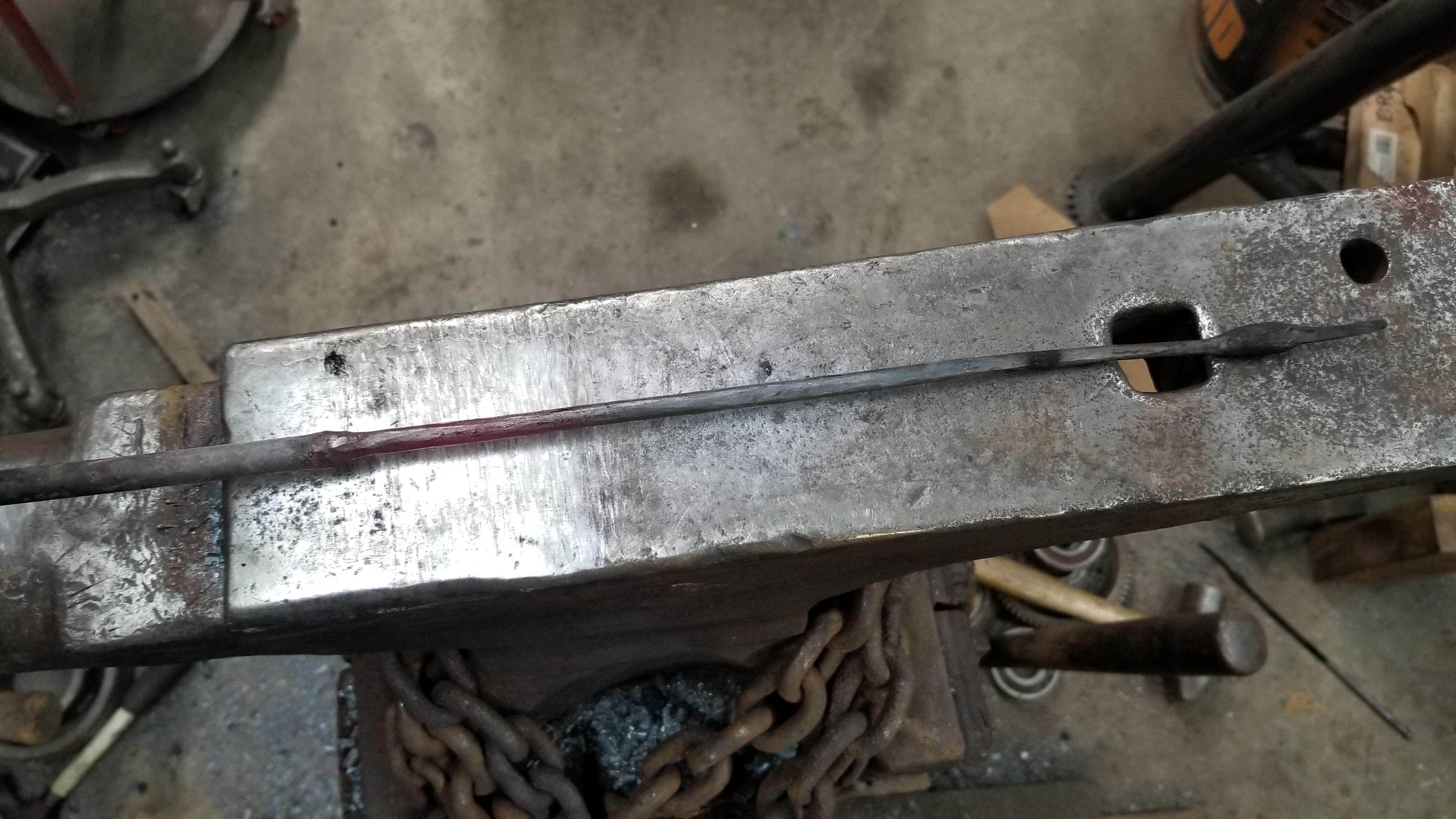

Daswulf Posted October 4, 2018 Share Posted October 4, 2018 Just didnt have the energy tonight. Got part of 3 roses done. , got the three stems. As you see I made the bud and shank first, then tapered down the stem. Next is more leaves then trimming and making thorns from the trimmings. Also cutting out the pedals. Lots of work. Link to comment Share on other sites More sharing options...

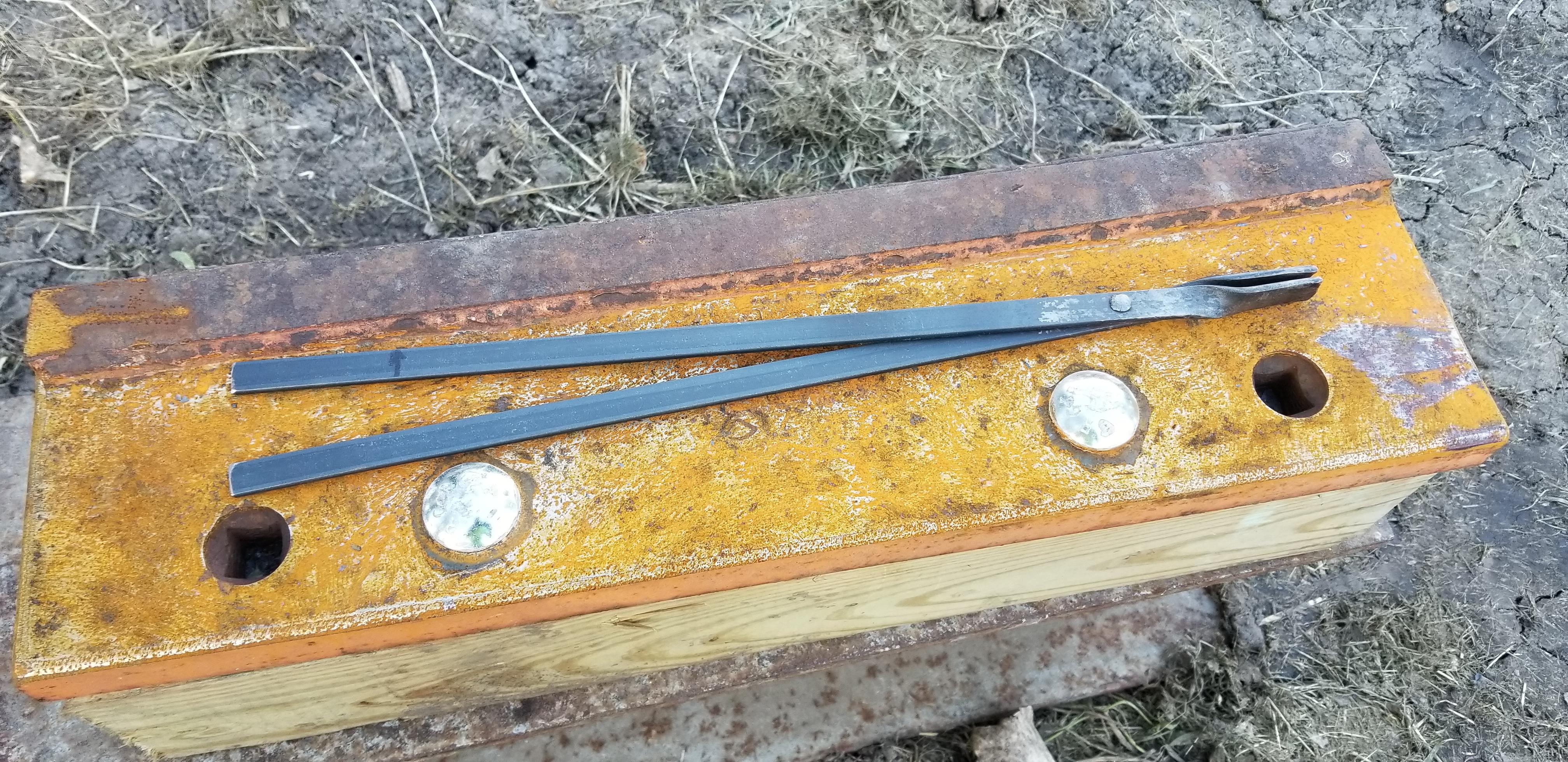

Beavers Posted October 4, 2018 Share Posted October 4, 2018 Here's my tongs. I had a tough time putting the groove in the jaws, and kinda knocked the alignment of them off a little. They do seem to do a pretty good job of holding onto 1/4" round stock. I want to do some more practicing bending and shaping things before I start on a bigger set of "real tongs". I just picked up a copy of the Complete Modern Blacksmith from the library. He has some practice drills that I want to run through before tackling any bigger projects. Also upgraded the anvil. It's a "blade saver". They use them on them on the big DOT snow plows in the high wear areas like the outside ends of the blades. It's a bout an inch thick and is much more solid than the I-beam. I'm planning on building a stand for it this weekend. The bolt holes are 3/4". I was thinking I might be able to use them as hardie holes. Link to comment Share on other sites More sharing options...
JHCC Posted October 4, 2018 Share Posted October 4, 2018 Sounds like you're on the right track. Make sure you mount your anvil plate vertically, to get the greatest mass underneath the hammer blow. If you haven't seen the thread on improvised anvils, check it out: Link to comment Share on other sites More sharing options...
Beavers Posted October 4, 2018 Share Posted October 4, 2018 Thanks JHCC. I have looked that post and found a lot of good info there. With my plate being only an inch thick it seemed pretty thin to mount vertically. Would you still suggest mounting it on end? Now that I think about it...I probably won't be forging anything thicker than 1/2" for a while. An inch wide plate would give me plenty of working surface right? Link to comment Share on other sites More sharing options...
JHCC Posted October 4, 2018 Share Posted October 4, 2018 Can’t hurt to try. Report back here on your results. Link to comment Share on other sites More sharing options...
Daswulf Posted October 4, 2018 Share Posted October 4, 2018 You can use it either way, you got the whole thing there, get your moneys worth. Yes, you could use those holes as hardy holes. Make a hardy and some other hardy tools to fit. When/ if you get another anvil you can just make spacers to still use them if the hardy hole is bigger. Link to comment Share on other sites More sharing options...
ThomasPowers Posted October 4, 2018 Share Posted October 4, 2018 I've managed to snag a 50# chunk with 1" bolt holes for the more common 1" shank hardy tools. NOT worth trying to expand those to 1" that stuff does NOT like to be abrasively worked at all! Link to comment Share on other sites More sharing options...
