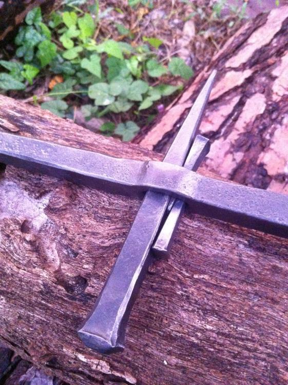

Mark Ling Posted September 27, 2018 Author Share Posted September 27, 2018 Haha thank you Mr. Powers I was going to post a similar response about bails and bales until I saw you had done the job for me did something a little different last Sunday. Forged this cross, it's been an Idea of mine for a while and finally gave it a try. the larger "spike" is from a spike harrow, which it actually turned out to be wrought iron. I punched and drifted the hole and made a similar spike out of 1/2" HR mild steel. I drifted the hole slightly undersized on purpose, and so I drove the middle arm in, and then secured it also with two wedges. Littleblacksmith Quote Link to comment Share on other sites More sharing options...
Mudman Posted September 27, 2018 Share Posted September 27, 2018 nice work! I like things with wedges. =) Quote Link to comment Share on other sites More sharing options...
Daswulf Posted September 27, 2018 Share Posted September 27, 2018 Mark, I have been meaning to do something like this. My idea was to get one large nail and two equally smaller and with the head on either side wedge them together on the smaller end in the mortis. Probably will have to make the nails as I cant find similar stuff. The basic idea... Quote Link to comment Share on other sites More sharing options...
Mark Ling Posted September 27, 2018 Author Share Posted September 27, 2018 Thanks mud man! Oh das I really like that idea alot. Littleblacksmith Quote Link to comment Share on other sites More sharing options...

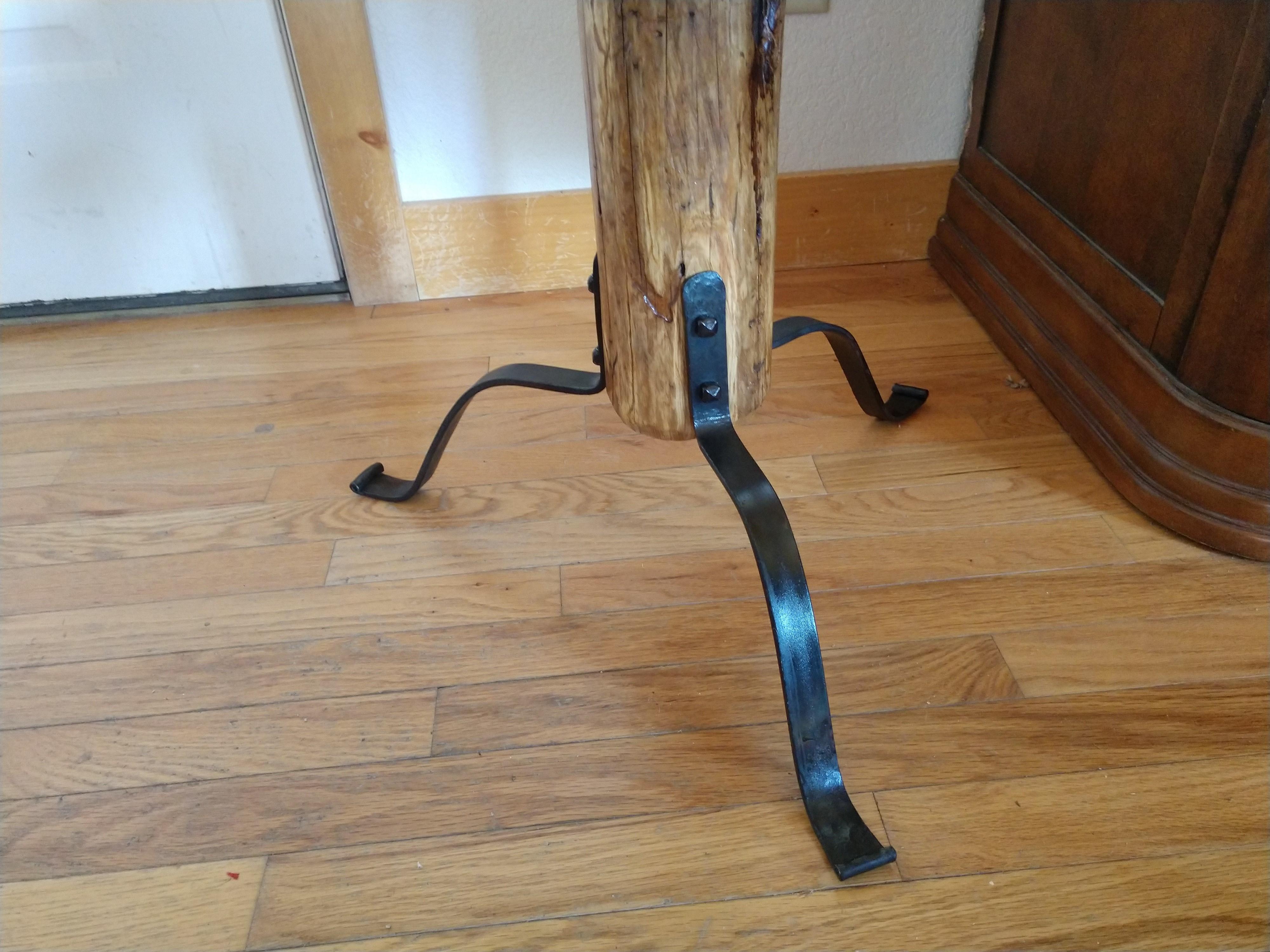

gmbobnick Posted September 27, 2018 Share Posted September 27, 2018 Completed my first piece of furniture since I started this blacksmith hobby over a year ago. I immediately gave it to a friend who gave me the anvil which really got me going. The anvil came with a farm he bought. He is going to put the coat rack in his new real estate office. Quote Link to comment Share on other sites More sharing options...
ThomasPowers Posted September 27, 2018 Share Posted September 27, 2018 I've also used 3 nails in a chi rho; for the symbolism. Quote Link to comment Share on other sites More sharing options...

MotoMike Posted September 27, 2018 Share Posted September 27, 2018 GBiker, looks very nice. waiting to see the finished product with scales. Bobnick, coat rack looks robust. nice job. Das, great scorpion. your monsters give me the willys. I have found that my gallon pain can is lacking in depth for some of the things I want to quench. So today I wandered over to the scrap yard. since I'm with cane and amulatorily challaned, I took my two wheel cart. I was quite a site. but I hauled 50 pounds of steel including a few coil spring, a rail plate and about 4 foot of 3inch id fairly heavy walled pipe. Cut the pipe and dressed it in prep for making a deeper quench tank. The pipe even came with a knurled aluminum cap for some purpose unknown to me. her it is ready to be welded to the plate. Quote Link to comment Share on other sites More sharing options...
