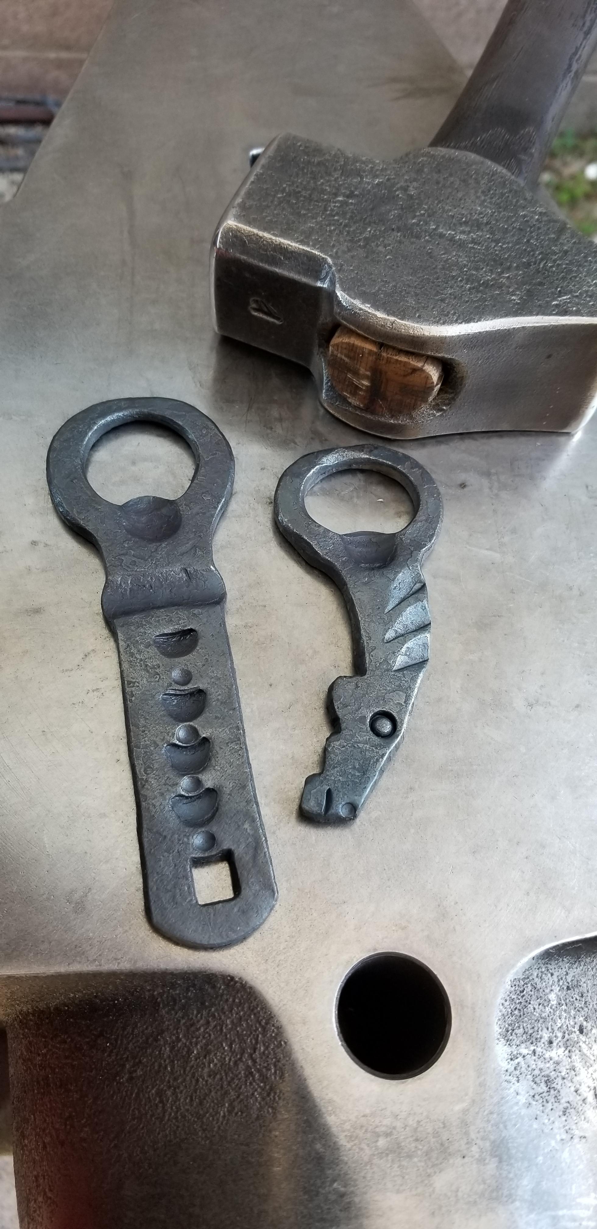

Mudman Posted September 19, 2018 Share Posted September 19, 2018 Quote Link to comment Share on other sites More sharing options...
Daswulf Posted September 19, 2018 Share Posted September 19, 2018 Very nice Mud. I made more "junk" for the freaky fair. The snakes tongue doesn't look quite as big in person. Quote Link to comment Share on other sites More sharing options...
ausfire Posted September 19, 2018 Share Posted September 19, 2018 Looks like a bit of (very) flattened threaded rod for the snake there, Das. I have often been asked about forked tongues on the snakes. What is holding the copper (?) in place? And nice openers, Mudman. Clean design. Well done. Quote Link to comment Share on other sites More sharing options...
Daswulf Posted September 19, 2018 Share Posted September 19, 2018 Yeah this snake was well abused into shape haha. I need more practice with these. The mouth was cut open with a hacksaw and once all you're done put the tongue in the mouth and tap it shut. Quote Link to comment Share on other sites More sharing options...
Steamboat Posted September 19, 2018 Share Posted September 19, 2018 Mudman, nice openers. The equine model should be an especially popular item. Das and Ausfire, since you've both been delving into the herpetological branch of blacksmithing, have either of you considered creating some visual metaphors or visual puns in steel of well-known things or idioms like "snake oil," "snake in the grass," "snake eyes," "lounge lizard," "toad in the hole," etc.? Might be kind of fun. Al (Steamboat) Quote Link to comment Share on other sites More sharing options...

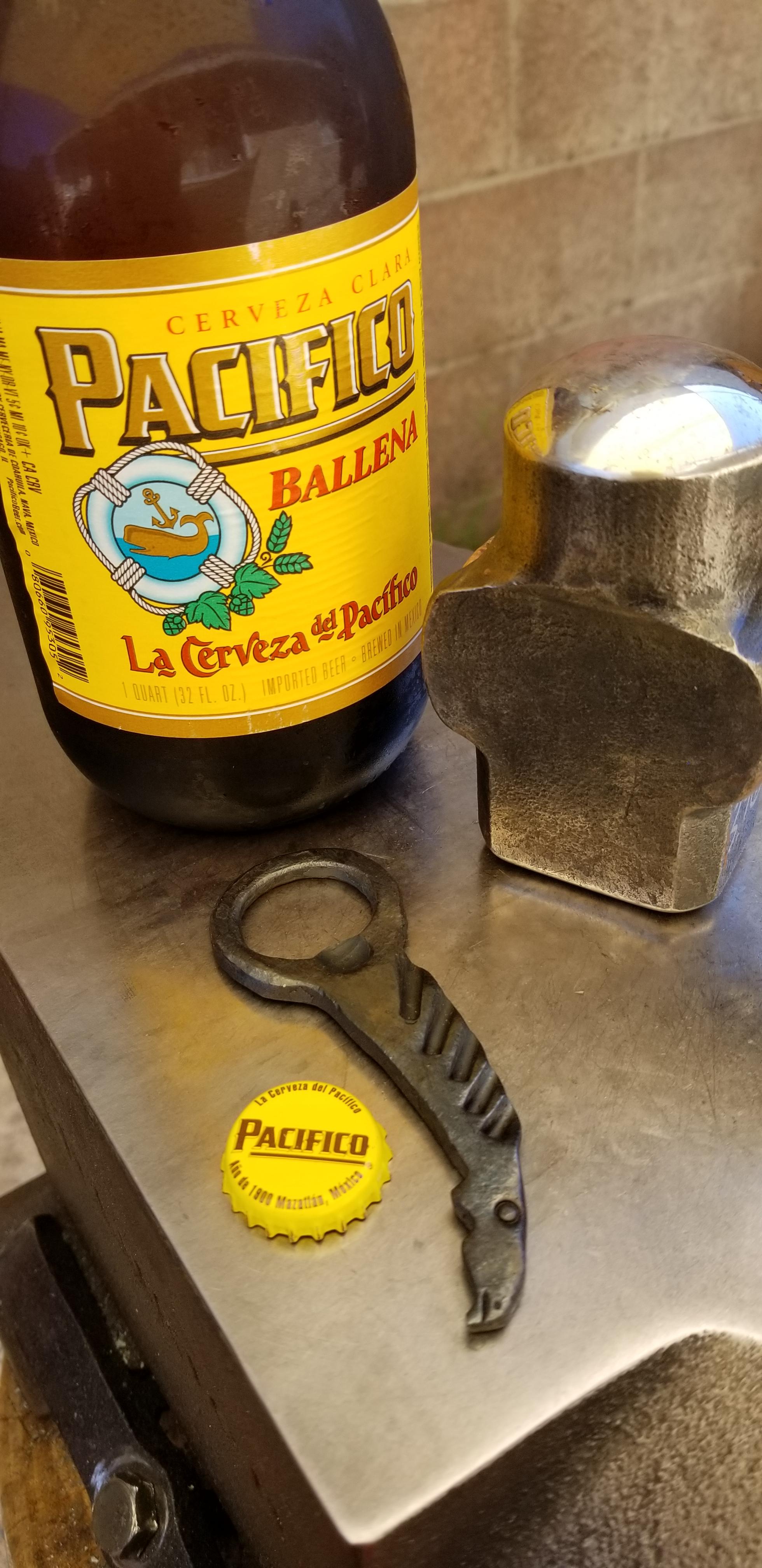

Mudman Posted September 20, 2018 Share Posted September 20, 2018 Thanks fellas. More bottle opener. Trying to refine things, and get smoother at it. Quote Link to comment Share on other sites More sharing options...
Ranchmanben Posted September 20, 2018 Share Posted September 20, 2018 2 hours ago, Mudman said: Thanks fellas. More bottle opener. Trying to refine things, and get smoother at it. I love scale free, smooth forgings. That one is both. Great job. Quote Link to comment Share on other sites More sharing options...
Mudman Posted September 20, 2018 Share Posted September 20, 2018 Thanks ranchmanben, did a lot of brushing. Still not satisfied with the finish though. I want it cleaner haha. Quote Link to comment Share on other sites More sharing options...
Ranchmanben Posted September 20, 2018 Share Posted September 20, 2018 I know the feeling and the desire to have perfectly smooth forgings. I don’t know if you do it but I recently learned to only use your block brush in one direction. That helped me some and you can also burn scale off with a torch when you really really want to be particular Quote Link to comment Share on other sites More sharing options...
Irondragon Forge ClayWorks Posted September 20, 2018 Share Posted September 20, 2018 I haven't tried it but have heard that dropping small parts at black heat in vinegar will remove the scale. Quote Link to comment Share on other sites More sharing options...
Ranchmanben Posted September 20, 2018 Share Posted September 20, 2018 I’ve left a few parts and hammer heads in vinegar over night and it certianly removes scale but it also reveals pockmarks in the metals where the scale has been hammered into it. The lesson I’ve learned is to brush loose scale off when you get to the anvil, ideally with the material hanging in open air, and vigorously brush before it goes back into the fire. It gets to be a habit. In my experience, scale makes more scale. If you start removing it at the beginning of a forging you don’t end up with those stubborn bits of scale that won’t come off with a jack hammer. Quote Link to comment Share on other sites More sharing options...
Daswulf Posted September 20, 2018 Share Posted September 20, 2018 1 hour ago, Irondragon Forge & Clay said: I haven't tried it but have heard that dropping small parts at black heat in vinegar will remove the scale. On rare occasion with small known mild steel pieces i have quenched them quickly in water to remove some scale. ..... Quote Link to comment Share on other sites More sharing options...
Ranchmanben Posted September 20, 2018 Share Posted September 20, 2018 I do that too Das. I will also sometimes dunk my brush before I use it. It’s a farrier trick that’s surprisingly effective. Quote Link to comment Share on other sites More sharing options...
Mudman Posted September 20, 2018 Share Posted September 20, 2018 I'll try the vinegar dunk. Part of me, is chasing a better finish- more than I am trying to get better. See some folks, with finishes that look like it was all done in one heat. They say they brush a lot, while I'm certainly getting better at it, still not anywhere near their work. I'm brushing like my life depends on it. fullered areas give me the most trouble. If only my rage could scare off the scale. Das, those snakes look like they would make cool ring/pin thingies (forget the name) that people used on coats in the olden days. Quote Link to comment Share on other sites More sharing options...
