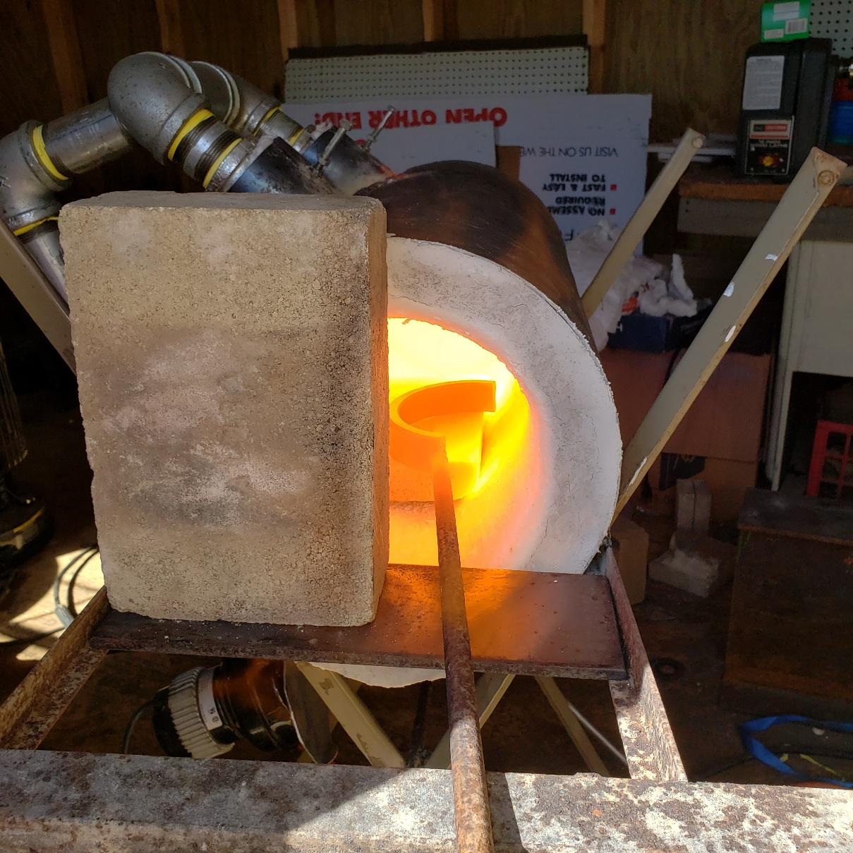

The tank- that part can be completely up to you. There's many a different forge design. I made mine from an old inline water pressure tank from an old farmhouse. I did pretty much what you're talking about- I cut one end off, leaving the back of the tube solid... and then insulated and lined it. I then later cut it in half, and added a couple flat pieces over the opening to help retain just a bit more heat. The problem with it is that ALL of my exhaust comes out the front.
This picture is before dropping down to one burner, and cutting my shell in half- between the burners.
