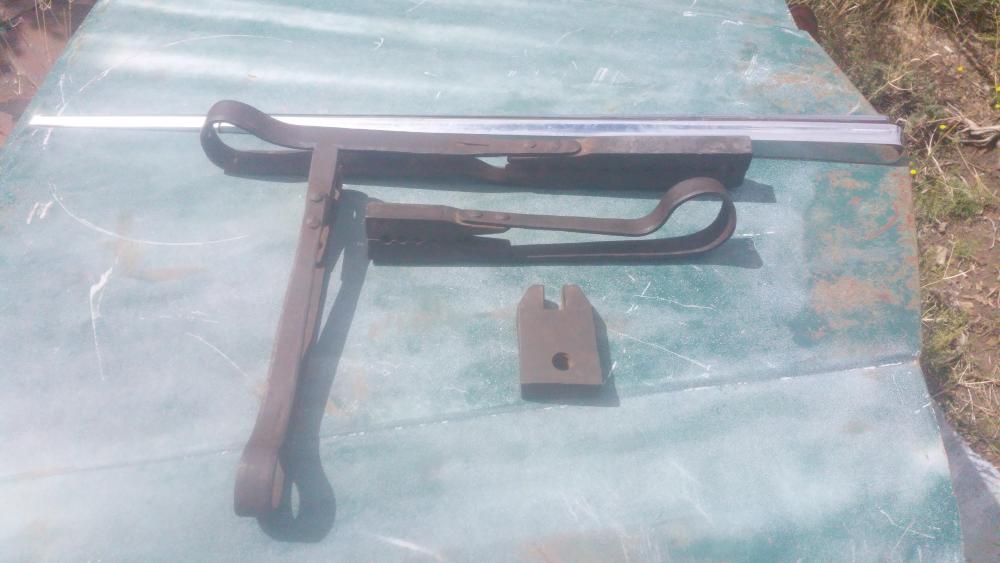

What Latticino showed plus this clamped in your vice. This is being made.
Some hints for this set of tools. Make the opening slightly larger than the steel size. In your case, make it slightly wider than 1-1/4".
The angle cuts are needed. They allow you to get into tighter curves. It's more important for smaller scrolls.
For the anvil tool, I make each end a different size.
Grader blade is great material for these tools.
I make these sets for different size stock.
Take a long heat and make small bends for good control.
