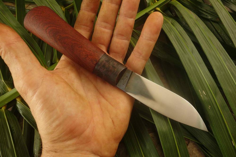

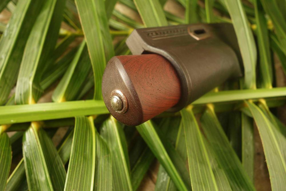

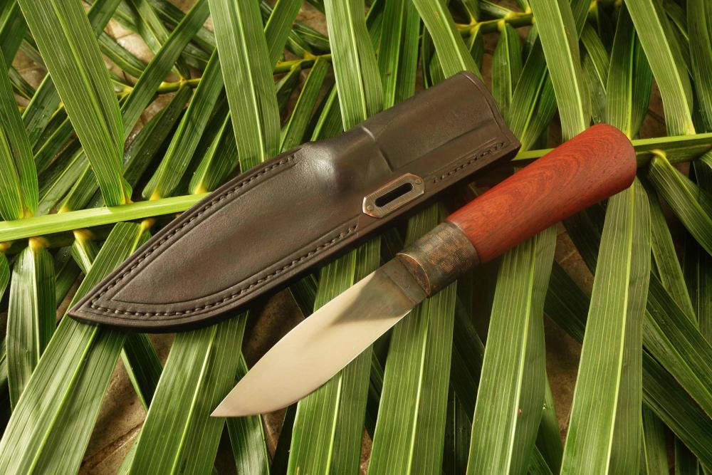

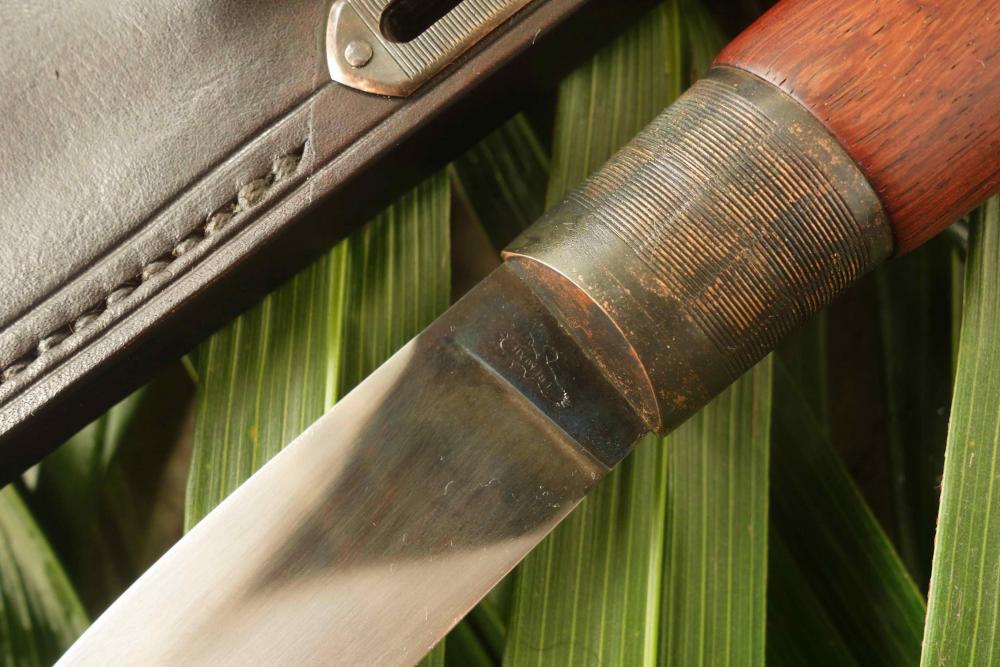

Allround user with padouk, copper ferrule and a blade made from 1.2419.05(130WCrV5)
This cold work tool steel is a special alloy coming from my old friend and colleague Achim Wirtz
He described it as the 07 on steroids.That description fits just perfect....

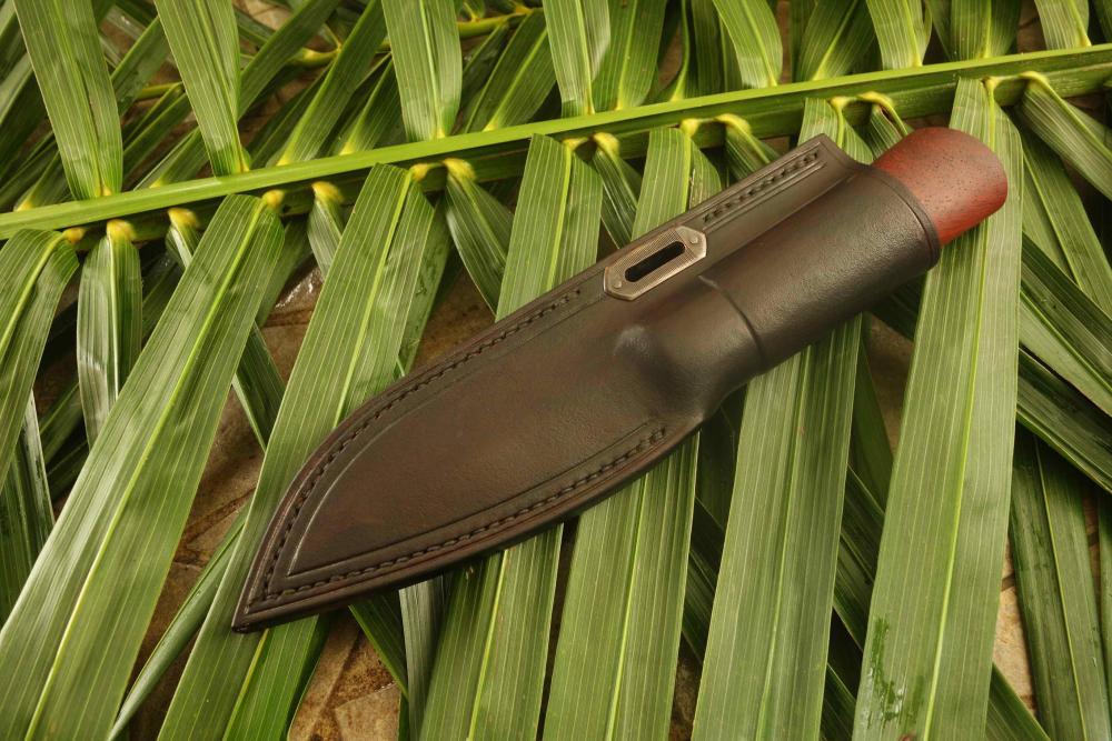

Tang is riveted on he butt and the sheath is water buffalo leather and copper for the fittings.
Cheers

Thanks JHCC, appreciate Your comment!:)
SLAG: ....first Thanks for Your comment.....now Padouk:

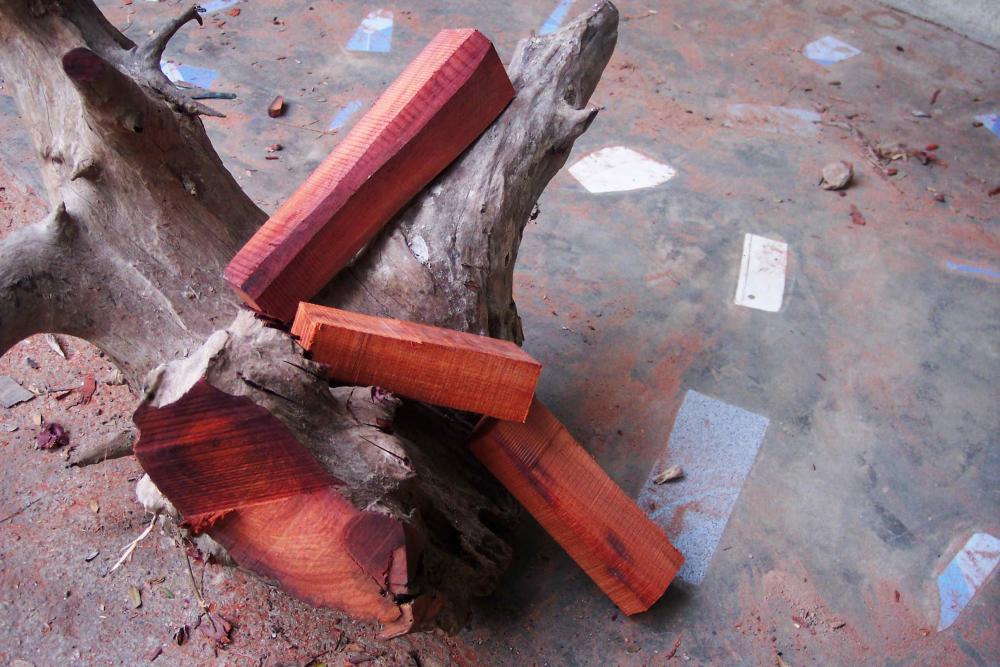

Well, what can I say:blink:....I used Padouk for  20 years of knifemaking(since I live in Thailand) on dozens of knife handles and I cannot remember a single piece
that caused any problems at all.
Padouk is one of the most reliable, enduring, forgiving, strong materials I know....in fact it is so good that I use it besides Ceylon iron wood the most.
You have to consider a few facts, when judging Padouk:
there are the two main types in the Padouk family: Pterocarpus macrocarpus and Pterocarpus Indicus.The first comes out red and the other more golden brown.The Macrocarpus
is the harder, but Indicus is also excellent to work with.
it comes mainly from two geografic sources, Africa and Asia.The Asian Padouk is significantly harder than African Padouk.
Now how it is on the market....there is still industrial collected and  treated Padouk means fast dried in shorter time amount(never good at all) and worst of all politically polluted.
My Padouk wood is collected by myself in the jungle, the bushes and the fields. When I find them(if I am lucky) the stem is mostly gone only the root is remaining.
It is said that the root parts are harder than the stem parts, I can confirm that....(besides it is impossible to get Padouk root comercially)
 So if I use Padouk it is Asian and from the root.And for me  important above all, it is politically
clean, the tree is dead and gone long time ago.....no tree has to fall for my knives and I never will be a vulture of dirty logging, I never use wood that I didnt found by myself
because anyone can buy, for me and my knifes there is no good spirit in buying comercial tropical woods
(no offence to anybody buying, it is everyones own thing how to deal with consciousness)....
last but not least harvested by myself it is spiritually good for me.
Back to Your Padouk.....it is known that water stains can occur on nearly every wood when, lacking on maintenance...dried out, unoiled....
(and no knife is supposed to be left out there in the rain)....just hypothetically thinking, not saying You did....
maybe it was a piece of commercially fast dried African Padouk or just a bad piece at all  resulting in the same bad result and quality....
after all these years of knifemaking experience I say, Padouk is my favourite wood .
Your contribution is very appreciated, SLAG
Cheers
