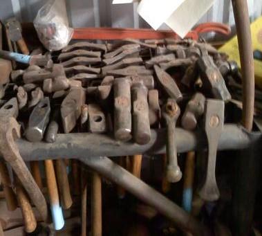

JeepinBoon Posted July 8, 2020 Share Posted July 8, 2020 Hello all, first post. I have a 79# Hay Budden anvil that, in my opinion, is near mint. So far, I have only hammered out business card holders and hat hangers from silver forks on it. Last weekend, I got a Mouse Hole 148# with LOTS of wear. My main concern is damaging these anvils. My main question is.. Would you use a modern store bought hammer or a hand forged hammer on either anvil? My second question is.. If the hardened steel top layer of your anvil has smushed out and curled over the edge of your anvil, would you grind it flush to sides or let it break off as you work? I'm not going to *cough* restore *cough* an 1820-1830 M&H anvil unless the top delaminates. Then I got a forklift fork to stick on it. Link to comment Share on other sites More sharing options...
Chris Williams Posted July 8, 2020 Share Posted July 8, 2020 First, handmade versus store bought... That is too general of a question for the answer to be useful to you. For learning, any cross peen 1.5-2lbs is fine. You'll want to dress the edges -- check out the hammer forum for how. Use the mousehole until you are hitting what you intend to. As for those mushroomed edges, you need to dress those to remove the overhang and any cracks or splits before using so that you do not create projectiles from the shards when they do let go. They can cause you or anyone nearby serious damage! Link to comment Share on other sites More sharing options...

ThomasPowers Posted July 8, 2020 Share Posted July 8, 2020 If you are worried about dinging an anvil's face with a hammer you can draw the temper on ANY hammer head to make it softer than the anvil's face. (Remove handle; toss in oven, draw to an appropriate hardness, rehandle. As you don't need to reharden; the heat treat is quite simple and easy!) I have a couple of hammers that are softer than others; one was a commercial hammer that was in a factory that was bombed and is now dead soft, the other was a homemade hammer---probably from a truck axle. When I teach; I often "suggest" using these hammers to students who "hammer like lightening---never hitting the same place twice!" Hammers are easier to dress than anvil faces! Also properly dressed hammer faces tend to leave fewer dings even when you are in the learning stages. I am a firm believer in using old tools. The Mousehole is not a rarity needing to be cherished in a Museum. Use it; don't abuse it. If you must reface it read up on the Gunther Schuler method of anvil repair---pretty much the gold standard and well proven in! Link to comment Share on other sites More sharing options...
JeepinBoon Posted July 8, 2020 Author Share Posted July 8, 2020 Thank you all for your input. As far as condition, the Hay Budden rebounds 8.5"-9" with a 1" steel ball dropped from 10" and the Mouse Hole rebounds 7"-7.5" from 10". The HB has an ear piercing ring and the MH goes "thunk-thunk" on the face and horn. I hope it wasn't in a fire. I know hit the work, not the anvil. I was going to stay away from the thin/missing face and only if it delaminated at least 50% to put on a forklift fork. I've read Gunthers method as well as several others before registering here. The reason I asked about hammers was that I have chipped several hammers driving hardened pins and teeth which tells me that the hammer is so hard it would chip rather than deform. I'll grind the mushroomed edge off and hammer on it as-is. I have a home machine shop so I can mill off the top and weld hardface or fork. Link to comment Share on other sites More sharing options...
