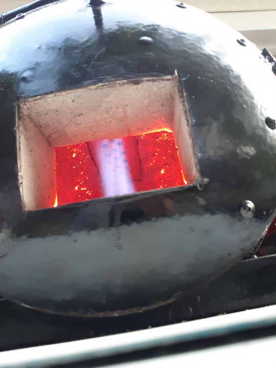

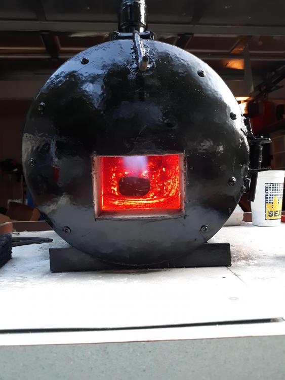

Hey community,
I often read in here that the size of the gas orfice should be 1 mm in diameter or even bigger in blown burners. Doesnt this contradicts with the whole "blown burners are more efficient" theme?
Furthermore its often adviced to use larger gas orfices when experiencing burner problems like not getting up to temperature.
I run my blown ribbon burner with a 0,6 mm mig tip on about 0,2 bar (propane) for general forging. I encountered backfire problems due to overheating of the burner block (hope to solve this soon and coat it with itc100 as adviced here) but besides that it runs perfectly smooth.
So where does that "bigger is better" attitude come from?
Dont get this as an offend. Iam just curious.
Tim

I first built the ribbon burner with a gas injector made from a copper tube with 3 1mm holes drilled in it. Iam using a regulator with a needle valve. As I first fired the burner it worked well. But I noticed that the gauge on the outlet side of the regulator shows 0,0 bar regardless of how far i cranked it up. I reduced the 3 holes to just 1. Just a slightly difference on the gauge.
I switches to the 0,6 mm mig tip it was fine.
The thing is when I use a big diameter gas orfice that there is not really back pressure building up. So you cant really judge how efficient your burner is running. When using the 0,6 mm tip i can compare it to my venturi burner which also uses the same diameter tip.

Tim in Saxony: You're making a common mistake, you have been lead to believe pressure actually means something as far as forge performance is concerned. It doesn't. The only real use a gauge serves on a forge furnace at our level is to make it easy to duplicate specific temperatures.
If your gauge doesn't read at any setting of the regulator it's probably defective. The gauge on mine reads when on a weed burner which uses propane many times as fast as a forge burner. I'm betting your gauge is defective or something is blocking the inlet. Did you use thread TAPE when you installed it? If so that's probably the problem, a tiny shred of tape plugging something in the regulator. I highly recommend using gas rated thread paste SPARINGLY.
If anything is preventing your burner developing sufficient heat it is not having a proper fuel air ratio. When running a gun (blown) burner you can NOT just turn the gas up or down without adjusting the air flow. A gauge is useless UNLESS you have an air flow meter that is calibrated to the gas flow. You can buy this level control system but they are NOT cheap.
Your realistic alternative is to learn to read the burner's flames and sound and hand adjust every temperature change.
