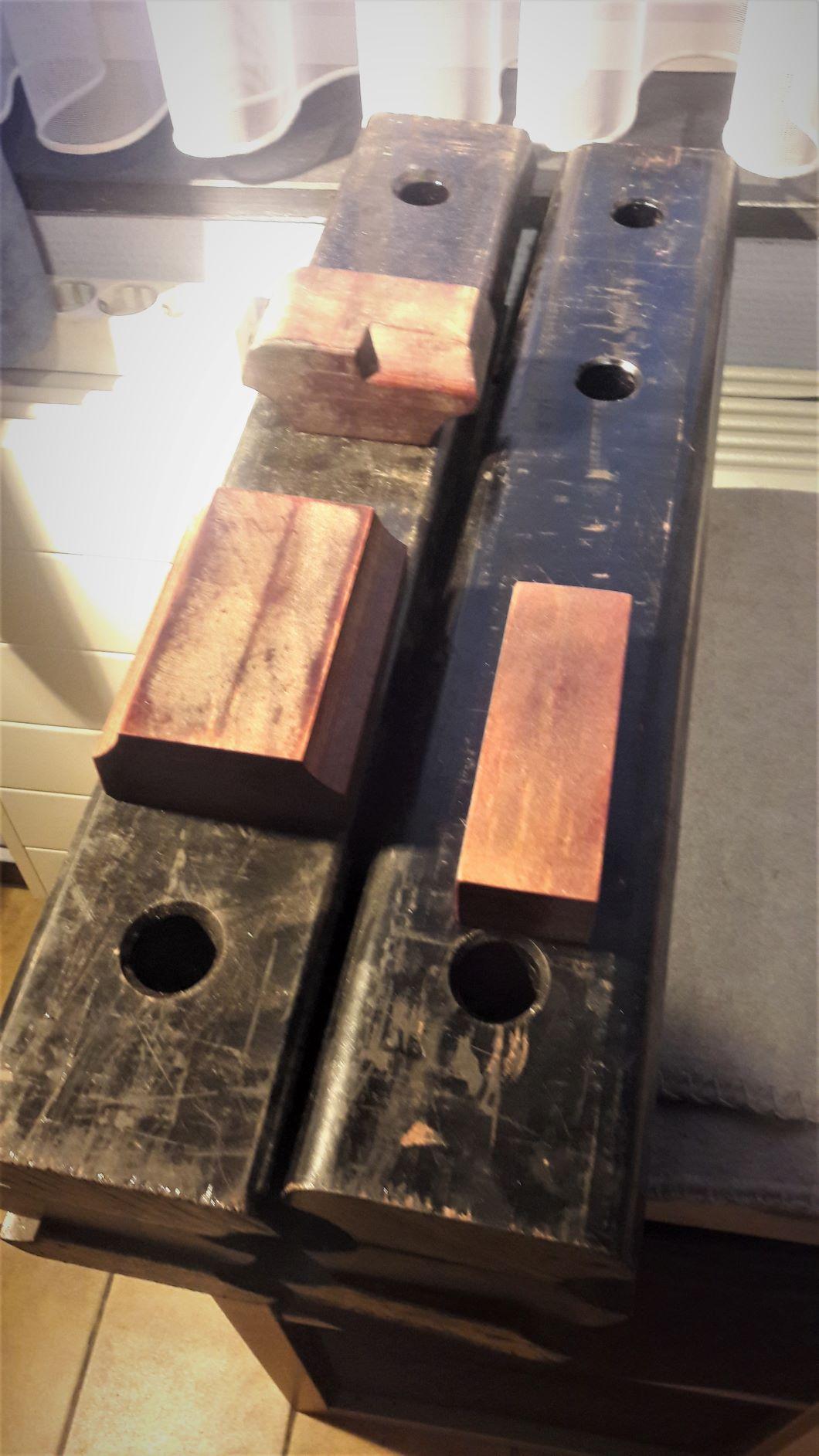

Hello Guys;   Warning; picture heavy !
As you know, I have quite a few friends in the railway company (I don't work there).
And I found some intresting material for knife handles, that is very reminescent of pakkawood or dymondwood.  They used to use it for connecting two sections of track together isolated electrically. They are huge chuncks of 2 foot long 4 inch by 2 inch blocks, painted black.
I cleaned one up, cut some blocks and fitted some knives with it, and I like the material. Doesn't stink like micarta, machines like micarta, and looks like wood, but is absolutely impervious to oil, water, temperature changes ... And the best part; they got tons of these, and they all need to be trown away because they are switching to some tougher synthetic electrically isolating thing (with is essentially a block white-greenish fibreglass, which is not fun to work with :-) ).
Anyway; pictures tell more. First is a stack of 6 of these plates; with some cut off parts and cleaned up sections.; then some details of the material under the black paint when cleaned, then some knife handles. enjoy & what do you think of this stuff ? It's obviously pakkewood or dymondwood of sorts, but with beech layers.

Wel actually We know how it was created. it's impregrated  beech laminates with clear epoxy under high pressure and temperature. Made in the UK somewhere; and they are called epoxy welding plates :-)
And when grinding them, they actually smells like epoxy; which is much more pleasant then working micarta. And it doesn't crumble or chip, but acts more like micarta. My mill eats it for breakfast.
