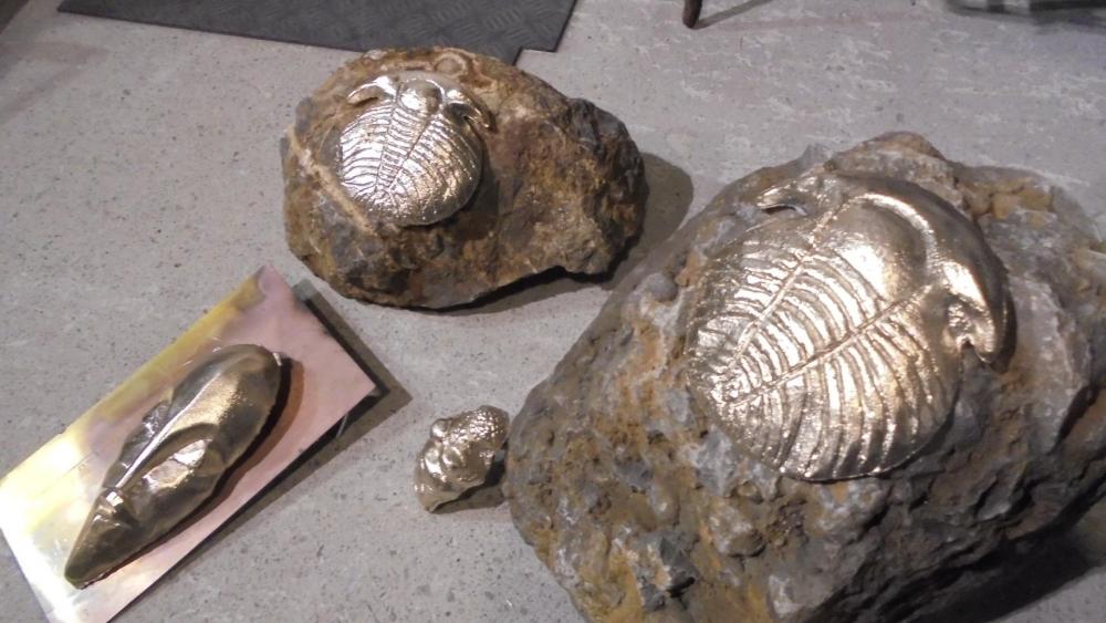

Frosty, thanks for loving the Trilobites. At this moment I mostly busy to replicate the existing models by giving workshops (Cast In’s :D) to friends how went home after finishing, with their own piece of bronze sculpture or device. The models already known like the heel axe, the Venus types, the ammonites, the masks, knuckle bones, fibulas, anvil types etc..

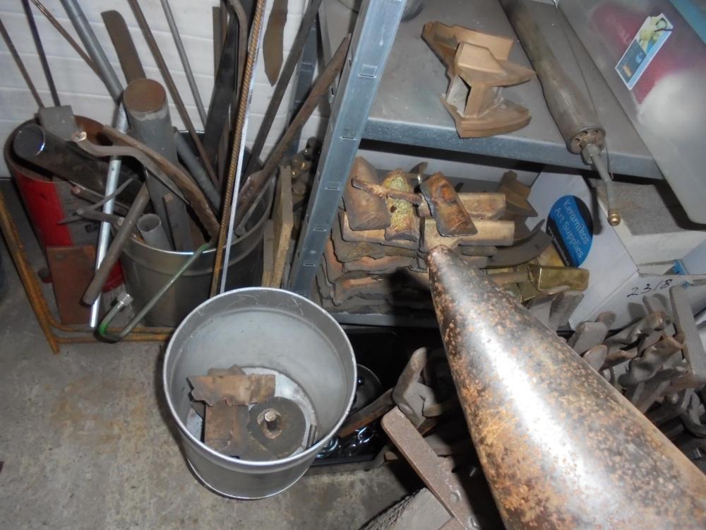

Also busy to build up a stock of ingots made from worn out molten bronze pump impellors to get a good source of pure material. Funny to realise that the impellors pump the excrement’s of thousands of people during their duty in the sewage treatment plant.
After finishing my actual scrap sculpture a steampunk shark submarine, I will go on with bronze casting of a face cast of my daughter Lisa.
