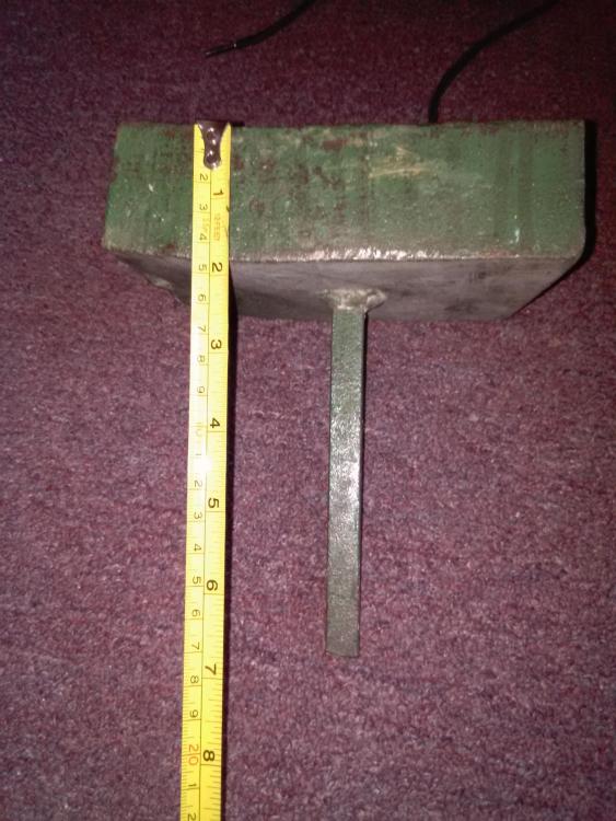

pnut Posted November 15, 2019 Share Posted November 15, 2019 (edited) This is the plate I use. It just so happens to be sitting near me. I also use it when I figure things out with clay as an anvil. Pnut Edited November 15, 2019 by pnut Link to comment Share on other sites More sharing options...

Les L Posted November 15, 2019 Share Posted November 15, 2019 Thomas, is that the right picture of a plate with two square holes you posted, or is my cell phone distorting it? Link to comment Share on other sites More sharing options...
ThomasPowers Posted November 15, 2019 Share Posted November 15, 2019 Well the internal holes are 1" sq the external are round, they are for using a carriage bolt like bolt; probably off a dozier, grader---dirt moving machinery. My hardy tools have quite long enough stems to engage in the square section of the holes. The picture is an old one that was done to show the hardys, the slab is is just extra. Link to comment Share on other sites More sharing options...
