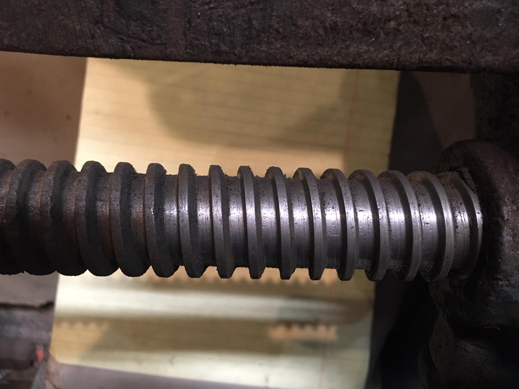

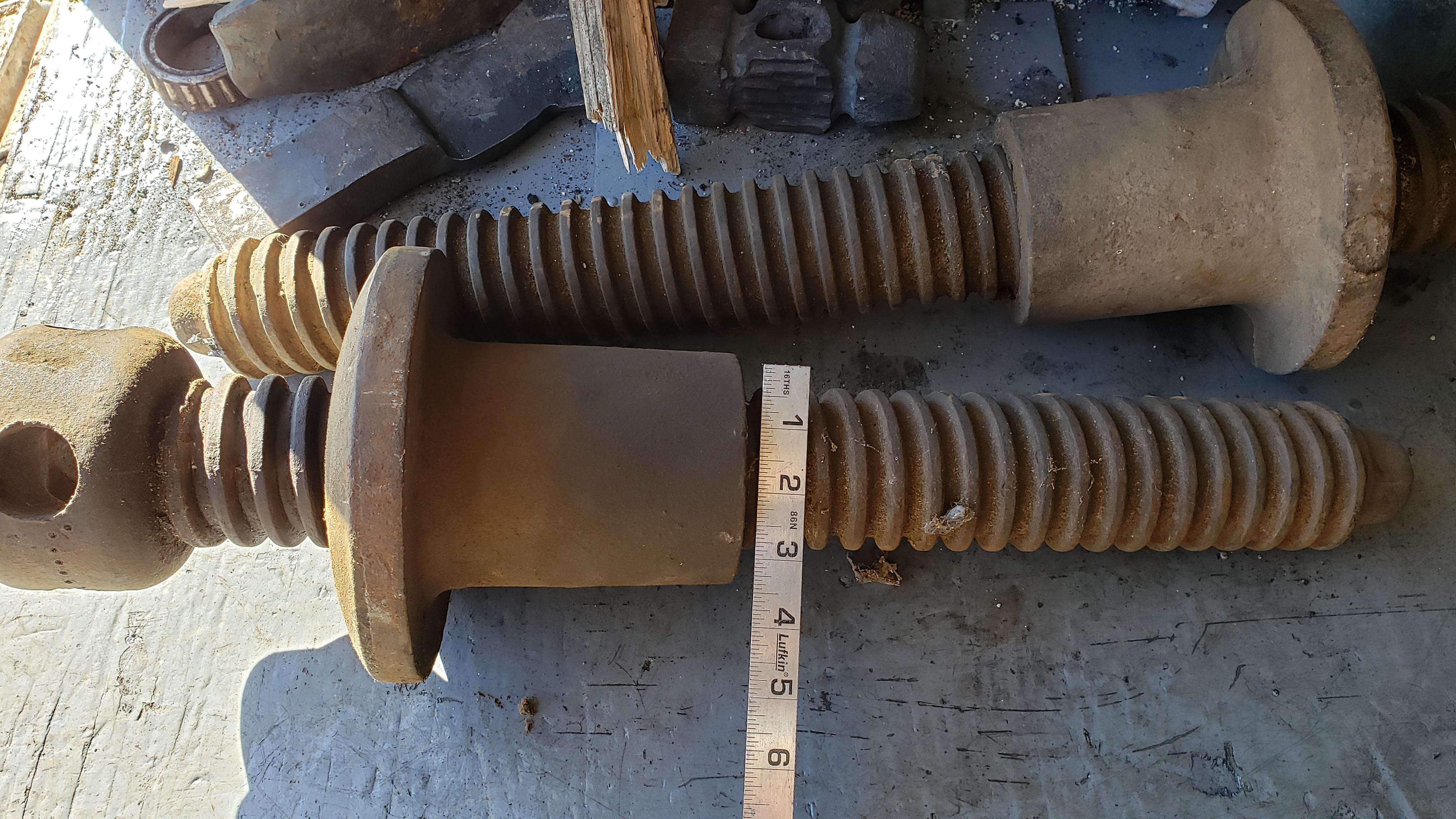

Judson Yaggy Posted November 1, 2019 Share Posted November 1, 2019 David, I have 2 #4 Fishers, and the threads are more complicated than the general consensus here believes. To my eye they have what looks like buttress rather than acme threads. Additionally the direction of the butterss is reversed on the top and bottom screws. Also, the diameter of the top screw is larger than the bottom screw, but they have the same lead. Photos below are of one of mine, top screw first. If you replace one screw it is important that it have the same lead as the original or the "timing" chain will drive the two screws out of alignment and the vise will bind. If yours is binding the first thing I would check is that the jaws are parallel and screws are indexed properly. Pull off the chain and you can adjust each screw independently, then reinstall the chain. I'm an hour and a half from Lyme, but if you want to come over this way some time to look at mine, feel free to drop me a line. Quote Link to comment Share on other sites More sharing options...

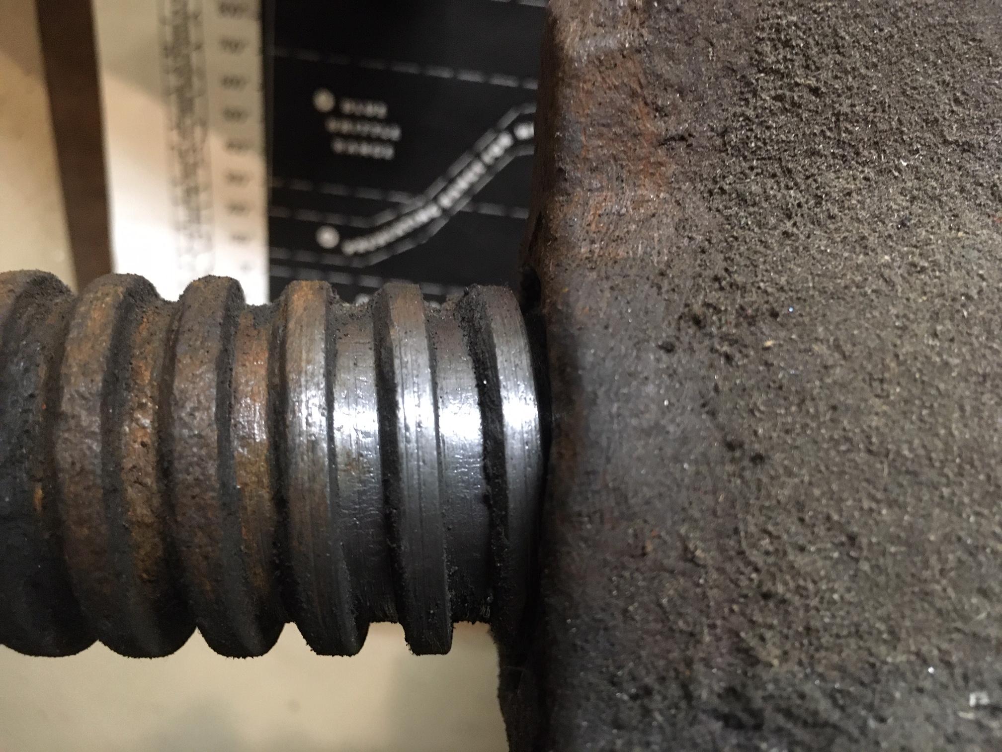

David Kahn Posted November 7, 2019 Author Share Posted November 7, 2019 Thanks very much Judson. That is very helpful. I took a more careful look at the vise, and you are correct that the threads have a "buttress" shape. Flat on the front, tapered on the back. But only the top screw. The bottom screw appears to be concentric, maybe just an acme thread? Is this type of buttress thread a standard thread shape, or was it something proprietary to Fisher? It looks like the pitch on both threads is somewhere around 2.5 TPI. If I could find a machine shop in New England somewhere that could recut the top screw and a matching nut, I would love to do that. Great point about pipe being the wrong material for a nut. Given that it only needs to be four or five inches long, drilling out a piece of bar stock might be the way to go. Lastly, do you know what the correct process is for removing and/or replacing the chain on these vises? Do you just torch heat the steel wrap on one of the links to open it and/or close it back up, or is there a trick? The original chain, which is quite worn, appears to have cast links, and the only replacement chain I could find uses stamped steel instead. Quote Link to comment Share on other sites More sharing options...
jlpservicesinc Posted November 7, 2019 Share Posted November 7, 2019 What are the threads like in the box? It the threads are worn in the vise. It will mean excelerated wear on the vise screw when replaced and binding as the screw and the threads have mated. If you really want to use this vise spending money on a threaded rod with the exact specs will be expensive unless you know someone who will do the work for low money. A buttress thread is just based on tool shape. as is acme as is square threads. As long as you can get the thread pitch correct you should be all set. With this said. My lathe will only go as low as 4tpi and wish I had the old box with 2tpi.. I looked into making a change gear to go to half speed but never had the need enough to really find exactly what I needed. There are 2 ways to do the chain. Walk it off or undo the screws and the chain will slacken.. It just comes apart when you are past a certain point and can swivel it out. I have a machinist friend who might do it for little coin.. What is the OD, ID (depth of thread) and exact thread count? I'll contact him and ask. Also what material for the screw thread? Quote Link to comment Share on other sites More sharing options...

Judson Yaggy Posted December 17, 2019 Share Posted December 17, 2019 On 11/7/2019 at 3:11 PM, ThomasPowers said: If the threads are not matching The exact shape of the thread does not have to match top to bottom, but the travel per revolution does. Quote Link to comment Share on other sites More sharing options...
ThomasPowers Posted December 17, 2019 Share Posted December 17, 2019 Correct; I was thinking TPI. Quote Link to comment Share on other sites More sharing options...

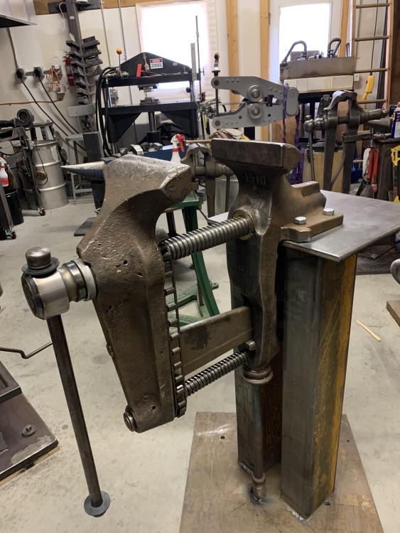

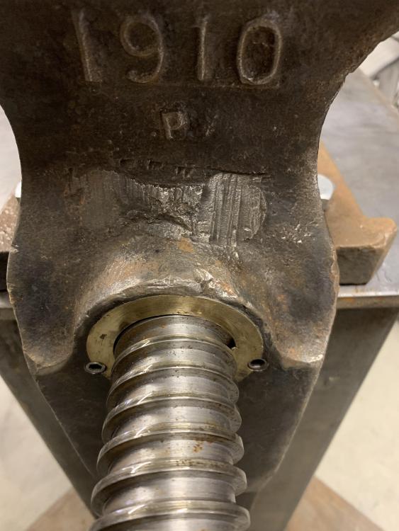

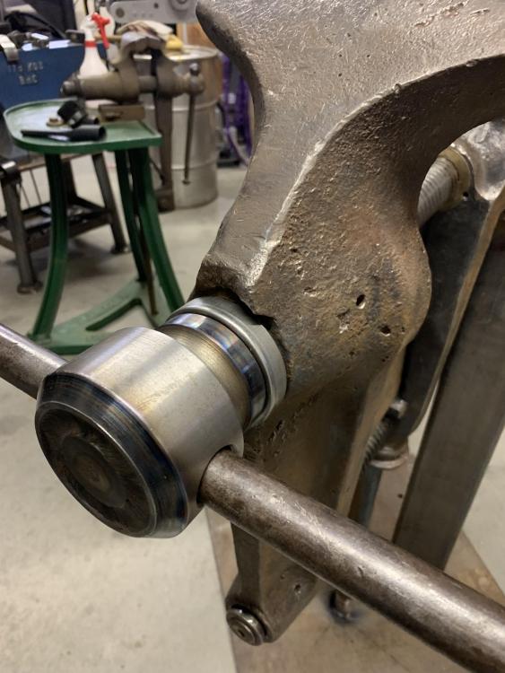

David Kahn Posted April 29, 2022 Author Share Posted April 29, 2022 Here's the long overdue epilog to this post/inquiry. I was able to find an old-time machinist in New Hampshire (where I live) who has quite an amazing collection of older lathes, mills, etc. that he's picked up as industrial facilities have closed down over the years. His machine collection includes some surprisingly large pieces of equipment. I took the vise to him, thinking he could help me to create a large tap that I could use to clean up the interior threads on the upper screw. After some consultation, we decided instead to bore out the upper female screw hole and install a bronze replacement bushing that would be tapped to the correct thread size. He was able to create a new upper male screw with the correct buttress thread and create and install a matching threaded bronze female piece in the vise body. Today, I finished reassembling the vise, which now opens and closes properly, and will hopefully last another hundred or so years. Economically, it was probably not a good idea to buy and repair this old Fisher vise, but not every decision is economic in nature. There aren't so many of these old Fisher number 6 vises left, and I'm glad this one didn't end up in the scrap pile. Here's a couple of pics of the vise installed on a stand fabricated for it. If anyone wants more detail, I know have a pretty good working knowledge of how these vises come apart and go back together. Quote Link to comment Share on other sites More sharing options...
Purple Bullet Posted April 29, 2022 Share Posted April 29, 2022 David - Some beautiful work. I'm not sure I would use that as a post vise, though. Even though it kind of looks like one, I would be afraid that hammering on the top would stress the screw threads. I'm not sure what that vise was originally designed for, but I would use it more like a bench vise. Quote Link to comment Share on other sites More sharing options...
George N. M. Posted April 29, 2022 Share Posted April 29, 2022 Lovely job. You and your machinist get gold karma stars for bringing an old tool back to life and use. That is a very cool vise. I'm not sure I have ever seen one like it. "By hammer and hand all arts do stand." Quote Link to comment Share on other sites More sharing options...
Frosty Posted April 30, 2022 Share Posted April 30, 2022 That's a beautiful job of restoration David! You and your machinist friend deserve the gold stars and a banner. I've only seen pictures of that type vise but don't know what they were used for. I agree about not beating on it like a post vise. Thanks for remembering us and bringing pics. Frosty The Lucky. Quote Link to comment Share on other sites More sharing options...
jlpservicesinc Posted April 30, 2022 Share Posted April 30, 2022 David that really looks amazing.. That is my favorite style with the front having the wing on it.. The later models did not have the wing. I will at some point come take a look and have a chat about the vise if that is ok.. I was just up in Springfield, NH today.. Quote Link to comment Share on other sites More sharing options...
Malleus Posted May 10, 2022 Share Posted May 10, 2022 For what it's worth, it turned out really nice, and I'm glad you kept it out of the scrap pile. Enjoy! Quote Link to comment Share on other sites More sharing options...
arftist Posted June 2, 2022 Share Posted June 2, 2022 It is a post vice made for blacksmithing by Fisher. Although the body is cast iron these vises, like Fisher anvils which are also cast iron are certainly made to have hot iron beaten in them. I did journeyman year in a shop with an 8 inch Fisher I good working order. I was worried about breaking it but was instructed by the owner that I couldn't hurt it. Of course I thought to myself "Oh Yeah?" If you are a collector don't use the shiny things. If you are a blacksmith hammer away Rene. It is a fantastic post vise. Quote Link to comment Share on other sites More sharing options...
