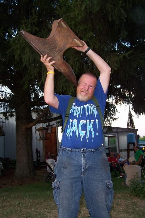

If it weighs more than maybe 15-20 lbs. it's not a Peter Wrong. Below is me mugging for a pic with a Peter Wrong. An honest to goodness certified by the maker Peter Wrong anvil. Weighs maybe 25 lbs. tops.

            it’s great to hear your advice. Years ago when I first started I posted on the set up I bought and being over zealous ended up getting a dead piece of (cast iron) you know what I mean. Anyhow you gave me some pointers on safely setting up my forge. I was determined and pounded that cast for a good while but man did it beat me back! This one is 160 pounds as far as the ball bearing I lost mine so I’ll have to get another but I can say I tapped it a couple times wit a hammer and it felt very responsive and the ring is sweet. Honestly I don’t see any reason to repair at this point, I’m thinking it will serve it’s purpose just fine until someday I can buy something top notch. It’s funny this popped up as I’m in the middle of an old unisaw rebuild. Just bought the thing from Erie Penn as I’m just outside Buffalo ny. Alll in all I’m under 300 fro the anvil and the unisaw so I’m doing good I think. Your pic is great, that there must be one of them hollow anvils? I wasted a half hour drive to go look at a hollow anvil not long ago. I wasn’t happy when I got there just like this new one the guy had two pics but one was it laying down and it kind of was like trickery as I got there and sure enough he was hiding the side with damage. Oh before I forget on the identification of my new anvil I’ve been finding faint letters on it. There’s an S on each side of the front base, I also uncovered two p’s, three markings for the hundred weight. Im pretty sure it’s a pw on all accounts. Thanks for sharing your wisdom it really means a lot to me.

The Peter Wrong was made of sheet steel by Roger Degner, he brought it to a get together. It's not only hollow it floats. It's a gag anvil, he used to have children at demos hand it to him. I understand he'd made a couple but this is the only one I saw.
