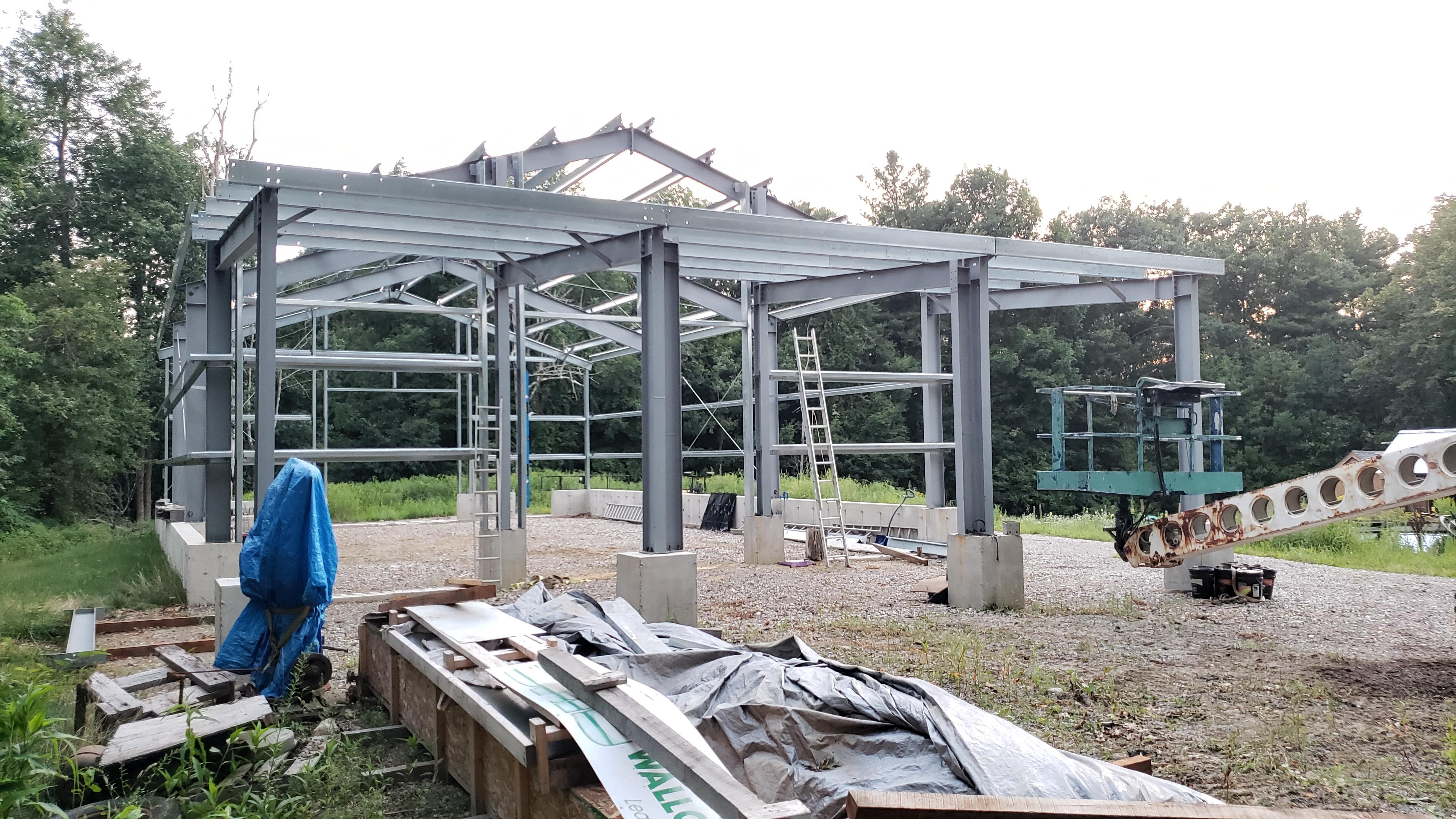

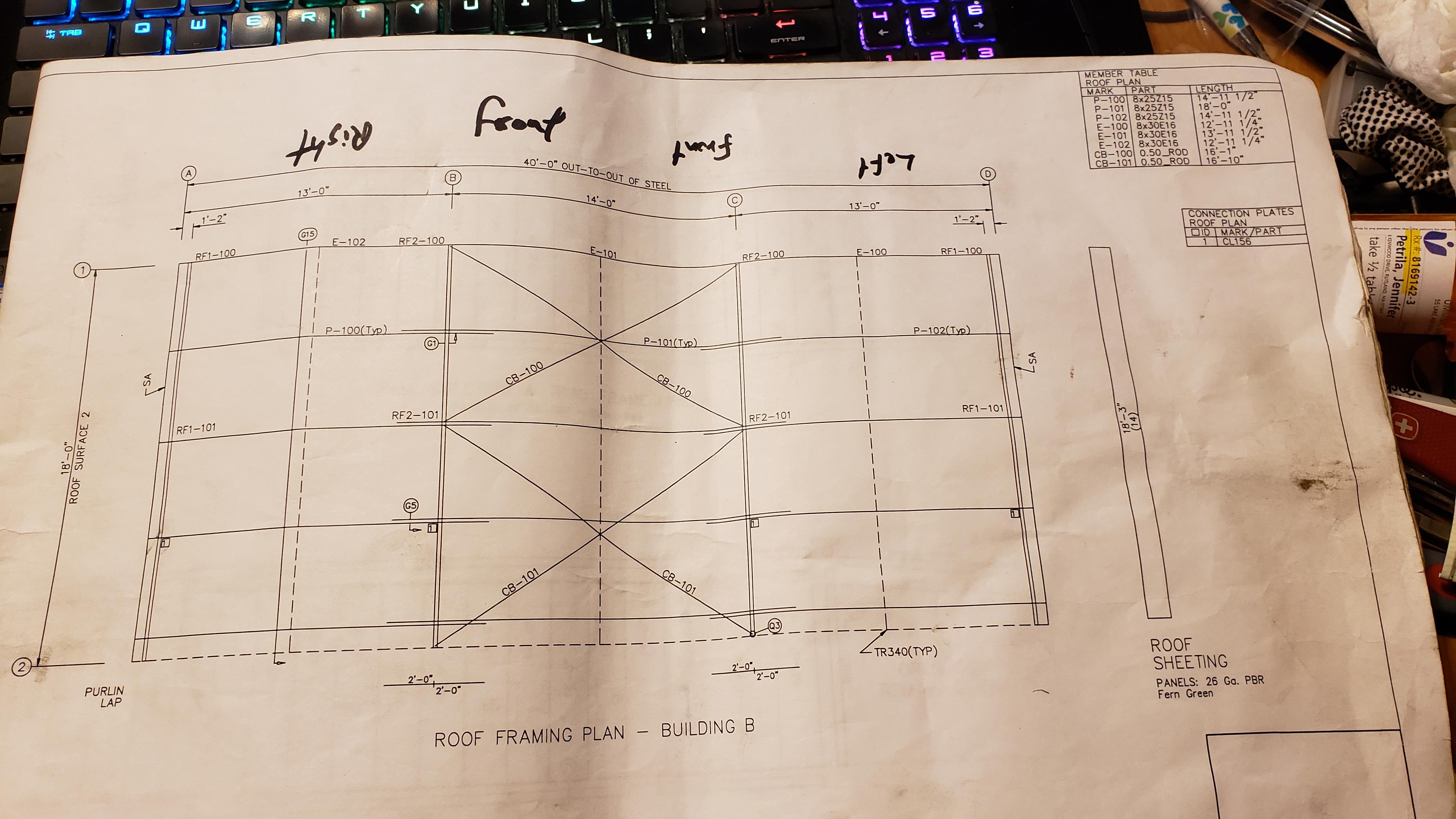

jlpservicesinc Posted August 8, 2020 Author Share Posted August 8, 2020 So, here we are the first week of August.. The shop was a no go until about 3 weeks ago.. I spent a bunch of time trouble shooting the Grove manlift and getting it operational.. I'm glad I did.. Its been a lot easier to use than ladders.. Its still slower than climbing up on rafters of a real steel building but there is no walking on the purlins as they are sheet metal. I can't install the front window or entry door till the floor is done but overall I have made good steady work the last 4 or so weeks.. Its been super hot here and there is no shade when working on the building.. A few notes.. The building instruction (construction plans and directions book).. Are absolute junk.. The detail drawings are lack luster and I have had to go back and redo work 2 or more times to get things to work properly. At this point I have had others over who are in the building trades and they don't do any better than I do with the plans. LOL.. For the most part handing them back and throwing their hands up. With this. It has been a huge learning curve and the guy whom was the sales rep was ill informed as to how much time and how many people it would take to put this thing up. Also, knowing what I know now, the only way to really do one of these buildings is a decent time frame is to have a crew that has done them before. Without prior experience most of it is simply a guess as to how it goes together after the main frame. There are 4 different types of bolts which are only shown in the "Details" pages without major notice on the main pages. So, every detail has to be scrutinized many times before one can move onto work. I have now become and expert in Grove manlift repair.. LOL.. As well as Bison steel building crazy. Quote Link to comment Share on other sites More sharing options...

Frosty Posted August 8, 2020 Share Posted August 8, 2020 Looks to be coming along nicely now you have the manlift working. A LOT easier to get things to line up and square using the man lift isn't it? Leaning a ladder on the arches moves them and even a little bit can throw the whole building off. Don't you just love the/box bag of different size bolts and not one indication where the odd ones go on the plans? I spent a lot of time looking at other steel frame buildings, made sketches and took a few pictures. Funny about that, it seemed the folk who erected them couldn't figure the bolts out either there were a lot of ones in places they obviously weren't supposed to go. They still worked though so what the hey. I'm sure glad I didn't build a shop as complex as you are. Frosty The Lucky. Quote Link to comment Share on other sites More sharing options...

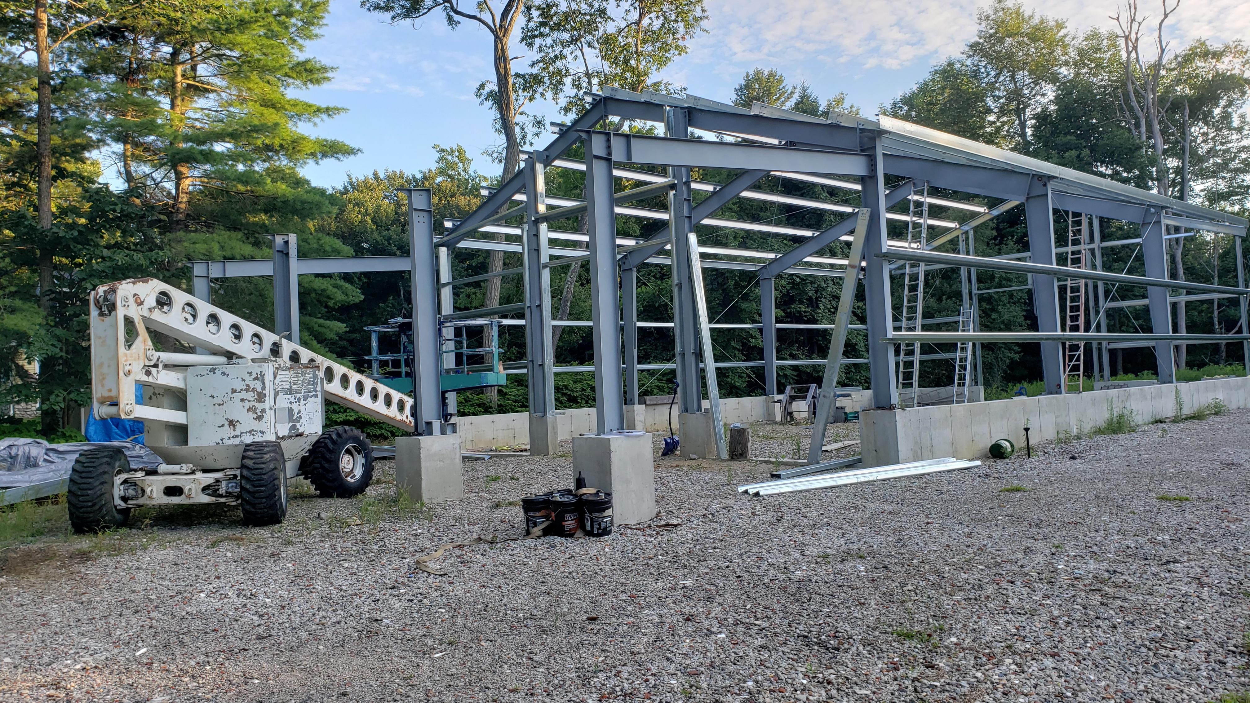

jlpservicesinc Posted August 9, 2020 Author Share Posted August 9, 2020 Pnut, Anvil.. Thanks ... Pnut, the trick is to just not stop.. I get into the mindset that If I don't do it, it isn't going to get done. LOL.. Frosty, the manlift has made things easier for sure. I still prefer to walk on Girders and squirrel around up on the beams but with this type of building there is none of that going from end to end so the manlift allows for me to get to one side to the other so is a huge time savings there. It has worked out very well to have. Today I used it to haul up the last of the front shed dormer roof beams and then used it to haul up the purlins for the sheathing. It has worked out extremely well and now that most of the bugs have been worked out of it, it is a great machine to have for sure. I never gave it thought about a ladder moving stuff out of alignment.. I just bounce the ladder or use my foot to push the ladder away from the weaker side.. But I suppose it does make a difference. The bolts "Argh".. My largest complaint is the crappy instructions.. Once falling into line with the designers thought process things make more sense but I have to find that thought process or else it just makes it super frustrating.. Just like today, I put the center section for the shed dormer.. I then put up all the purlins sorting them to their "Wrong sides".. I didn't know they had the roof backwards on the drawing so Left is right and right is left.. I knew once I tried to bolt them in that the measurements were off though the bolt holes aligned.. I spent 7 hrs out there today and called it quits when I found out they all need to be switched from left to right. I should have gone thru and marked all the drawings with left and right and front and back.. Might have made a difference.. I love seeing the bolts, beams, brackets and stacks of items disappearing. If I had ample help it would have been easier for sure. It is very hard to find people who are good working by themselves without guidance.. This week will get the strapping for the insulation and all the TR340's installed as well as the SA.. Little set back with having to switch sides but not bad overall. Quote Link to comment Share on other sites More sharing options...

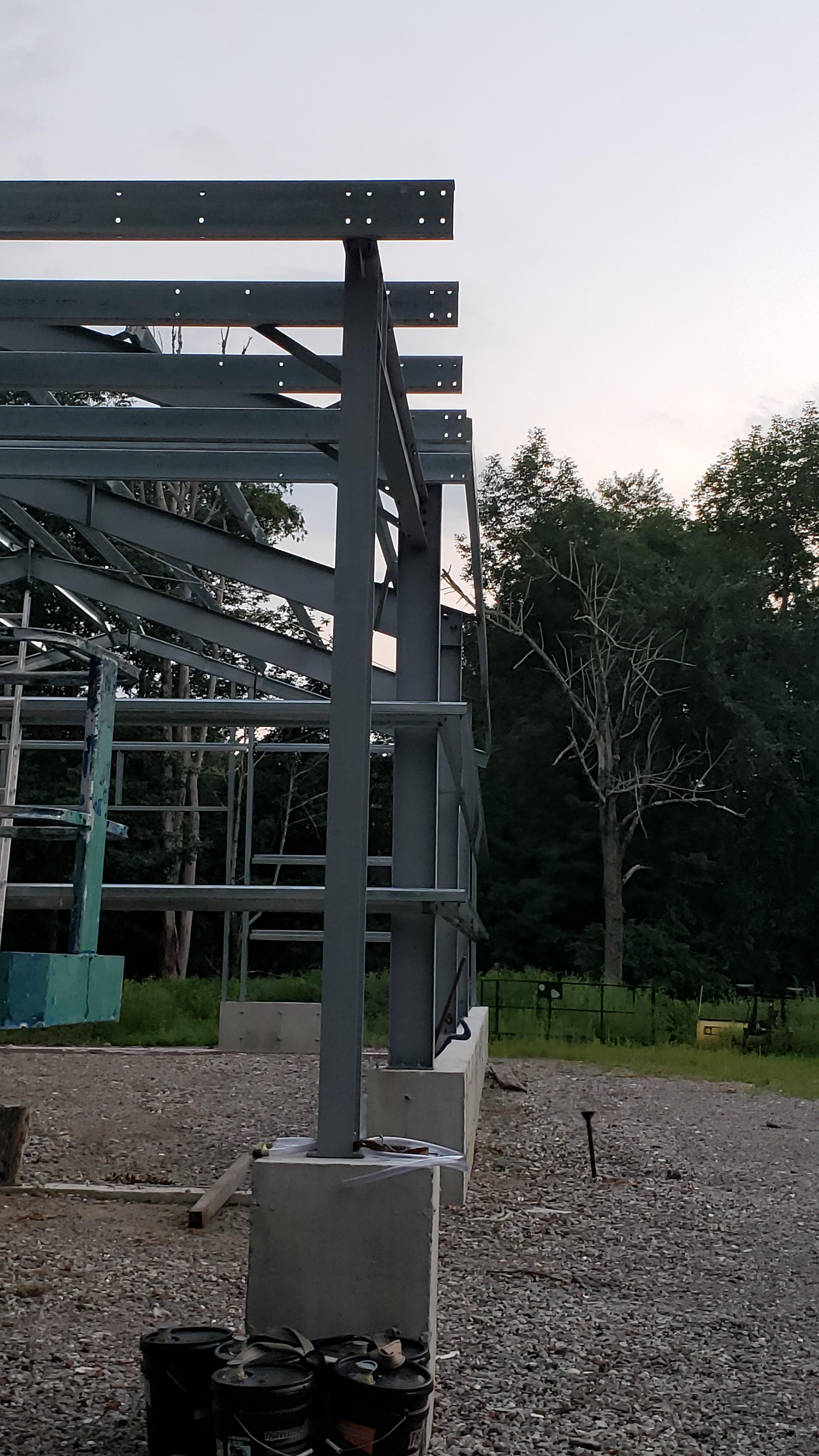

jlpservicesinc Posted August 10, 2020 Author Share Posted August 10, 2020 And today all the crazy "left" is right" and "right is left" and front is back and back is front" is all fixed and everything looks like it is supposed to.. Lots of photos.. I also organized all the remaining bolts back into their perspective bags/boxes for a better accounting. It is so rewarding seeing the pile of items shrink with each passing day. Tomorrow the rod bracing goes in and the front section will be squared. I will then finish off the front wall which has some really crazy custom holes to be drilled. (again the instructions and diagrams are crap).. Quote Link to comment Share on other sites More sharing options...
Frosty Posted August 10, 2020 Share Posted August 10, 2020 Oh I'm right with you on walking the walls. I loved walking the walls when we were building the house but erecting the shop was nothing like it. Your plans tell you the perlins have to lean the right direction so the roof panels will attach correctly? Mine didn't. Fortunately I noticed before I bolted too many on. "Gee, why are the tops of the purlins leaning that way when the roof slopes the other way?" I asks myself. The thing is I really noticed after I climbed down, walked a ways off and looked at it. That's a good method of seeing problems you might not notice from up close. You're cruising on it now Jennifer, won't be long and you'll be moving equipment in. Frosty The Lucky. Quote Link to comment Share on other sites More sharing options...
jlpservicesinc Posted August 10, 2020 Author Share Posted August 10, 2020 Frosty, you are so right with the looking and seeing things that are off. Even stuff that is listed as one way when installed goes the other way. I dislike redoing things 3 or 4 times and that has really cut into active productive time. Been lots of that. But with this said. It is coming along.. With any luck the front section will square up easy. Tomorrow I will also order the correct length I beam so I can get started on that too. After the outside is done.. I will install the infloor guzuntas and vacuum system.. With any luck it will be ready to move stuff in by december.. Quote Link to comment Share on other sites More sharing options...
