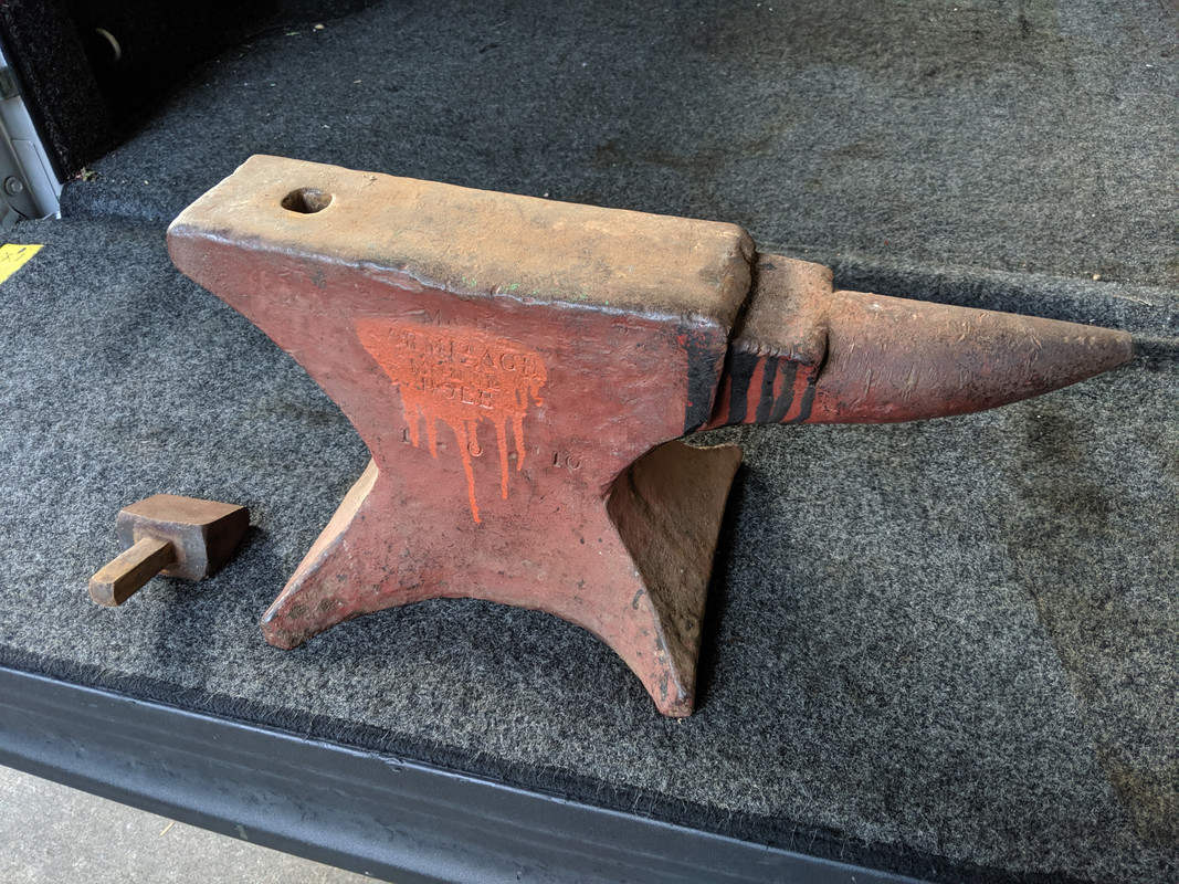

Found & Cleaned-up very old 122lb Mouse Hole
So I traded some nice vintage/antique power tools (Craftsman Mohawk drill press, table saw, jointer, and 5" Wilton bullet, and a HF welder setup) for this nice old lady. Turns out it may be quite old, but it looks like it was well-taken care of most of its life. I hope that I can continue the trend of good caretakers.

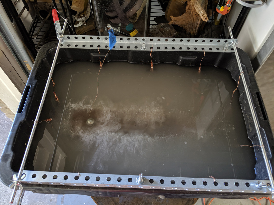

After some basic prep (knocking off the loose dirt and debris and using acetone to remove that black tar-like substance, it took an overnight bath in the electrolysis tank:

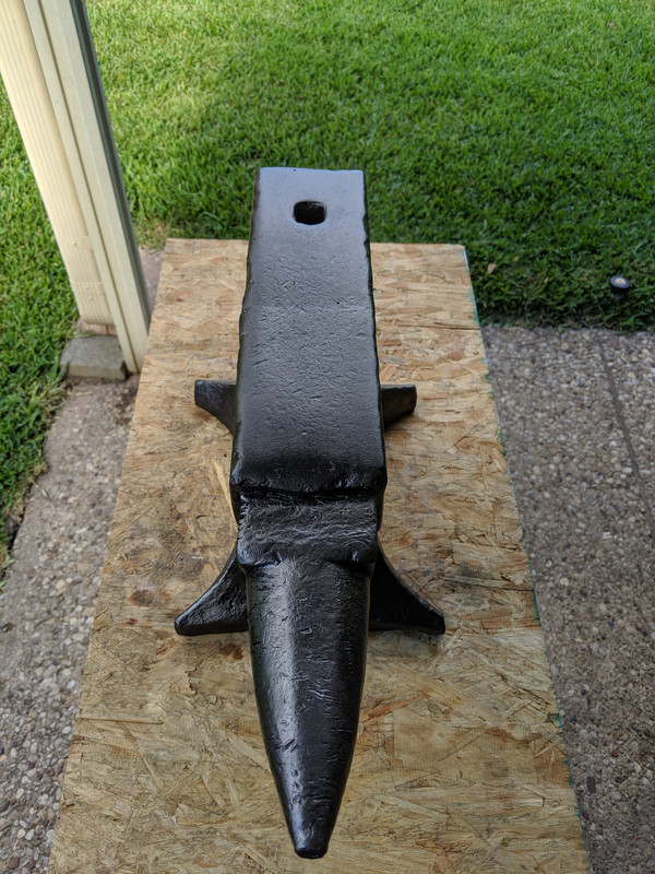

Out of the tank and after some basic brushing with a SS wire brush. Then sat in the sun to dry out for several hours:

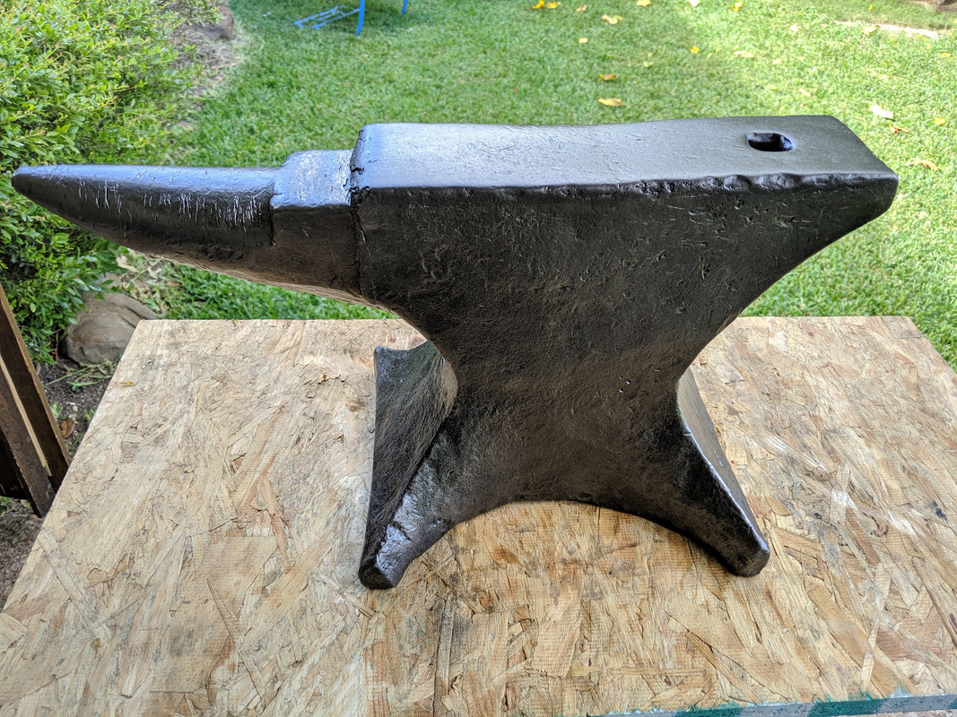

After dried, a more detailed brushing was undertaken to get the remaining rust and detritus out of all the nicks and crevices. Followed by a pretty gentle overall wire brushing to even out the bright spots from the detailed brushing. Lastly, a light coating of BLO (boiled linseed oil) over the whole surface. Pretty happy with how it turned out. Now I just need to make a stand for it and get to work.

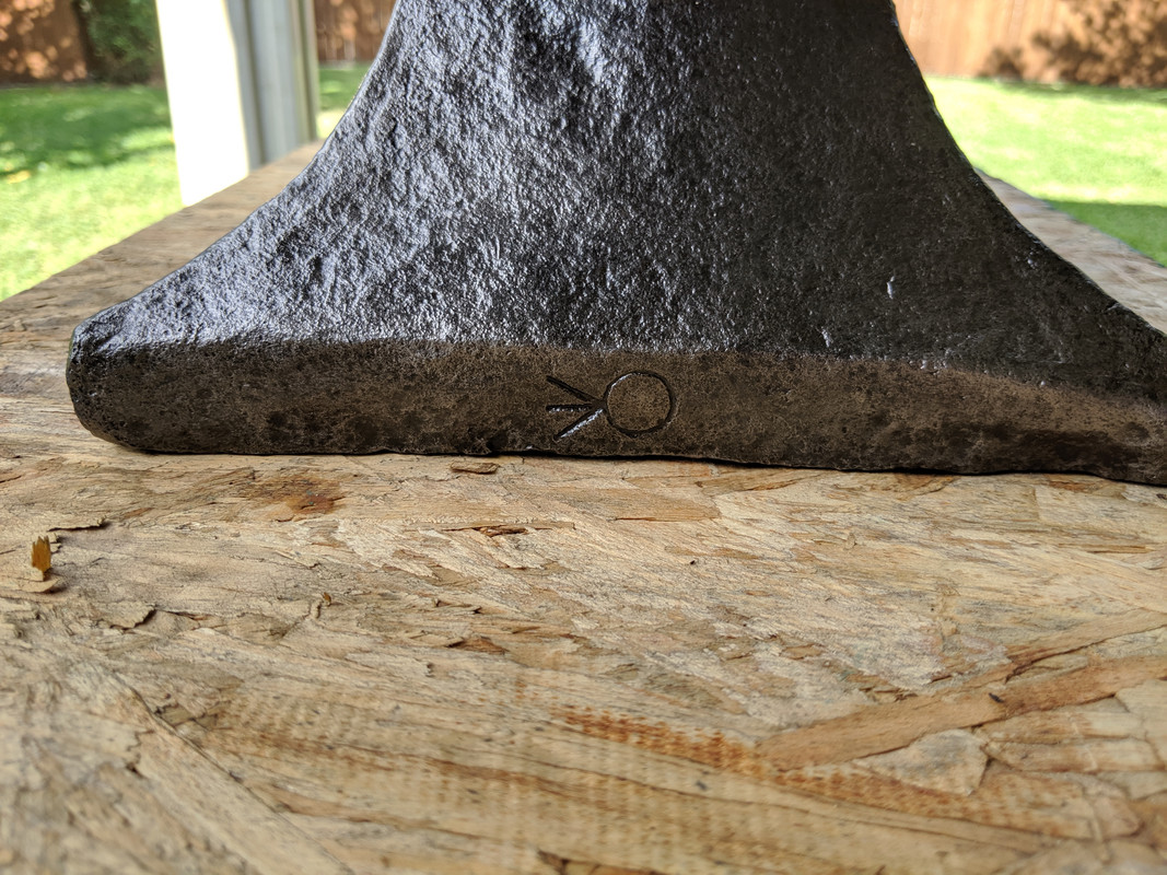

Lastly, does anyone know what this marking under the horn means? Is it a centering mark?
Looks like a very fine 122 pound MH. I think that mark is a British Military acceptance Broad Arrow.

I imagine your MH has been imported from Britain or Europe. I don't think it's old enough for the AWI or War of 1812. Although because it dosen't have a pritchel hole it is old. I learned about the Broad Arrow while restoring old muskets.
I just looked up the Broad Arrow codes and the Arrow with an O is accepted in 1942. The anvil is older but was probably pressed into service then.

Notice how clean that stamp is and the area looks to have been dressed before stamping.  Definitely does not date back to the forging of a non-pritchel MH!

Thomas, I'm wondering if you mean the dressed up, ie "shinier" area around the stamp after it came out of the e-tank, but before the BLO. If so, that was actually my doing. I cleaned up all the stampings with a dremel tool and wire brush so I could get all the gunk out of the crevices. If that's not what you mean, then I don't know. Everything about the anvil looks original to me, down to the "British Broad Arrow" - so *shrug* beats me.

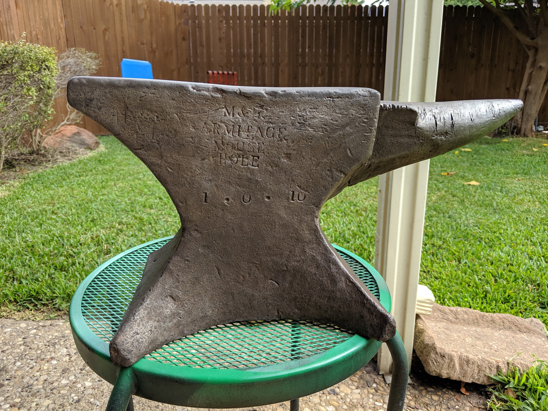

Pre 1830's with it lacking the pritchel hole.
Based on Richard Postman's book, this would put it between 1816-1830. I'm tickled to death with how old it is and all that it has "seen" since it's forging. That stuff just gets me excited.

Mayer, I recommend you acquire a copy, loan or buy, of Richard Postman's book Mousehole Forge.  Fascinating reading about the history of those anvils and the forge.
Already did and the arrived last night! I must admit that I immediately skipped to the Mouse Hole section to see about placing an age to the anvil, but I'm excited to read through the rest of it!

No I meant that to my eye it looks like a smoother section right where that was stamped and there doesn't look to be a lot of weathering of that stamp. Compare it with the stamping on the side that was original to that anvil.
Ah, I understand. Maybe that could have to do with its placement at the foot rather than on the sides though?
I just did some (re: very little) digging into the history of the British Broad Arrow and from all the images that I could find, the letter code was always placed to the side or under (what would be the shaft) of the arrow. Really makes me wonder if we are just inferring a Broad Arrow on what may be a centering point? Though why they would be a centering point on an anvil is beyond me. Regardless, still pretty xxxx interesting and I appreciate everyone's input.
