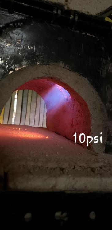

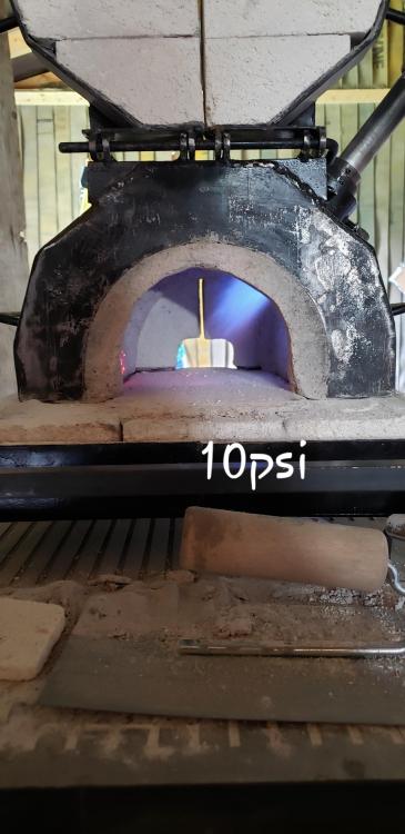

Trevor84 Posted July 15, 2019 Share Posted July 15, 2019 Hello all, my first post here. 3rd forge build. First was soft brick pile and (worked well) , second was the Zoeller "simple forge" (too big) I'm looking for some guidance, possibly too late unfortunately. I'll start with the description of my build as best I can and then ask a few questions. 1/8 steel plate for the body 2600 deg soft fire brick floor and doors Two 1" layers of ceramic wool 2nd layer Rigidized (400ml too much 1/4-3/8" kast-o-lite 30 let sit in wet bag for 24hrs (first coat) 1/4-3/8 kol flame face floor Apx 300-350ci and interior 3/4" Reil style burner with a mig tip mod I've only fired this up to dry out the Rigidized and to dry out(?) the KOL (at least I thought I dried it out) . I've dragged the forge back and forth to carve a groove for the base of the forge to sit in the soft brick floor to seal the joint. With the forge running I held my hand at the joint where the body meets the floor and feel no heat escaping through it. After running the forge for 5-10min in short runs at 2.5- 5-10-15psi the whole outer body has gotten almost too hot to touch evenly on both sides not just the side the burner faces. I have no dragon breath shooting out the ends, doors open or closed. I am at a loss to why this is happening the interface of the upper to floor does not seem to be leaking exaust. I only rigidized the second layer of wool but could I have over wet it so steam inside the wool is super heating the steel shell I used 400ml apx of the rigidizer? Should I worry about the flame heating the steel at the base of the upper shell that holds the insulation......? The paint on that part isn't even burning though. Should I gouge a deeper trough for the upper body to sit down into? With all this keep in mind I hadn't even gotten to full forging temp. I hope this makes sense and sorry for the length. I'll try to shrink the photos if possible from my phone. Not sure if these links will work, I'm new to you tube. Link to comment Share on other sites More sharing options...
Buzzkill Posted July 15, 2019 Share Posted July 15, 2019 Are you concerned because the outer shell of the forge is getting hot? Though I don't claim to be an expert, I have built several propane forges with different configurations and burners. The one thing they all have in common is that when they are at operating temperatures the outer skin gets too hot to comfortably rest my hand on, but not hot enough to burn me if I touch it briefly. If your outer skin gets hot enough to burn the paint or gets glowing hot (other than around the openings) then you have a problem. There are probably some people who have built forges where the outer skin remains cool enough to rest your hand on when it's up to temperature, but I am not one of those people. I did not see any obvious construction issues that need to be addressed, although I would expect the handles for your door openings to be unpleasant to use bare-handed after the forge has been running for a little while. Link to comment Share on other sites More sharing options...
Trevor84 Posted July 15, 2019 Author Share Posted July 15, 2019 Ya it's the temp of the outside of the forge I'm surprised at. My old Evey day forge was brick so I never really touched it or thought about it getting too hot aside from feeling my fuel lines. I keep thinking that there must be steam inside by the way it heats so evenly I'm just not sure if that's possible. No the paint isn't even burning at the bottom where it meets the floor. Thank you, I expect I'll be adding wood or something to the handles or keep a glove handy. Link to comment Share on other sites More sharing options...

Frosty Posted July 16, 2019 Share Posted July 16, 2019 Trevor: Do NOT change things yet, you haven't given it time to dry out and indeed ANY residual moisture in the liner will turn to steam. Rather than dig the channel for the top half to seat in any deeper check with a stove shop for some "stove rope." It comes in cords hence the name rope but also comes in belt. It's designed to seal stove and furnace doors and works a treat in a forge. You have the psi gauge in a bad place. Where it is it's AFTER the jet so there will be a fractional pressure drop to it. Put it where you need it, on the regulator so you can watch while you adjust pressure. Yes? Most regulators have a plug where the gauge goes, if not just put a T on the outlet for the gauge and gas line. This position will give you the most accurate pressure measurement as the entire supply circuit will act as a plenum equalizing pressure. I know intuition says if being on the far side of the jet makes for a pressure drop and inaccurate readings then being right next to the regulator outlet must lead to a higher reading. That makes sense but doesn't hold or manufacturers wouldn't put the gauge fitting ON regulators. About psi readings, do NOT make the mistake of trying to judge performance by the readings, they only have meaning for YOUR forge, what other people run only means something on THEIR forges. The best use for a gauge is to make it easy to repeat forge temperatures without having to wait for it to get hot and adjusting. For example a person might do basic forging at high orange heat and THIS psi reading is 6psi. The psi reading for welding might be say 9psi. You write these down in your notebook and double check until you know them by heart. So, here's where it helps. You weld up a couple billets in the morning but are going to do some decorative forging the rest of the day. Rather than waiting for it to cool enough to eyeball the adjustment you just turn it down to 6psi when you get back from a coffee or tea break and go to work. Make sense? Repeatability is where gauges really shine, we're not doing high precision stuff here. Frosty The Lucky. Link to comment Share on other sites More sharing options...

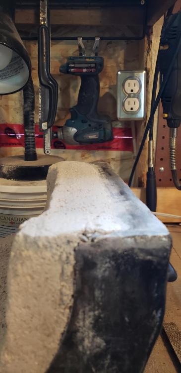

Buzzkill Posted July 16, 2019 Share Posted July 16, 2019 My current forge is "D" shaped as well. Where the upper portion of the forge meets the floor on both sides I used some strips of scrap fiber blanket (delaminated to half thickness) and sprayed with rigidizer. The weight of the upper shell compresses it nicely so there's little to no direct flame exposure for the blanket, and the rigidizer kind of glues the blanket to the upper and lower surfaces. Fire place rope should work well too though. Link to comment Share on other sites More sharing options...
Mikey98118 Posted July 16, 2019 Share Posted July 16, 2019 You need to cut the metal shell back away from the openings. Leave at least an inch of of ceramic showing beyond the shell, to keep it from overheating from hot exhaust gasses. Link to comment Share on other sites More sharing options...
Frosty Posted July 16, 2019 Share Posted July 16, 2019 That's another thing, the heat from the forge or what convection carries up the burner when you shut it off ages gauges quickly. The convection heating of the burner is commonly called the "Chimney effect." Your flames look pretty good, does steel scale in the forge? Ditto Mike, the exposed steel shell around the doorways will warp when it gets hot. I KEEP making the same mistake and I know better but it's a hard habit to beat. Frosty The Lucky. Link to comment Share on other sites More sharing options...
Trevor84 Posted July 16, 2019 Author Share Posted July 16, 2019 Mikey, I was worried about the steel lips being over heated, I will try the gasket of sorts (wool or rope) and see how it reacts if that's doesn't cool it down I'll trim out some steel and get some wool exposed. I should have asked more questions earlier I'm fixing my choke so I can close it right off at shut down to hopefully reduce the chimney effect. I've removed the gauge and capped the pipe, what you say about the gauge makes sense. Ill shine up some steel later and see what happens. If it's rich I'll see scale build while in the forge..... I believe that's the typical test/reaction. Thanks guys Link to comment Share on other sites More sharing options...

Trevor84 Posted July 17, 2019 Author Share Posted July 17, 2019 Ya my welds aren't the best, I've got no worries that I made a boiler if that's what you mean I just keep hoping that the steam is causing extra heat. But if that's not the case and the gasket doesn't work then I'll be trimming the steel. I would trim a big strip off the bottom lips but the thought of the insulation dropping out when I move it worries me. Link to comment Share on other sites More sharing options...
Mikey98118 Posted July 17, 2019 Share Posted July 17, 2019 If you rigidized the blanket, it isn't going anywhere; If you didn't rigidize, it's cheap and easy to do... Link to comment Share on other sites More sharing options...
Trevor84 Posted July 17, 2019 Author Share Posted July 17, 2019 I did not rigidize the first (outer) layer of wool or stick it to the body. I did rigidize the second (inner) layer though. How stiff would 400ml of rigidizer make one layer of wool? Say if I left a 1" tab at each end of the bottom lip should that hold itself possibley? Link to comment Share on other sites More sharing options...

Frosty Posted July 18, 2019 Share Posted July 18, 2019 8 hours ago, Trevor84 said: Thanks for you patience with these silly questions guys. Nothing silly about them Trevor, you're still figuring this stuff out. The shell of my forge is too hot to touch for more than a second and it's about average. I think you're focusing on a problem that isn't, the outside of any furnace that reaches in excess of 2,000f internal temperatures and only has 2" of insulation WILL be hot on the outside. It's not a thing. It's also no THING if you didn't get the outer layer of kaowool rigidized, it's sealed into the forge so particles can't escape. If you see a spot rigidize it. You're doing better than most folk building their first propane forge who didn't follow a proven plan. You're good, relax, maybe just light that beauty up and beat some HOT steel. Frosty The Lucky. Link to comment Share on other sites More sharing options...
