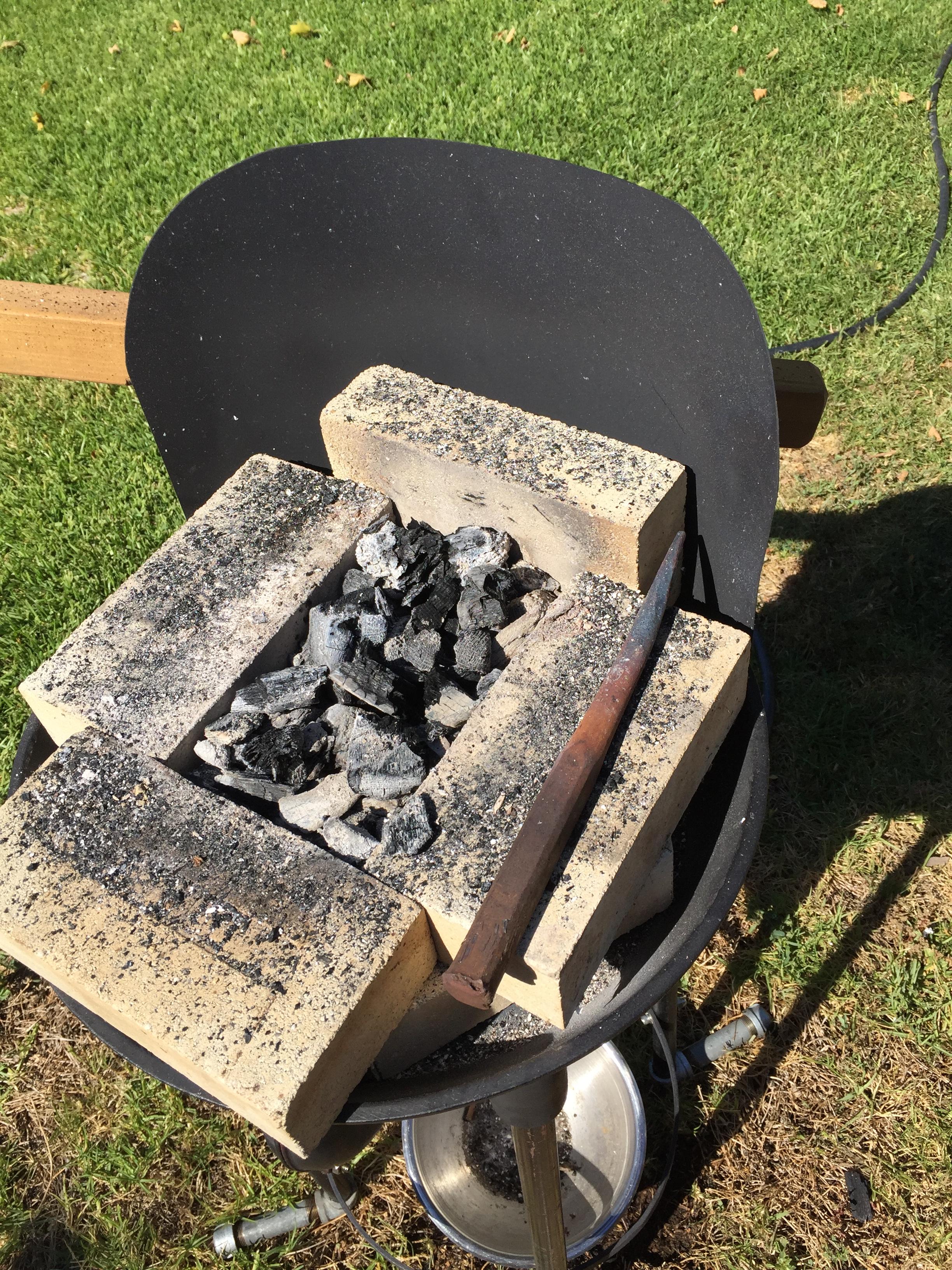

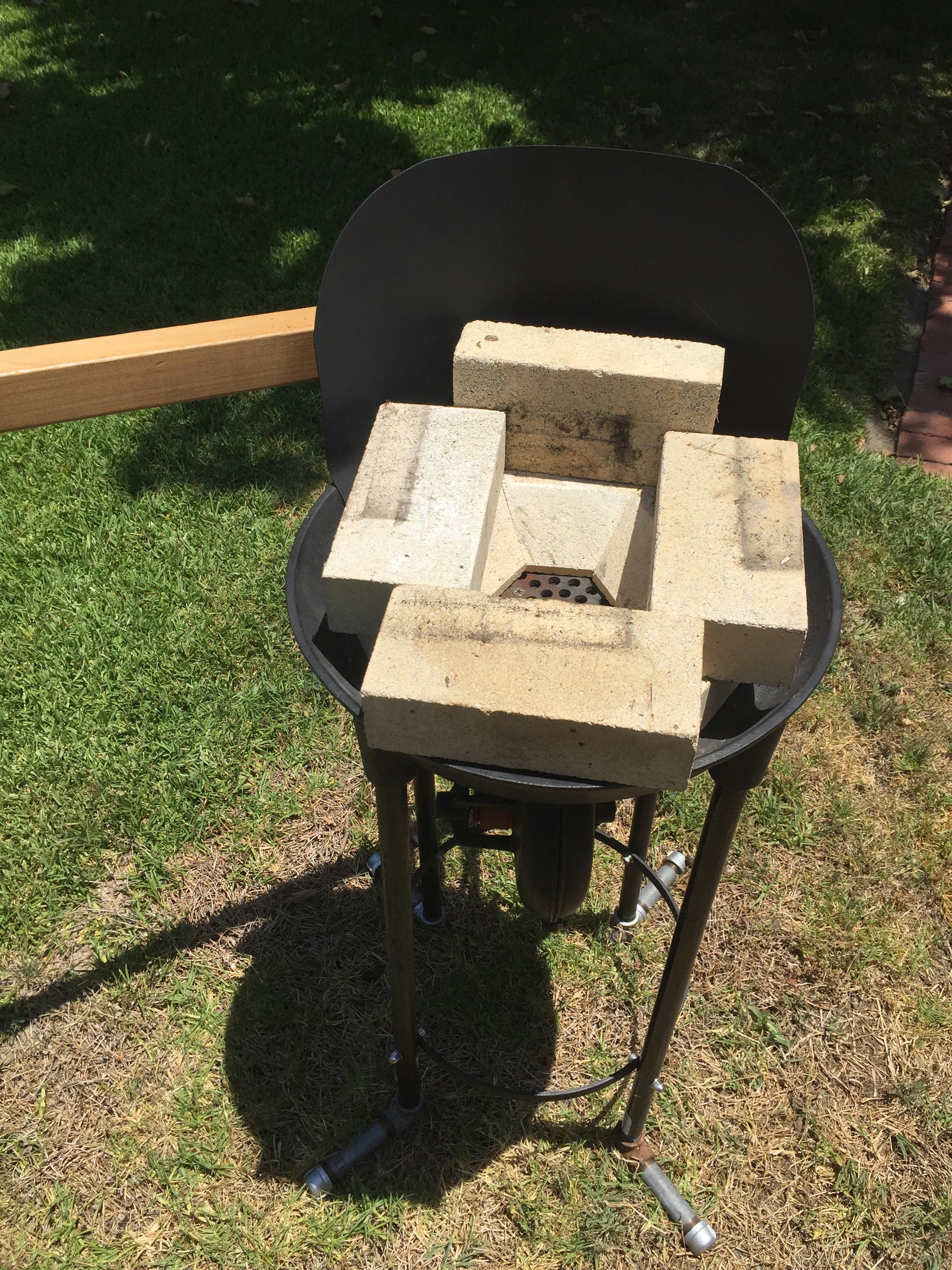

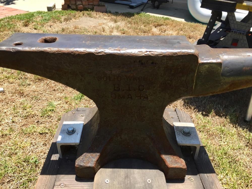

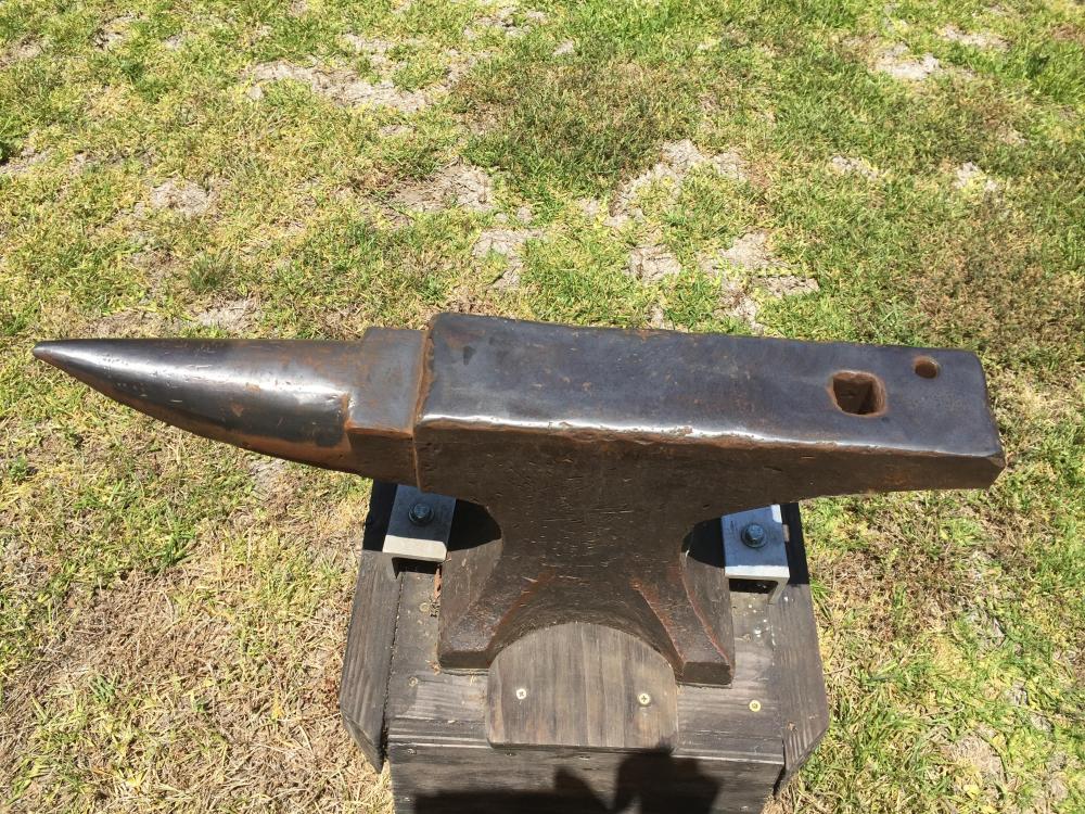

Tomas W Posted July 13, 2019 Share Posted July 13, 2019 I have finally accumulated everything to start my forging journey. I have rebuilt a rivet forge. I will be using charcoal to start with. I realize it is not people’s first choice for a charcoal forge. I cut some Diablo fire bricks to make a fire pot. As I will be trying charcoal for my first go. I added some bricks to get a 5” deep pot. Any and all input welcome on my setup of the forge. next up is my Anvil. A BIC Omaha #124. I just wire wheeled the face and horn to remove rust. The edges are all chipped but the previous caretaker did smooth them out. I picked up this anvil last year. After many months of haggling with the store owner. As you may know anvil prices in So Cal are insane. An average of $6-10 per pound. I kept going back once a month to try and get it lower. They were asking $550. There was no way I could afford that. Finally after long conversations with the owner and getting to know him a bit. I was able to get it for $300. Not great but at a bit over $2 per pound. I think we both did ok. I made the base from plans on the internet. It is pretty stable. Anyhow I picked up some hand held drills and a few chisels last weekend. I am going to take the one pictured and draw it. Out longer to make a 1/4” drift. As I will need one to start making tongs. i will post an update later tonight. As it is about 95 out right now. I think I will start this afternoon. Tom Link to comment Share on other sites More sharing options...
Irondragon Forge ClayWorks Posted July 13, 2019 Share Posted July 13, 2019 The charcoal you are going to use is lump, not BBQ briquets...yes? Looks like you are all set up to move hot metal. Link to comment Share on other sites More sharing options...
Tomas W Posted July 13, 2019 Author Share Posted July 13, 2019 Correct lump hardwood. Thanks for looking out for that. Link to comment Share on other sites More sharing options...

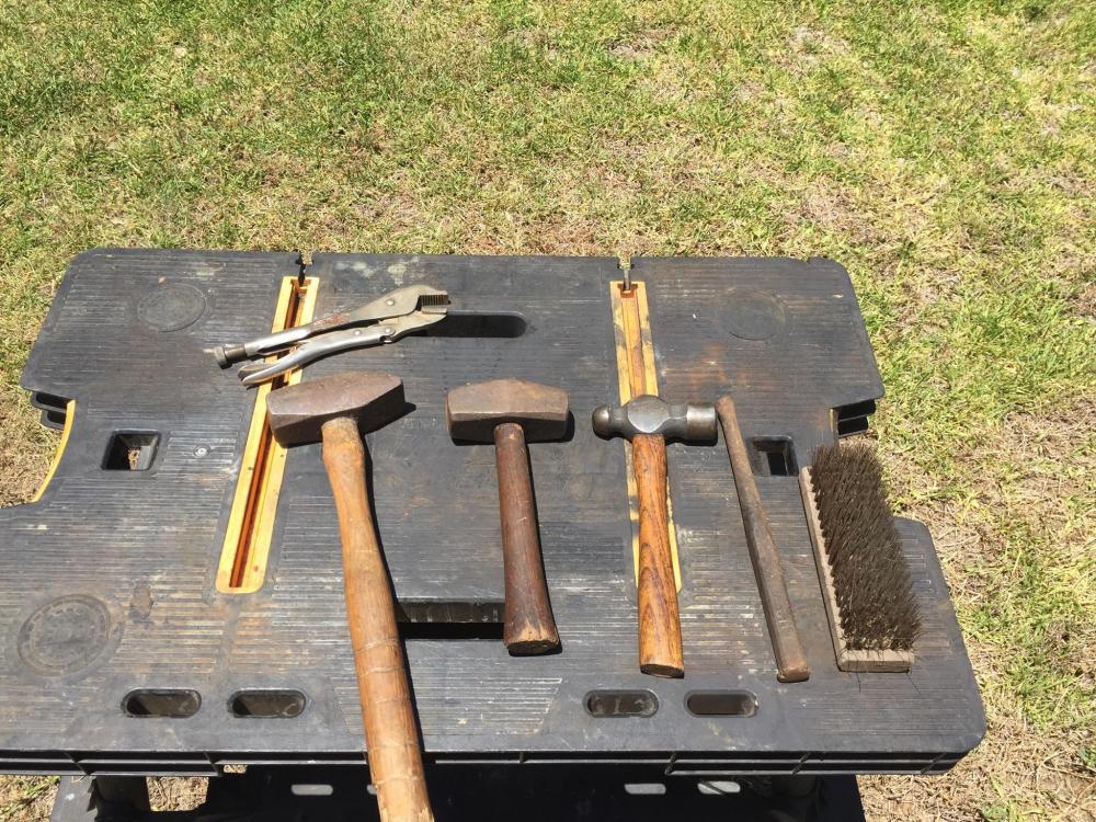

Daswulf Posted July 13, 2019 Share Posted July 13, 2019 Looks like you are set to start. Just try to use longer stock till you make some tongs. The vicegrips do put your hand close to the heat. Link to comment Share on other sites More sharing options...
Tomas W Posted July 13, 2019 Author Share Posted July 13, 2019 Well. I just made my first fire. I learned many things this first go around. 1. I am not 30 years old anymore nor am I even 40. Haha. 2. Do not go out and make a fire when it is in the 90’s 3. Need to have an electric air supply. See lesson 1 for reason. Now the good 1. I was able to get the forge up to temp in less than 10 minutes. Not bad for first go. 2. Charcoal seems to be a very viable option for me. I will be trying other methods in the future. 3. Once I got the right air flow. I was able to bring the end of my material up to a decent temp in 3-4 minutes. The fire seems to start making a nice sound and inside the embers are a yellowish orange. 4. I have done my fair share of swinging hammers. But pounding hot steel is a humbling experience. 5. Really looking forward to this new chapter in life. Tom Edit: here is my 3 heats on my punch more when it is cooler. Link to comment Share on other sites More sharing options...
Irondragon Forge ClayWorks Posted July 14, 2019 Share Posted July 14, 2019 Just keep in mind that charcoal takes a lot less air than coal. A constant air supply, like with an electric blower, will result in using too much charcoal and actually a cooler fire. So you will need a way to control the air supply. Link to comment Share on other sites More sharing options...

billyO Posted July 14, 2019 Share Posted July 14, 2019 $300 for a 124# anvil in that condition???? You did WAY better than OK, my friend. If you don't think so, I'll give you $500 for it and you can have a $200 profit. Link to comment Share on other sites More sharing options...
Tomas W Posted July 14, 2019 Author Share Posted July 14, 2019 Thanks. I guess ignorance payed off this time. That and a lot of patience. He probably got tired of me pestering him and sold it that cheep. Link to comment Share on other sites More sharing options...

Frosty Posted July 14, 2019 Share Posted July 14, 2019 Tomas: You need to break your charcoal into smaller pieces, between acorn and walnut leaning more towards acorn size will work much better. The smaller size will consume the oxygen more completely before it reaches your work. The heat will be more concentrated in a smaller area where larger pieces allow the blast to blow farther into the pile and much of the heat to blow through and out. Make sense? Frosty The Lucky. Link to comment Share on other sites More sharing options...

Tomas W Posted July 14, 2019 Author Share Posted July 14, 2019 Frosty will do. I will make sure to break them up. Makes total sense. I will be sure to stay hydrated. I seat like a pig normally so I always have my water. I will make sure to drink more when forging. Thanks all for the help. Link to comment Share on other sites More sharing options...

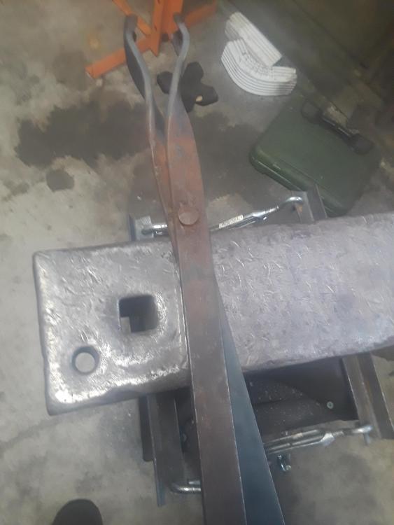

Tomas W Posted July 14, 2019 Author Share Posted July 14, 2019 Thanks guys. I will be firing it up tomorrow after work. I will be taking all advice into account to make sure all goes well. I really need so scrounge up some tongs today. Vise grips suck. Link to comment Share on other sites More sharing options...
pnut Posted July 14, 2019 Share Posted July 14, 2019 Search easy tongs. You can make a set in thirty minutes or less. I ran into a little difficulty making a pair yesterday because I tried to punch the rivet hole instead of drilling it like I did on the first pair I made but either way they are the simplest tongs to make I've seen. It's in the blue print section. Pnut Link to comment Share on other sites More sharing options...
Glenn Posted July 14, 2019 Share Posted July 14, 2019 BP001 Easy to make tongs Link to comment Share on other sites More sharing options...
