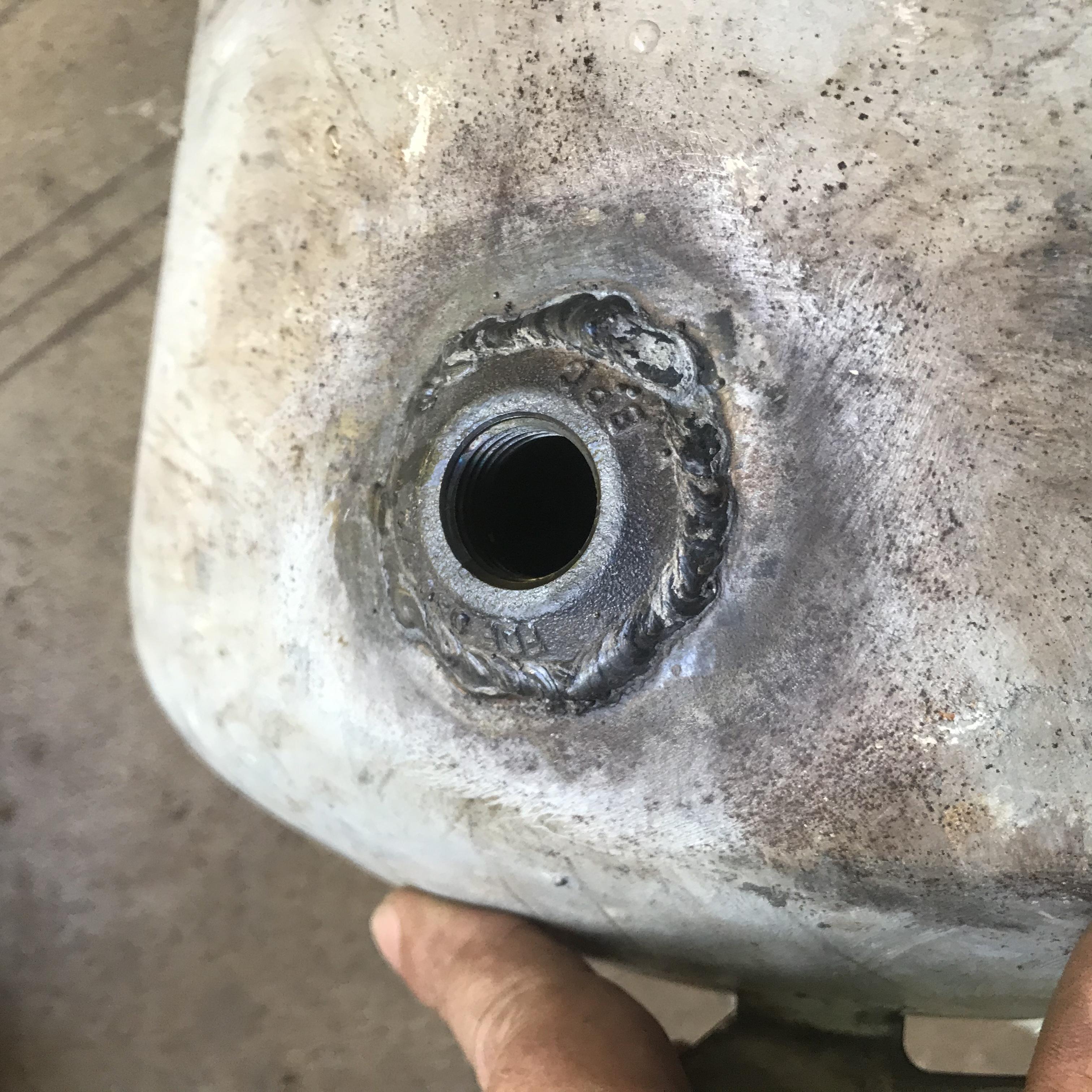

JHCC Posted July 19, 2020 Author Share Posted July 19, 2020 Working on it! Big steps forward on the tank today. Cleaned off the old chipped paint, down to the original finish: Drilled the holes for the fittings. Didn't have the right size hole saw, so I used my step drill to get as close as possible, and then finished the work with a rotary file in the die grinder. Naturally, the fittings didn't fit flat against the curved surfaces. Here's the inlet: The outlet: And the strainer for the filler/breather cap: However, some careful hammering and a bit of filing, and they fit much better. In the same order: The welds on the flanges came out pretty well: After all that, there was a fair amount of crud that had fallen inside the tank. I poured in a few handfuls of sand and swished it around to catch the filings and drill swarf. I poured that out, and then rinsed the tank thoroughly with water. It's currently drying, and I'll paint it and install the filler cap tomorrow. Quote Link to comment Share on other sites More sharing options...
JHCC Posted July 19, 2020 Author Share Posted July 19, 2020 The good news is that I got the tank painted and installed, all the connections hooked up and leak-free, the tank filled, and the motor running smoothly. The bad news is that I’m having exactly the same problem as before, with the ram moving at 0.66”/sec and bypassing at either end of the cycle. Here's a video: What the Dickens is going on here?!? Quote Link to comment Share on other sites More sharing options...
JHCC Posted July 19, 2020 Author Share Posted July 19, 2020 Although the new tank does look pretty good. Quote Link to comment Share on other sites More sharing options...
