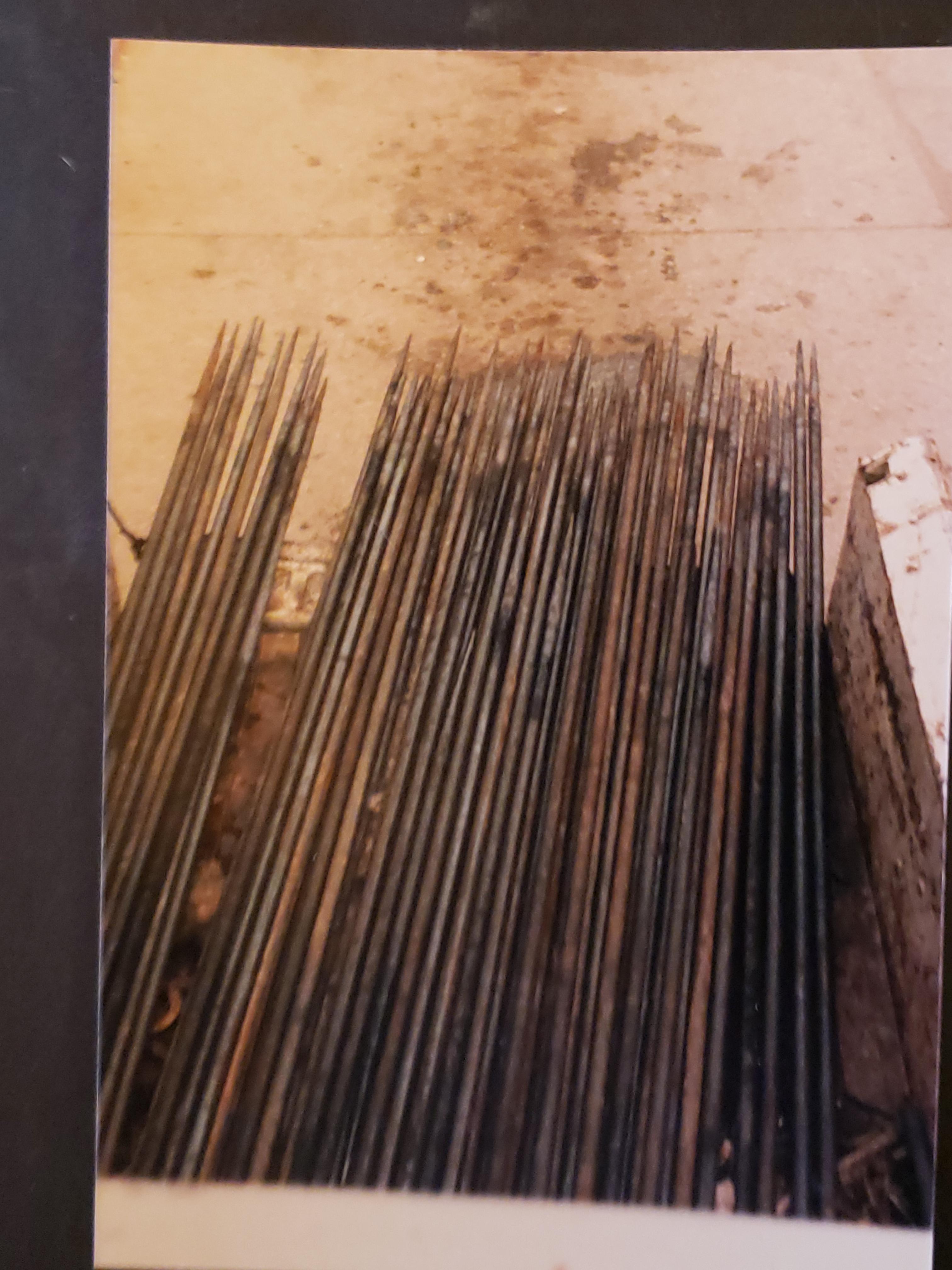

On 8/30/2019 at 1:14 PM, arftist said:
SQUARE IS DRAWN OUT SQUARE.
well, here's a pic of a long ago day. I was just where you are in your beliefs, or at least I was questioning what I'd been taught and read about as well. And that is that tapering square-octogon-round was the most efficient way. Over time I saw that when I forged a taper on say half square, forging it square worked! Pretty much 5/8" too. And I rarely worked larger stock.
Along came this job, subbed from some friends in Denver that had literally thousands of these to do for a restoration. I did 50 or a hundred or so. This pic is delivery day in my Willys pu. I still have the pu.
the job was as described above. I took it for the learning, not the money. But I did make money__  ;)  The lesson was to gain massive experience drawing out large stock by doing enough repetition in a short amount of time to get my answer to this question.
You can bet that I tried and cried experimenting with every possible way I could think of!
I got my answer. Your conclusions may differ.  ;)
square, octagon, round.
There is actually a physical reason for this. Take it as you will. It's what I was taught and makes sense.
1: steel follows the path of least resistance.
2: when tapering square, there is less resistance sideways, not in length.
3: forging on the diamond, or on narrow flats has less resistance in length. Thus it's more efficient. I'm not equipped to argue physics, just throwing out what I was taught.
Also, at least for me, I have far more control keeping a nice smooth taper. Especially on long tapers.

Anvil, that is a pile of round bar.
Everyone agrees, round to square then back to round.
This discussion however, is about square bar.
