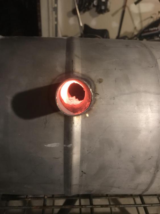

AdamTheSaint Posted February 22, 2019 Author Share Posted February 22, 2019 Well, I drug it back out and cut down the mixing tubes to 6 inches, got the jets aimed perfect, but it was just bothering on how little space I was left. As I'm taking pictures to share with the class of how much I managed to get my dragons breath down, plus the much nicer shade of blue it was, I took a pic of the jet while it was running. The first pic here is that picture... Um, that red on my weld ain't supposed to be there... So I go back to the front, still bugging myself about the room inside... Here's that pic... Something ain't right... now it makes sense. Where I thought I had only added a half inch of the castable refractory, I added over an inch... And it shifted while setting, making the flame kiss the refrac before it even got into the chamber, heating up everything wrong. The flame was firing off an inch OUTSIDE the forge. so I tore it out. Question, can I reuse the kaowool that's inside here, I've got enough tucked away that I never used to wrap a smooth layer around everything you see here, but I'm not sure if it's ok to reuse this bit? Quote Link to comment Share on other sites More sharing options...
Frosty Posted February 22, 2019 Share Posted February 22, 2019 If it isn't vitrified / burned you can reuse Kaowool though it's harder to get smooth. You ARE wearing a respirator aren't you? The ceramic fibers can lodge in your lungs and cause permanent damage like Mesotheleoma. Have you used a rigidizer? If not next time for sure it really makes for a better forge liner. Frosty The Lucky. Quote Link to comment Share on other sites More sharing options...
AdamTheSaint Posted February 22, 2019 Author Share Posted February 22, 2019 Yes sir, I surely am wearing a respirator. Both my grandfathers died of emphysema, plus two uncles, and watching it was horrible. Bad enough I smoke, but I surely don't want to increase the chances with this stuff. I used silicon silicate as a rigidizer, but under the weight of twice the amount of castable I had planned for, it just didn't do enough. Gonna use chicken wire, maybe even aluminum foil, to see if that don't help keep it all in place along with the rigidizer, before I put the castable refractory on. I'll get everything smooth with this final wrap of wool. At least I know what I did wrong. Stayed tuned, round two is where I whip it. I believe this is gonna be a fantastic forge when done. Quote Link to comment Share on other sites More sharing options...
