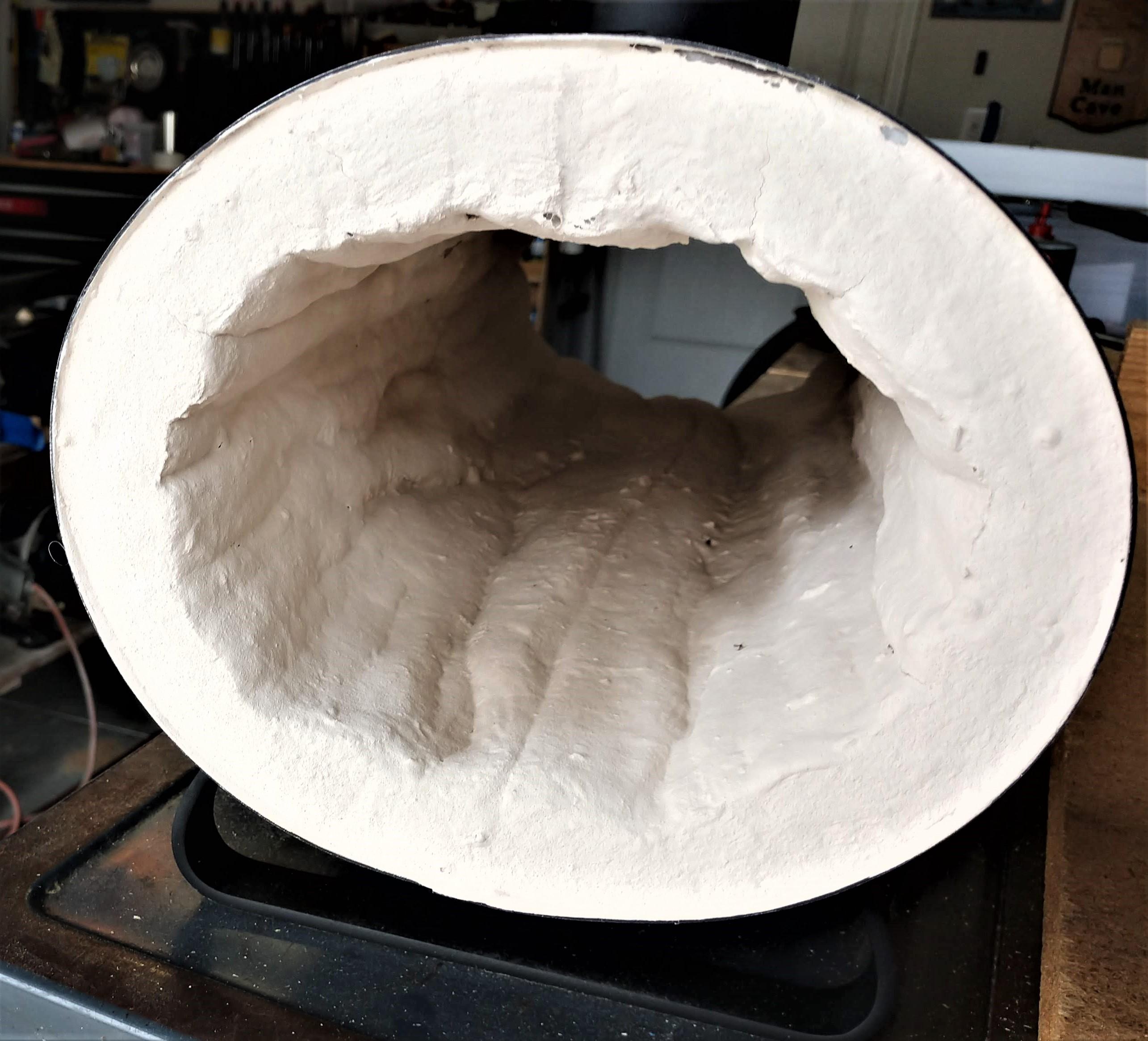

louspinuso Posted February 18, 2019 Author Share Posted February 18, 2019 Mikey, this is the stuff they sent me and it did soak into the wool fibers though I don't know how deeply. Quote Link to comment Share on other sites More sharing options...
louspinuso Posted February 18, 2019 Author Share Posted February 18, 2019 Frosty, just went through that posting and I see that kast-o-lite is made by the same manufacturers as the greenpatch and seems to have quite similar properties with the exception that greenpatch is sold ready to use. Based on the expected temperatures/humidity over the next couple of weeks, I think I'll let it cure for about a week when I put it in my oven cold and start at the lowest setting, which is about 175, and then go an hour at a Time raising the temp up to 500. After that I'll put the burners on and adjust slowly till it appears that vitrification occurs (I suspect I'll see glowing orange on the inside at that point). You guys are full of great info. Thanks so much Quote Link to comment Share on other sites More sharing options...
Frosty Posted February 18, 2019 Share Posted February 18, 2019 I noticed HWI listed Kastolite too but I've seen it listed by other companies like they make it. I don't know who actually makes it HWI may just carry it in bulk. I just don't know. The Greenpatch I used comes in a 55lb. sack as a dry powder, it mixes just like Kastolite at close to the same water%. That leaves me with no experience regarding the Greenpatch you're using so add a large pinch of salt to what I think. Premixed is(or was) typically called "plastic rammable" refractory as it's pre-wet to a plastic consistency. This precludes it being a "Water setting" compound or it'd set in the bucket, the stuff MUST dry instead. Do NOT follow my previous advice for curing it does NOT apply. Not knowing specifics of this product I'd treat it like ceramics, eg. dry thoroughly, Bisque fire then finish fire. About the same process you outline. It's at times like this I'm reminded there are literally thousands of refractory products available, some so similar as to be indistinguishable and others totally different in all aspects. Frosty The Lucky. Quote Link to comment Share on other sites More sharing options...

louspinuso Posted February 19, 2019 Author Share Posted February 19, 2019 Frosty, Good point about the curing. I have been trying to do some more research on this Greepatch 421 ready mix, and the best I could guess is that the moisture in the premix is actually a special type of water glass made of "silicic acid, sodium salt", of which the MDS reports that it contains between 2.5% and 10%. This would explain why it doesn't cure in the bucket (though it might dry out). Additionally, the PDS lists only 0.1% Lime, which doesn't sound like enough to cause much of a curing action, leaving me to believe that what we have here is something that needs to be dried (which is why I suspect they recommend the 100 degree F per hour method) and then fired hot. If I knew I'd have to learn so much chemistry before prepping a forge, I'd spent more time reading about the properties of ceramics and cements, but then I'd be another 2 or so years out before jumping in. Interestingly enough, I first became interested in building a forge/foundry around 2012, shortly after watching an episode of James May's Man Lab where James May melts aluminum in a cheap homemade foundry and casts it into a lemon squeezer. Before that moment, I never thought it was possible to get (useful) metal hot enough to change properties in a home environment. 6 years later I thought I had done enough research to get a premade forge up and running, turns out, I was wrong . I've also attached a photo of the forge I took this morning (Tuesday 2/19) where you can see that the bottom center is still damp. The current humidity is 89% so I'm sure I might just hang an incandescent bulb in there (60 watt in there I think should do) to help finish the drying process. Based on this, I'm guessing I have WEEKS before the Greenpatch is dry enough to bother sticking in the oven. I'll keep you all posted on how it goes. Mikey, I'll go renew my membership to my local library and see what they have on textbooks for ceramics. It's not that I don't think they'll have anything useful, it's just that I don't think I have enough of a background knowledge in ceramics that cracking any of those books would be very helpful. Most likely the soonest I'll be able to check that out will be on Wednesday afternoon. Quote Link to comment Share on other sites More sharing options...

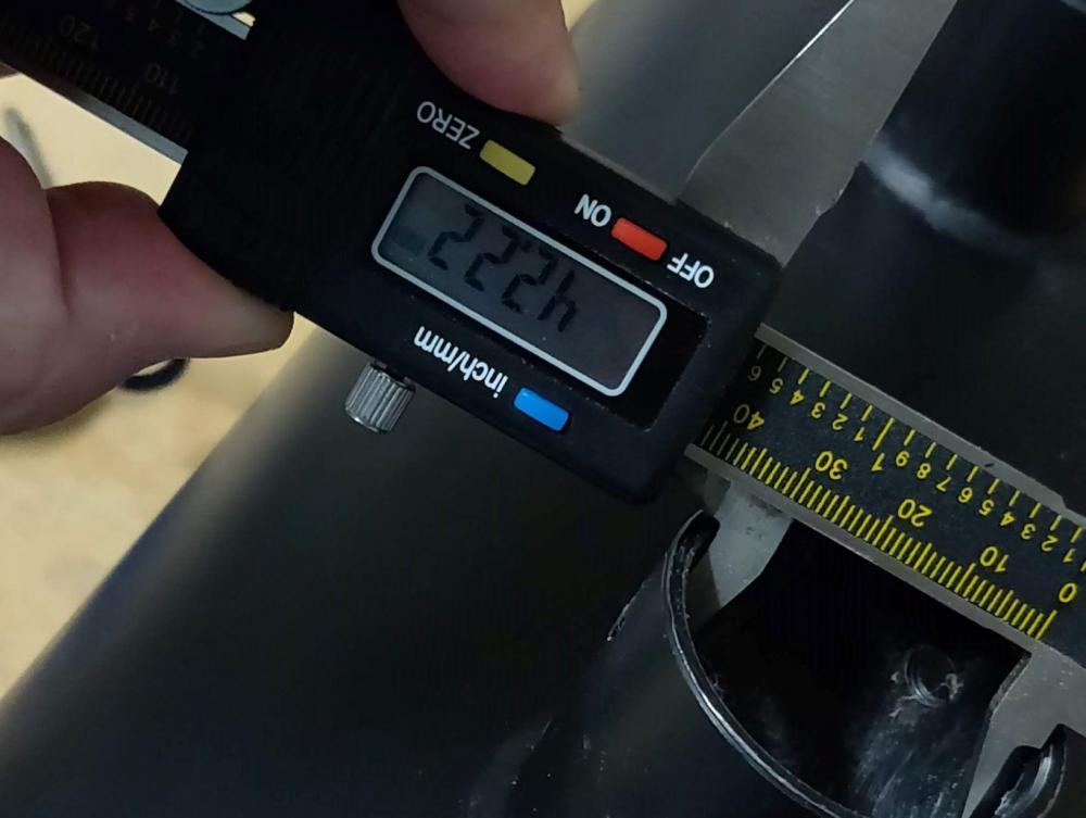

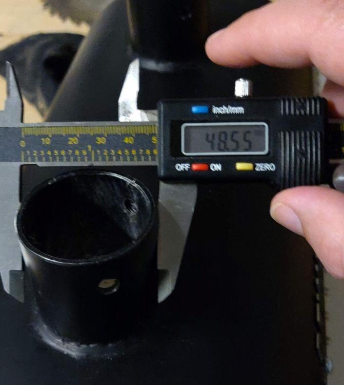

louspinuso Posted February 19, 2019 Author Share Posted February 19, 2019 Eventlessbox In answer to your question about the burner ports, the OD is 48.55mm (or 1.91in) and the ID is 42.22mm (or 1.67in). The depth of the port tube (on the short side on the outside) is 46.15mm (or 1.82in). I didn't get a very good picture of that measurement. I didn't measure the depth on the inside because I'm not sure if you'd want the depth of just the steel, to the end of the KAOwool, or to the IR liner I'll be adding "soon". Warning, these measurements were taken with a cheap caliper. I also took various measurements of the burners as well. Let me know if you're interested in seeing those. Quote Link to comment Share on other sites More sharing options...

Mikey98118 Posted February 20, 2019 Share Posted February 20, 2019 I just saw the second video and it answers a couple of questions. There are three kinds of rigidizer (that I know about). the most common choice is colloidal silica in water (fumed silica is one source for colloidal silica) There are also two kinds of alumina based rigidizer that I have see before (yous makes three): colloidal ($$$), and what I suspect is nothing more than high alumina refractory sans grout (economical). Colloidal alumina can run along refractory fiber by capillary action, just like colloidal silica does. This process leaves a rigid but light blanket with about the same insulation value as before coating. The refractory version is formulated to penetrate ceramic fiber somewhat, and to leave a solid coating on the blanket's surface. How well this will work out, I haven't a clue; but it should provide a rigid surface for your final coating to rest on, to help prevent cracking in the hot-face layer. Quote Link to comment Share on other sites More sharing options...
louspinuso Posted February 20, 2019 Author Share Posted February 20, 2019 Mikey, I'm guessing mine is the economical variety. I touched some of the portions of the encapsulated wool this morning and if I apply pressure I can feel some "spring" under neath it (I feel like I can easily crack this if I press too hard) so I'm hoping that the IR lining I add will help, though I wonder about how it will affect the coating I currently have on the wool. Will the weight cause it to crack? Will the newly introduced moisture help it lock with the current rigidizer or will it cause more of a slippery surface? Just things I'll have to figure out as I go along. The other questions I have is just how thick I should go with this. My initial thought is to set the whole thing upside down (burner ports down) and put a 1/8" to 1/4" (3mm to 6mm) thick layer down and wait for that to at least set mostly. Then build my way up the sides slowly until it's mostly up the walls and flip the whole thing back right side up and apply that last center portion and then place the 2 firebricks that become the floor directly on top of that while still moist, hoping they will act like a sort of reverse keystone to keep things from sliding down. Worst case scenario, I'll just do several thinner skim coat layers allowing it to hold itself up like plaster and just keep smoothing it over as I go. Either way, I'm sure it will be fine. Thanks for all the advice, you guys are really great Quote Link to comment Share on other sites More sharing options...
