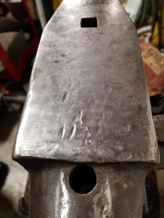

I'll try to update with some photos soon, but here's a few quick thoughts based upon the time I've had with this anvil:
1)  Best I can tell, the anvil face is induction hardened.  I've gotten some dings during use that weren't even mis-strikes, but a file still skates on the raised material.  This would imply that the outer skin is hard, but the substrate is still somewhat ductile.
2)  The Hardy hole on mine is somewhat rectangular in cross-section, but I'd call it a nominal 3/4" square.  One wall actually bulges inward a little bit, so might've been a soft core during casting.  Unfortunately I can't do much to remove the material in there since the material inside the hole is hard xxxxxxxxxxxxxxx.
3)  If well-secured to its stand the anvil quiets down considerably, I highly advise doing this (and well).
4)  I have really enjoyed using the double horn pattern, getting to use one definitely makes this a requirement for a future (larger) anvil acquisition.
5) The smaller size of the anvil does feel a bit limiting when it comes time to work larger cross-section stock.  Not only do you have to take care to not use too big a hammer, the darn thing heats up really fast (to the point of becoming a burn hazard after awhile, so ya gotta stop and cool it down before you get into the tempering region).
6)  The portability is nice, due to my current situation I have to pull the forging gear out of the garage and put it back every time- that'd get to be difficult with a larger anvil and stand (but totally worth it).
7) It can sometimes get a little cramped when using a holddown and doing chisel work, but this could probably be mitigated by me making a smaller holddown.
8) The pritchel hole being in the base of the horn works well for using it for holddowns, but forget about punching slugs out over it- it's likely to distort the work unnecessarily.  The pritchel's a rough 3/4" diameter.
9)  The design of the feet/legs makes it a little harder to do a nicer job of securing it to the stand.  There's a  gap underneath the anvil that was nice to stick hardies or chisel in during work, but that usually gets spanned by the holding hardware since the parts of the feet under the horn and heel have the pass-thru holes for the hardy and pritchel holes.  Additionally, there isn't a nice regular geometry in the legs that makes it easy to keep the hold-down bars in place- the curvature changes (picture required).  Don't put too much stock in this comment, though, as my method of securing it is driven by other requirements (namely, be able to remove/reinstall it from the stand quickly for purposes of travelling/demoing elsewhere).
Here's a picture of the damage sustained these past 6 months, I don't claim to have exceptional hammer control since I don't get to forge very frequently.
A picture with the hold down inserted.
