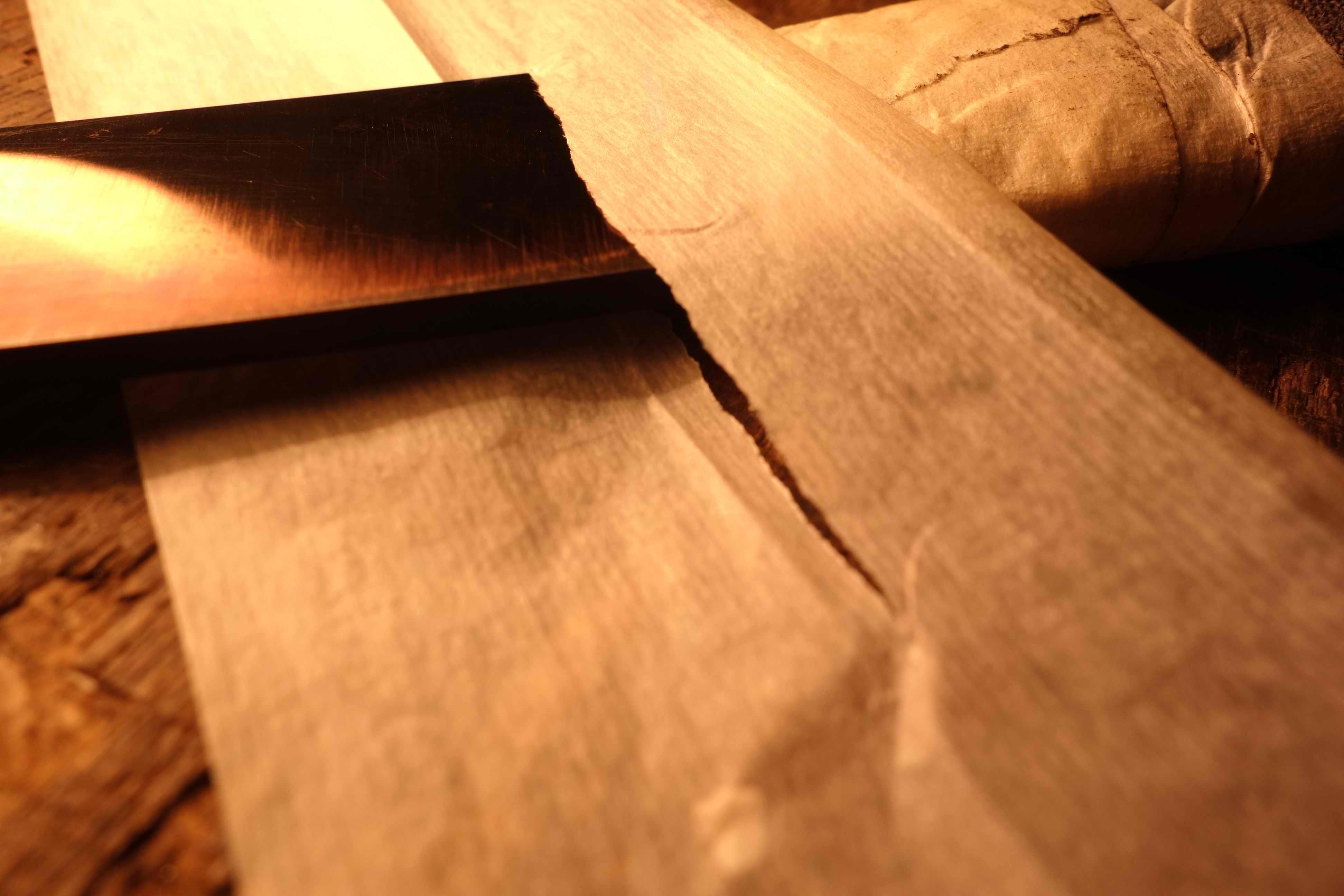

Blades that are meant to cut should be tested with cutting.
Every new born blade I sharpen until it has got even burr.After removing the burr I take extra thin cigarette paper and I look at the cuts if there is tearing at the paper fibres.
It should be possible to cut fine stripes by stripe.You will see, where the burr is not removed completely...there the cut stops.
 I start with gently whittling a piece of giraffe bone.....examine with a magnifying glass the effects, followed by another cut in the paper to check
Followed by whittling ironwood and (sometimes) cutting card board...always checking the effect in the tore of the cigarette paper
after testing the blade still was hair popping, but has a bit tore on the paper.
Blade is made of O7, ground on the edge to 0,3 mm and has about 61HRC +/-1
Cutting bone and hard wood is IMHO much more telling in less time than cutting card board...because with some alloys  You need to cut a lot of card board until You can tell something about wear resistance.....too much time and card board messed all over the shop, You also need a temporary handle option to be able to make at least 100 cuts without hurting your hand
