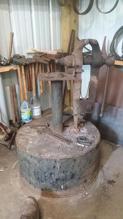

hheneg Posted September 19, 2021 Share Posted September 19, 2021 (edited) I have a peter wright mounted low to use for bending and hammering. I cut off the bottom third of a 55 gallon drum. welded a little angle iron fram to a 3" piece of schedule 40 pipe with a plate welded on top for the vise mounting bracket. then I set a piece off EMT for the vice leg to slide in and poured it full of concrete. weighs more than 400 lbs, but I can grab the vise, tip it and roll around the shop (Im pretty small). But when it sets down it just doesn't move. Been using it that way for more than 30 years. Probably cost me $10 or less to build. Edited September 20, 2021 by Mod44 posts merged. Quote Link to comment Share on other sites More sharing options...
