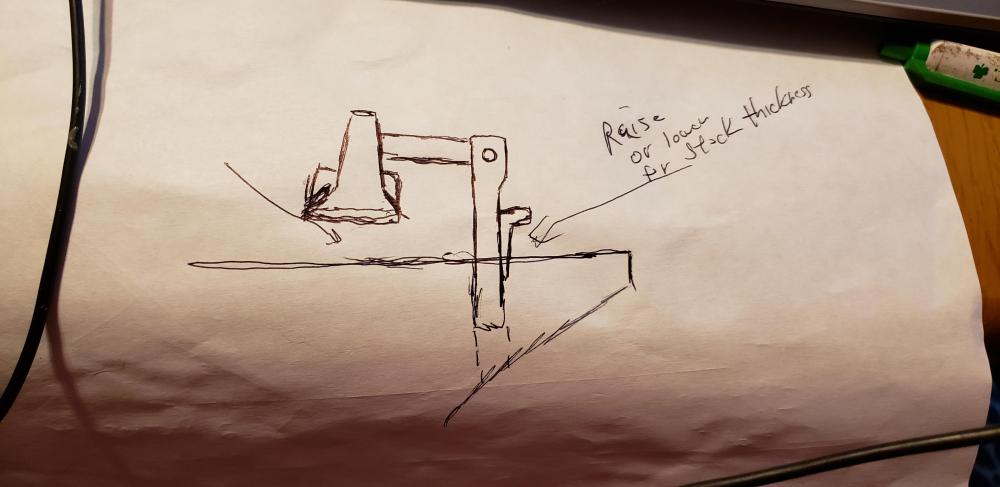

ADHD-forge Posted January 4, 2019 Share Posted January 4, 2019 for my hammer forging project i'm in need for a flatter and i would like to make it myself but i was wondering if going the fabrication way ie welding a 60x60mm 20mm thick plate to a 40mm square bar would sufficient for a flatter. i would make it all out of mild steel seen is this i've got easy access to Quote Link to comment Share on other sites More sharing options...
JHCC Posted January 4, 2019 Share Posted January 4, 2019 It will probably work, but it probably won’t last. As a field expedient, short-term solution, it would probably be more than adequate. Of course, there is nothing half as permanent as a temporary solution. Quote Link to comment Share on other sites More sharing options...

jlpservicesinc Posted January 5, 2019 Share Posted January 5, 2019 I've made flatters from other double faced hammers and have also made flatters from wrought iron with steel faces, mild steel with HC steel faces and solid HC steel.. A flatter used to come in many, sizes and with different radius on the faces.. dead flat to just a degree or two.. Round, retangular, square.. etc, etc.. I have flatters that weigh as little as a about 1.5lbs to about 4lbs .. The key to any top tool is the lighter it is the more potential work is down for a given size hammer... If you are working by yourself a flatter that has a steel shaft affixed to it like a guillotine tools pivot will free up the holding of it, the metal and your hand hammer so you can use the anvil face and the flatter in a controlled method.. This pic will give you the general idea.. The hardie hole shank is the same width as the hardie hole side to side but 3/4 the thickness.. Then a wedge is used to hold it in the correct position.. If you are using the same size material all the time a hole can be drilled at that point and then a pin can be used and the shaft left square, but won't be able to use the wedge with adjustable height.. You can make the arm a long as you want but really should be no shorter than about 6" or 8" long as then the radius of the pin to head gets to short and you will be flatting only 1 side of the stock.. Can work well if you want tapers.. to forge on of these would be about 1 hr or so and then depending on if you have a welder or not you can just weld the head on.. Or make all your top tools eyes the same and then you can run a bolt to tapered shaft.. And to answer you guestion.... Of course you can make the took out of mild steel.. Mild steel is tougher/harder than wrought iron and while the best tools used a medium or high carbon steel face a mild steel flatter will last plenty long enough as it's used on hot metal vs cold.. Quote Link to comment Share on other sites More sharing options...

JHCC Posted January 5, 2019 Share Posted January 5, 2019 The only modification I’d suggest to Jennifer’s “flatter guillotine” would be to make the horizontal arm longer, extending past the vertical post. That way, you can raise the flatter by resting your hammer on the outboard end of the arm. Once your workpiece is in place, lift your hammer, drop down the flatter, and you’re good to go. Quote Link to comment Share on other sites More sharing options...
ThomasPowers Posted January 5, 2019 Share Posted January 5, 2019 My most favorite swing arm fuller has JHCC's enhancement *and* I added a die spring to the mounting bolt so it holds in place when lifted without needing to keep the hammer on the extension. A slight tap and it's in contact and ready for a WHOMP! (technical term in my shop....) Quote Link to comment Share on other sites More sharing options...
jlpservicesinc Posted January 5, 2019 Share Posted January 5, 2019 JHCC this would depend on which side your hardie hole is.. Since I am right handed and my horn/hardie hole is on the right of the anvil face.. No need to have the nib on the end.. Just reach under the arm itself.. If you have the ability to forge what ever you want.. I think this will be the next " How to" video.. I have some time today and was looking for the next series of videos.. I think we have a winner.. Quote Link to comment Share on other sites More sharing options...

anvil Posted January 5, 2019 Share Posted January 5, 2019 A few things about this design to be aware of. First, I'm not an advocate of guillotine tools. This is my preference, not a condemnation. As for jlp's design, I'd make the shaft longer so you could free it with a tap from the bottom. I'm not in favor of wedges in my hardy hole. Its much argued concerning shoulderless hardy tools in general. For me, I use the edges of my hardy hole for many things and wedges tend in a short amount of time to roll and deform these edges. Other than that, the wedge works. The face of the flatter must be parallel with your work. And the face of the tool must be slightly rounded or the slight amount of displaced material will leave unwanted mark's on your work because as soon as you displace material, your surfaces are no longer parallel.The wedge and lack of a shoulder work to prevent this, unless your work is tapered, then it's a no go as you move down the taper. Think a 4 sided tapered spear point type finial. And finally, and my primary reason for not being a fan of guillotine tools in general. Thats the rebound blow made by the tool after you strike and raise your hammer. It tends to leave unwanted mark's on my work. A spring top/bottom design works most of the time to solve these problems. Of course, the ultimate spring type tool is a treadle hammer. Lol, this solves all problems I've pointed out. As a final note I use very few top and bottom combo tools. Those I use either fit my treadle hammer, or are spring operated. I've come up with a few creative ways of secure my iron to my anvil, leaving me two hands for two tools. Quote Link to comment Share on other sites More sharing options...
Sly Posted January 5, 2019 Share Posted January 5, 2019 If I was going with a guillotine flatter personally I would just make a 3 inch wide guillotine tool like a fuller guillotine, thats alot of expensive steel though. Quote Link to comment Share on other sites More sharing options...

ianinsa Posted January 6, 2019 Share Posted January 6, 2019 my input here would be if you intend to use a hammer of sorts as a top tool it would be smart to anneal the "struk " side . Quote Link to comment Share on other sites More sharing options...
anvil Posted January 6, 2019 Share Posted January 6, 2019 Or at least make sure its temper is softer than your hammer. Quote Link to comment Share on other sites More sharing options...
