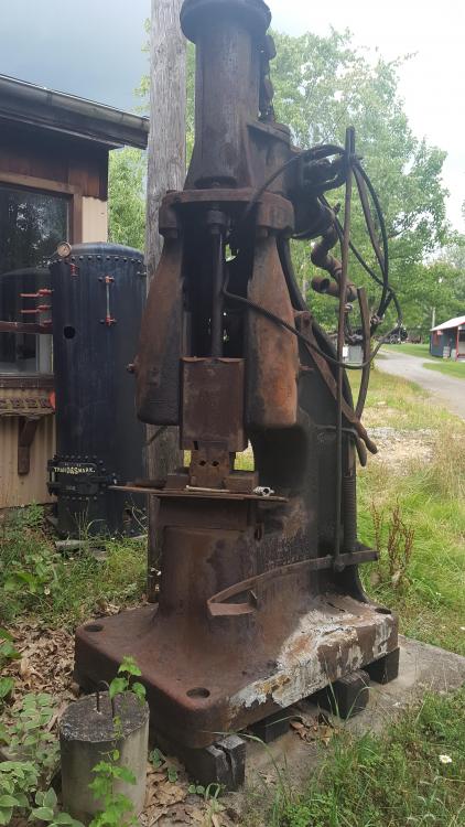

Sharp tungsten Posted January 1, 2019 Author Share Posted January 1, 2019 Honestly I can handle anything up to a 1000 pounds or so. I may go bigger if it's the right hammer. I would love an a frame but they tend to be over 3000 pound class usually. I'm looking to exhibit these hammers for the general public to use and enjoy. Kind of a working museum type deal. Here is the 500 Chambersburg L model for your viewing pleasure. It's in original condition from the day it came from American Bridge. It's been sitting outside but it's all there. I call her sturdy Gurty. Link to comment Share on other sites More sharing options...
