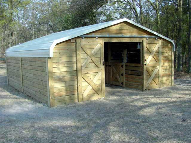

Carport come horse barn. If you order a snow load rated car port with taller legs you can use 4’ wide faced steel building insulation and the taller legs are needed for full swings with a hand or sledge hammer. PT fence panels make cheep siding, especially if salvaged (most fences are not installed with ground contact rated 4x4s. If you use fence panels and insulation some kind of barrier film will be needed.
Thank you for that pic. That looks awesome. I think a rock storefront facade would really make that look neat. I’ve been looking at pricing and they go up quick once you get beyond the normal everyday dimensions. I’m thinking a few courses of block under a standard carport might do. Then close it in with wood like the one above.
