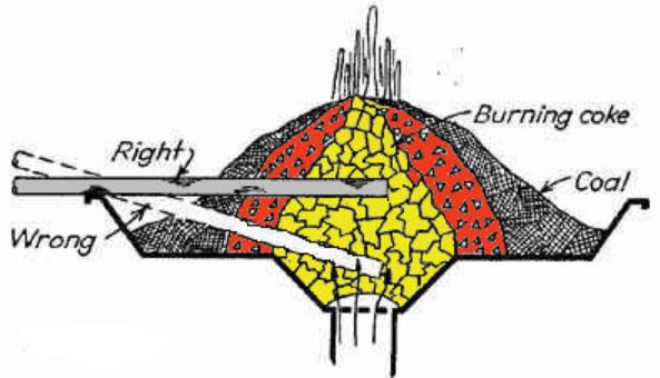

Your fire is not large enough or deep enough in my opinion.  Make a 4-6 inch tall piece of light metal 22 ga to 11 ga and add it to the top of the forge in the shape of a (  ). This will add depth to the fire and allow you to pass metal through and across the fire. You want a fire ball about the size of a melon or larger, with more fuel on top of that being coked up. The metal should go in about 1/2 to 2/3 of the way up the fireball.
Fuel does not make the fire hot, air makes the fire hot. Use only the amount of air you need to get the heat you want.
