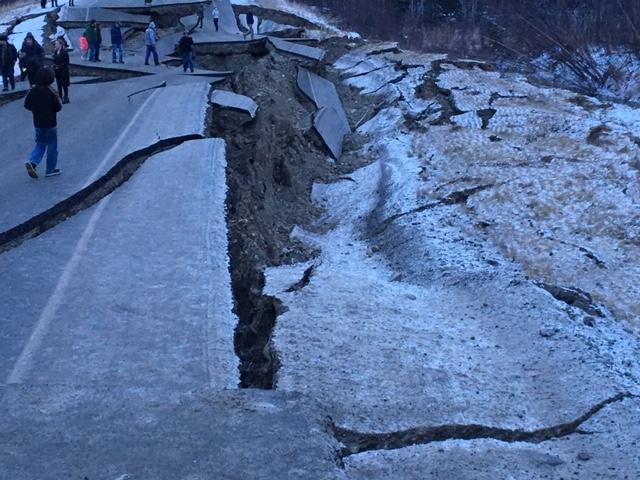

Here's a vibratory finish for you. This is the other end of Vine Rd. and a classic example of why this construction technique is sooooo bad. The ground is recent lakustrine, a lake that eventually filled with dead plants growing on dead plants and trapped dust until it's just a wet gooey piece of ground. Rather than sub-excavating to bearing layer and filling with appropriate material the new and "improved technique is to lay geotextile and start filling till it stops settling for a given period of time. Then they build! Woo HOO it works great till you shake it.
Note the road fill settled straight down, shearing the buttressing fill on either side. The helo videos on TV show the waves beautifully, like a fat boy stomped a cow pie. About what I think of the construction technique. The first pic is facing S. our house is on the far ridge where the head light shows in the gap in the trees. The fill section failure is a vertical bluff, below to the left you can see the wave form and another farther out. The light angle was bad or you'd be able to see details like which way the trees are leaning and such.
Pic 2 is from the same vantage point angled farther left showing the ground waves more clearly, the alder is pointing perpendicular to the ground.
Pic 3 is the other side of the road and shows the vertical subsidence of the fill section and the frozen ground wave forms, the tag alder to the right is a good example of how vegetation allows you to interpret ground movement even from a distance.
In all the pics you can see the center of the grade failure is more crumbled as opposed to the vertical failures near the edges. This is the result of the return wave same as dropping something in water, the wave rebounds and forms a peak in the center before falling back down.
I googled but couldn't find the helo videos being shown on TV though they're being shown on cable news, Vine road is a pretty dramatic failure.
No word about the occupant(s?) in the car but from the damage I doubt they were injured beyond needing a change of undies. The drop off between where I'm standing and the fellow walking near the car is about 4-5' The people walking around are looky loos, only one guy in a vest might, MIGHT be someone with any business being down there.

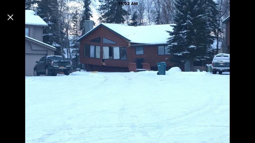

The inbound Glenn highway and what used to be a 2 story house. Miraculously I have not heard of any fatalities or serious injuries.  There must have been some unknown issues with those poor peoples house. The minimal damage to residential housing is a testament to modern building engineering.
YES! That's the view, see the wave pattern in the soft (not so long ago pond) ground!
I can't see enough of the failure on the Glenn but a lot of that part of the highway is fill over marginal subsoils. I don't see any wave forms so it may have just been a straight up sluff.
It looks like the house settled it appears the front door is a little lower than the walkway to it. That's going to cost to repair and nobody up here can afford quake insurance. Paying the premium for about 3-4 years would equal replacement cost of the house. Better to bank the payments and build a nicer place every 10 years or so.

If you look close you can see the double garage door under the big windows. I think the stairs used to up to the front door.

Oooh, evidently the house took more damage than it seemed at first glance at the pic. From split level to smooshed level in 37 seconds. OUCH!
