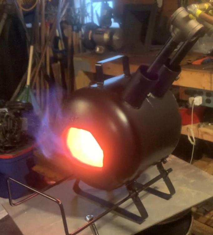

Yanni Rockitz Posted December 3, 2021 Share Posted December 3, 2021 On 11/15/2018 at 2:24 PM, Mikey98118 said: There are few things in life that are as easy as buying and using fumed silica Man -- the old saying goes something like, "If there's a 50/50 chance of getting it right, I'll get it WRONG every time." I read about the gas forge lining for dozens of hours on here -- reading more, repeatedly, over a couple of years, as I slowly evolved my thoughts on building one. It's like Google -- there's TOO much information and a lot of it is focused on specific processes that only give you part of the story. I've only found an actual procedure two, maybe three times -- all a little different. They're similar, but often with different products for different 'layers' and some have changed over time. The ceramic blankets are pretty straight forward, but the refractories -- Mizzou vs. Kast-O-Lite 30 vs. Satanite, etc. -- have different arguments. Then, the final IR reflective coating seems to be the most mysterious bit to get a consensus on. I thought I'd arrived at a solid understanding about a year ago for two 1" layers of ceramic wool fiber blanket, rigidized -- each, in turn -- then two 1/4" layers of Satanite -- each air dried then progressively cooked in to cure, then ITC-100 for a final IR reflector, so I ordered all that. Now I've found people saying ITC-100 gets 'chalky' (so... don't use it?) When I rigidized the ceramic blanket, I found that my fumed silica "202" doesn't mix in with the water in the spray bottle at ALL -- like HATES water -- floats on top. I kept shaking it vigorously, as suggested here on IFI, spraying it on, but eventually clogged up the sprayer. It doesn't say on it anywhere whether it's hydrophobic (or hydrophilic) -- just that it's a thickener often used in epoxies. Urgh. It was well covered by the time it clogged, so I set it for several days by the wood stove in hopes some of the silica got mixed in, but now that it's dry, it's not even the slightest bit rigid -- still feels like out-of-the-box, soft, puffy ceramic wool blanket -- it's just blue, now. Apparently zero silica made it through -- only blue water. More reading, now I find this, above, noting hdrophilic (mixes with water) vs. hydroPHOBIC fumed silica. 50/50, so I got it wrong. Clearly, I got the hydrophobic stuff. It certainly doesn't dissolve in water, no matter what level of foul language I apply to it. I just bit the bullet and ordered some Inns-Tuff rigidizer, as I've read a few of our heroes have used with good results. $16 for a quart seems reasonable. For future re-linings, does anyone know where to get the water-friendly hydroPHILIC fumed silica for a good price? Link to comment Share on other sites More sharing options...
Frosty Posted December 3, 2021 Share Posted December 3, 2021 9 minutes ago, Yanni Rockitz said: Man -- the old saying goes something like, "If there's a 50/50 chance of getting it right, I'll get it WRONG every time." Oh COME ON Yanni, NOBODY is perfect! If you still have some of that fumed silica, try adding a LITTLE "Jet Dry" dishwasher rinse air. It's a wetting solution, it breaks down the surface tension that prevents many hydrophobic materials from getting wet. Also you need to heat the silica rigidizer to red heat to fuse the ceramic blanket fiber intersections together and stiffen it up. I bought hydrophilic fumed silica at a local plastics supply and contractor. I described what I was doing and the guy at the counter told me I had the wrong stuff and got a different can. Neither said philic or phobic on the label and neither cost enough to be worth mentioning. $8/lb meant a pint can cost more in repackaging and labeling than the silica. I'm with you on how confusing it can be reading Iforge posts even being broken down into sections and subsections. Products, techniques and information evolve. For example Mizzou is still a high end castable refractory but other products have come to our attention that have properties that are superior. Kast-o-lite-30 for example is high alumina making it much more resistant to borax based welding fluxes. Another advantage is it being a "bubble" refractory, evacuated silica spherules replace some of the aggregate, they offer increased insulation and decrease the physical weight. Yeah, ITC-100 has become a legacy kiln wash for propane forges but it just doesn't work very well. Plistex 900 fires hard like a ceramic glaze and is very high alumina. The stuff laughs at molten borax fluxes. BUT it doesn't contain ANY zirconia so we don't enjoy that layer of IR re-radiance. Zirconia containing kiln washes like ITC-100 do NOT reflect IR, they absorb energy because they aren't good conductors then they Radiate it in the direction with the least resistance. Seeing as the product is painted to a thicker refractory the easier direction to radiate IR is back into the forge. Not all of the heat but enough to be worth it. A couple fellows here have experimented with things to make refractories and kiln washes, myself included. I'll make another attempt if I make another forge, not for the sake of experimenting though. Marten in the Netherlands IIRC was getting some excellent results with 97% zirconium silicate and 3% Bentone, a type of bentonite clay. Plistex is an easy to get kiln wash and works a treat, don't let a bunch of talky tinkerers muddy the waters for you. Eh? Hopefully this is more help than added confusion. If I raised ore questions or you need clarification give a shout I'll try to clarify in a less rambly manner. Frosty The Lucky. Link to comment Share on other sites More sharing options...

Yanni Rockitz Posted February 9, 2022 Share Posted February 9, 2022 Ha! How did I miss all your replies for two full months!?! The whole gang chimed in. :-) IronDragon -- I'm stealing that one. Columbus! lol Mikey - SO true, right?! The secret is to apply your 50/50 chance (i.e., 100% guarantee of initial failure) to challenges that you actually enjoy -- then the mistakes end up appreciated as stripes earned in the trenches and finding the right answers, at last, is a rich reward. (I wish I knew that when I was 20!) Everything I've really enjoyed in life has been either luck, accident, or elective -- and the mistakes and errors were often the most valuable learning bits. No one MADE me build my boy that tree house, but I loved every minute of it and learned a ton in the process. He could care less about it now, but I still gaze at it appreciatively and now and again climb up there just to survey my little kingdom. Frosty -- your reply is greatly appreciated! I've read a bunch of that in other posts you've provided along these hallowed halls -- and it's helpful to hear it synthesized again with new insights. I have a day job as an IT guy and I'm constantly grumbling about how every problem I have to research suffers from way too much info out there in Web land -- usually dancing all around the specific issue I'm trying to understand, but rarely answering it directly. One ends up with a skill at gathering loads of ancillary data on the general subject, identifying common issues and solutions and making a best guess at the case in point. So it has been with understanding forge design. IFI is one of the special places where the "too much info" thing doesn't actually annoy me -- quite the opposite -- I always learn something valuable along the way. I just turned 51 and I'm really starting to understand that nothing good comes in a hurry. The ITC idea was all the latest/best knowledge at the time... I thought I had that final IR flame-face coating thing sorted out, but now I realize I probably found ITC at least three or four years ago (time flies) and I just hadn't seen Plistex 900 mentioned in the interim, despite many hours invested. I finished my propane forge in January with ITC 100 over a couple layers of Satanite, over (sides and bottom) of KastOLite 30, over two 1" layers of rigidized 2800F blanket. I slightly overbuilt it with two Frosty T-burners and she's a right RIPPA -- seriously high temps -- she'll burn steel... but I can't help wondering if Plistex would've let me attain the same result with lower pressures... From the sounds of it, the ITC will eventually wear off, so I'll re-coat with Plistex when that time comes. I took loads of time -- like weeks -- to air dry, then gradually flame cure every layer, starting with the rigidizer, and that patient approach really paid off. Thanks for the good advice! My next forge build will be so much easier. Here's an early picture of the new forge -- when it was still flame-curing the final layers. I need to coat a few fire bricks to block up the front and back openings a bit for quicker heats... and a gratuitous fish pic -- because who doesn't love a big bass. Link to comment Share on other sites More sharing options...
Irondragon Forge ClayWorks Posted February 10, 2022 Share Posted February 10, 2022 Nice forge and bass you have a right to brag about both. Link to comment Share on other sites More sharing options...
