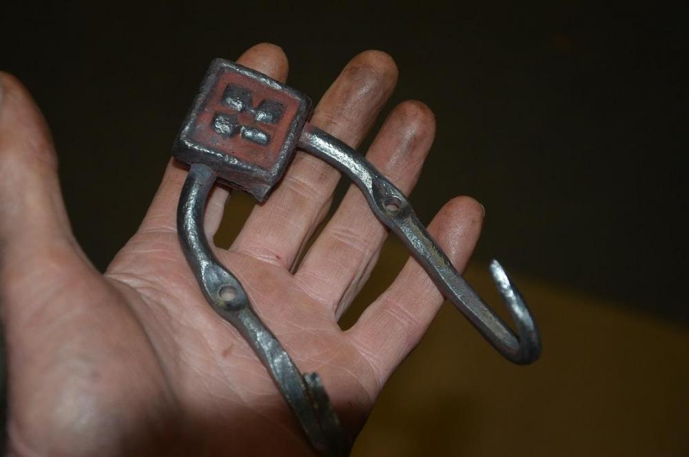

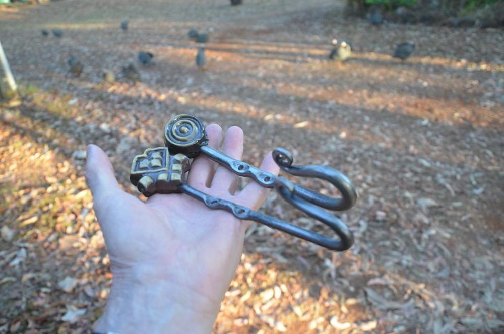

Well, I did manage to wrangle the wrought enough to make a couple of usable hooks. I'm not sure I even like them, but it used up some stuff that was otherwise scrap. Perhaps a whole bunch of them with different patterns in the cast would look OK on the wall. Relics of the Victorian era.
I just kept it really hot, almost sparking, and hammered very gently with a light hammer. Scrolled the tip quickly before the tongs took out the heat. And one point was a little raggedy so I cheated and filed it back
