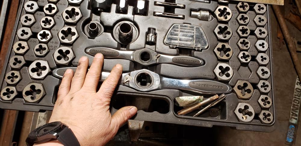

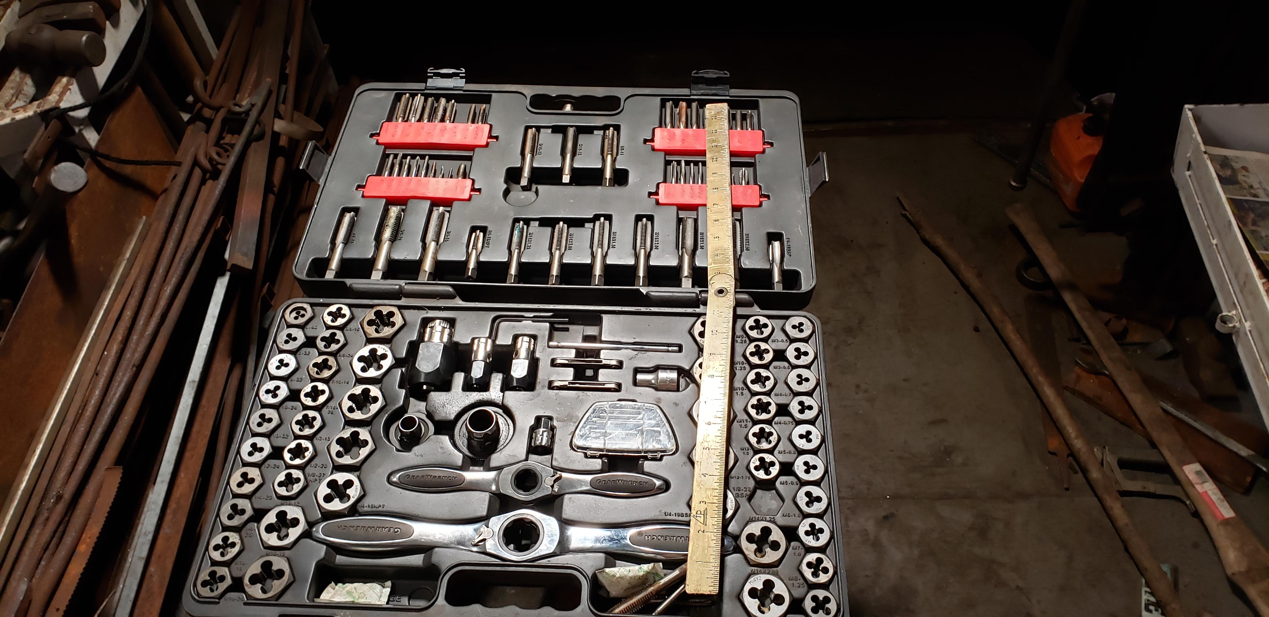

jlpservicesinc Posted December 20, 2018 Share Posted December 20, 2018 here is a vintage ratcheting handle that was originally used for an auger bit.. It works great for taping and is all ready setup to hold square shanks.. Here is how big the Gear wrench set is.. Quote Link to comment Share on other sites More sharing options...
