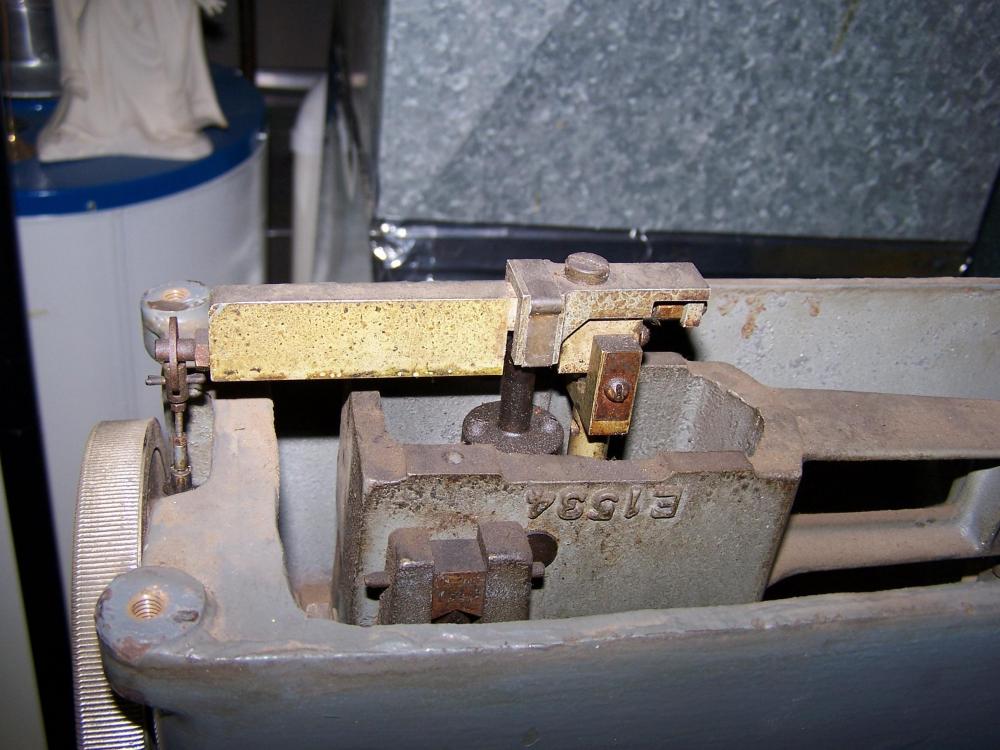

Yes, I have a Rockwell tester that I bought cheaply off of a local buy and sell website. It is an old machine that was owned by the Canadian Government and it consistently reads about 3 points low according to my test disk. It is not suitable for a machine shop but it is close enough for smithing.
Hi Kuzuzu,
I hate to admit it but I have not tried to recalibrate my machine because I have no idea which thingy to turn. It reads close enough for me. When I use it twice a year, all I do is subtract 3 from the reading. It measures consistently but slightly off. If anybody knows which thingy to move to adjust it, that would be great.

Heatwave machining you have to do a calibration before every measurement. You will find that the pad with the readings rotates, i do not know your machine but you will find a way.
The procedure is simple. You take a calibrated test piece of steel that you know that has a specific hrc number. You make a measurement with your machine and as it is engaged you rotate the plate with the numbers to correct the reading. Now you are ready to go.
You do that every time you want to measure.
All this for the possibility that your tool works like mine. But that may not be the case.
