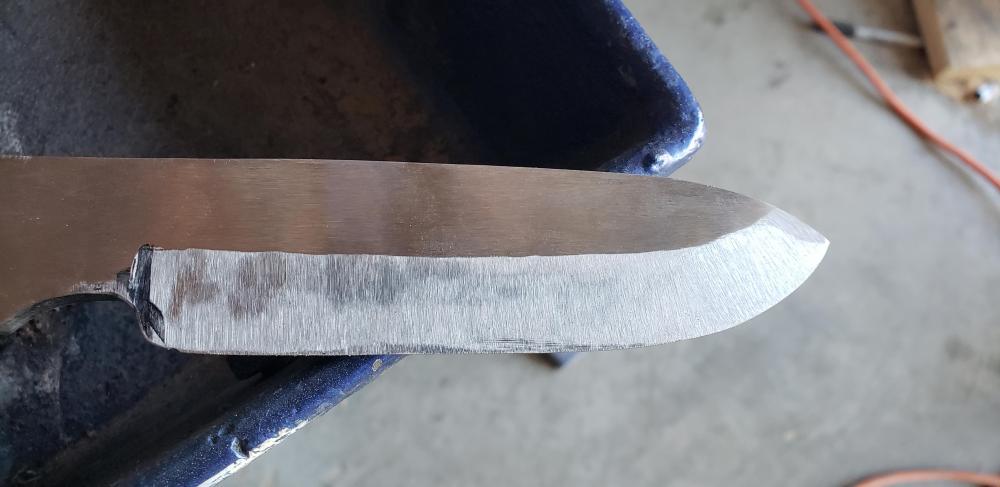

Conrad.blacksmithing Posted October 2, 2018 Share Posted October 2, 2018 Ok, this is my first post I became a member because I am new to smithing and need some tips. I'm 14 and I just bought a 3"x 60" belt sander with a grinding wheel and made a diy jig for grinding bevels on knives. I also just forged my first knife out of spring steel and did a hollow grind for the bevel because it was kind of thick. Well, the platform on my sander to put the jig on does not go down to the wheel for doing hollow grinds. I attached some pictures. Does anybody have any tips on how to do hollow grinds freehand. Because I ended up with waves in my bevel and looks kind of bad. (If the sander pictures are confusing the arm tilts back for the wheel to be exposed.) Also if you have any tips on charcoal forges please feel free and riveting tongs. Thanks :) Link to comment Share on other sites More sharing options...
Lou L Posted October 3, 2018 Share Posted October 3, 2018 I appreciate your attention to detail. It belies your age. In my opinion, that is a really nice first try for a free hand grind on a wheel. It’s a skill many don’t even bother trying to learn. You can touch that line up with a hand file to get it straight OR just try a few light passes on the wheel again. Keep your hands in a comfortable but sturdy position on the knife, keep your elbows locked in by your side to limit arm movement, and keep your feet shoulder width apart and square to the grinder. Apply the knife gently to the belt so you can feel the bevel “fit” into place and then use your legs to slowly shift your body ever so slightly to make the blade move across the belt. I found that, when I used my arms, it always went crooked on me. So let your whole body be “locked” onto the knife and shift slowly side ways. Also, make sure you aren’t using too aggressive of a grit. It is nearly impossible to get a straight line with 36 grit. 80 is tough. If you already heat treated then watch the temperature of the blade. Dunk it in water each pass. If not, then be sure not to grind the knife edge too thin before heat treat. The only way to get those lines straight is to do it a bunch of times. Each knife you make will get better and better so just enjoy the process. Lou Link to comment Share on other sites More sharing options...

Foundryman Posted October 3, 2018 Share Posted October 3, 2018 That grind line isn't terrible, you could easily clean it up with hand sanding, just use your belt grinder to grind yourself a sanding block the same radius as your contact wheel and go at it, you'll tidy everything up in no time. Link to comment Share on other sites More sharing options...

John in Oly, WA Posted October 3, 2018 Share Posted October 3, 2018 If it were me, I'd make an attachment to mount on the sander that put a tool rest right in front of the lower wheel, then I could steady the blade while doing the hollow grind bevels. Another thing I did was make several blade shapes out of mild (read "cheap") steel and practiced with those. I just found freehand hollow grinds without a tool rest were too difficult for me to get as clean a grind as I wanted. Thomas is talking about the heating for hardening process, not the quenching part. You heat it inside a pipe that is sitting in your forge fire to get a more uniform, controlled heating of your blade. Link to comment Share on other sites More sharing options...

Conrad.blacksmithing Posted October 3, 2018 Author Share Posted October 3, 2018 Ok, thanks that is really good to know. Thanks for the advice. Also thank you Lou L for the grinding technique you told me about I retried it just now and am really impressed with the results of the grind line. I do think I got the edge a little too thin so I hope it doesn't warp or get cracks. Link to comment Share on other sites More sharing options...

Daswulf Posted October 3, 2018 Share Posted October 3, 2018 Metaldrms, you would benefit greatly by making a plunge line jig. Look them up, very simple to make. Link to comment Share on other sites More sharing options...
