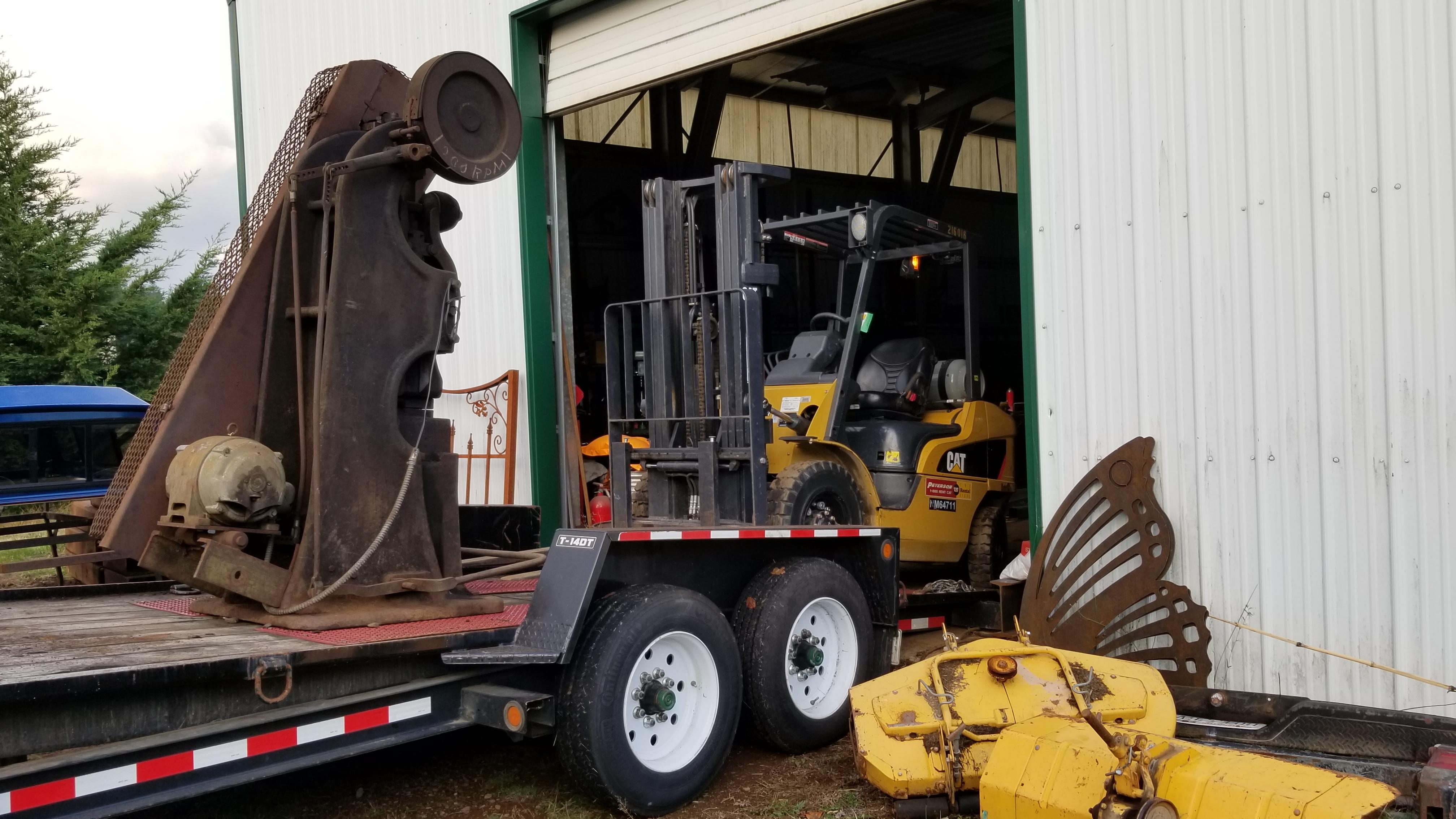

Any Idea of the Make on this Hammer?
Edit: just found the thread on the 200 lb Howe posted in April
I offered $1000 and it was accepted but I know it’s worth more.  What about the rubber? How would a guy replace that? Replace the motor with what a single phase 10 horse? That’s the biggest single phase I’ve seen. I’ve never run any machinery on a phase converter either. Wouldn’t it be doggy?
Thanks for the info. I’ve done Onnamental iron on the side for 20 years and want to step up my game from crap like this and go from a cut out guy to smithing.
Man, what a cool hammer. For the Rubber, I would run it and see what it does. If it seems to be cracking or not flexing right, I would replace them. Since they look like biscuits you have it pretty easy. First, buy a Shore A scale measurement tool off the south american river vendor, and take a knife and peel back the crusty outer layer until you see good rubber. You might get results between 65-95A. Best to measure in a few spots.  Then contact a industrial supply house for Rubber or Urethane rod in the Shore hardness you need and the diameter. Cut them to length and/or drill the center hole and install. If they end up having rounded ends, you can turn them in a lathe under the right conditions.
As for power, how much single phase power is going into your shop? Like Thomas said, is there a possibility of adding 3 phase? If not, I would not hesitate to use a phase convertor.  When you think "doggy" in phase convertor terms a lot of folks are thinking of the old "buzz box" style static phase convertors which are nothing like a modern rotary phase convertor. If you plan on running any three phase equipment in the future (compressor, mill, lathe, more hammers ect..), I would contact American Rotary or someone like them and see what options they have for you.  Also, compared to a 10 HP single phase motor the 3 phase/rotary setup will be a lot more energy efficient. Also, make friends with a good electrician who has done commercial work.

So i bought it and brought it home. heavy enough to make the 5k forklift barely steerable. Now to figure out power and learn enough to really use it. Thanks for the advice, when the opportunity arises sometimes you need to stretch your comfort zone. It'll be awhile before I get it running, got to find a south american river vendor, but I have gaswizard's post to reference. Thanks again for the info.

That's a great hammer!  I did a fair amount of work under a friend's 100# Howe... good control and brake system.  For a 150# mechanical a 7.5 hp single phase motor should work just fine... I have a 7.5 hp 3 phase motor on my 300# Beaudry and that works fine too.  I bet you could get away with a 5 hp single phase motor on that, with a starter.
If you can get three-phase power installed for a reasonable fee, that would be my first choice, as Thomas suggested, but as Morgan mentioned, a rotary converter is a good option if you can't get 3-phase power into your shop.
I built a rotary phase converter to run the three-phase motors on my my vertical mill, lathe, and a couple of other pieces of equipment. I bought a kit that included the start and run capacitors, relays, contactor, connectors, terminal blocks, etc., and bought a new idler motor to work with the kit. That was over ten years ago, and I can't remember all the specs, but it did save some money as compared to a ready-made rotary converter. It's heavy, probably about 275 pounds, so I mounted it on a dedicated hand truck to move it around.
Or, as Salem mentioned, you could probably switch to a single-phase drive motor for the hammer, but they are less efficient, and you'd have to make sure that it's fully compatible with the equipment.
If you decide to use a single-phase motor, or a three-phase rotary converter kit, or a ready-made three-phase rotary converter, be sure to contact the manufacturer before ordering it and provide full information on your entire setup and how the motor (or converter) will be used, so that you end up with something that works perfectly with your equipment. They will almost certainly have a number of questions for you.
By the way, is there a readable data plate on the existing motor, and do you know if it is the original motor?
