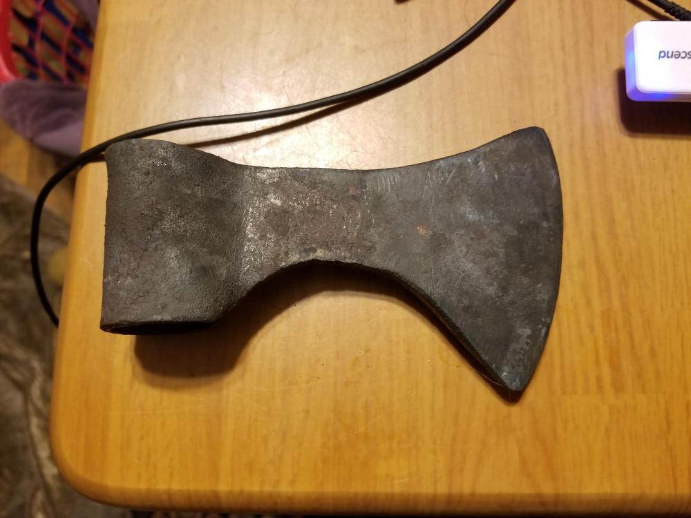

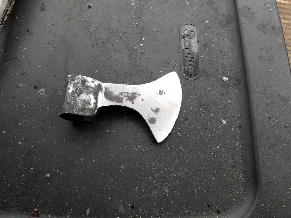

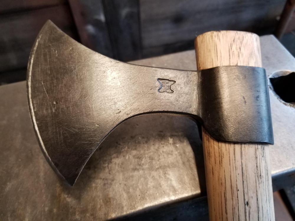

I started this Sunday at a demo at an outdoor event called the Big Moe.  Mass outdoor exposition.. http://fawnsexpo.com/

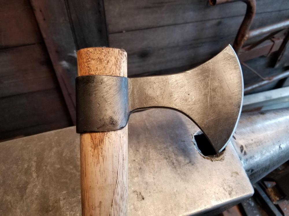

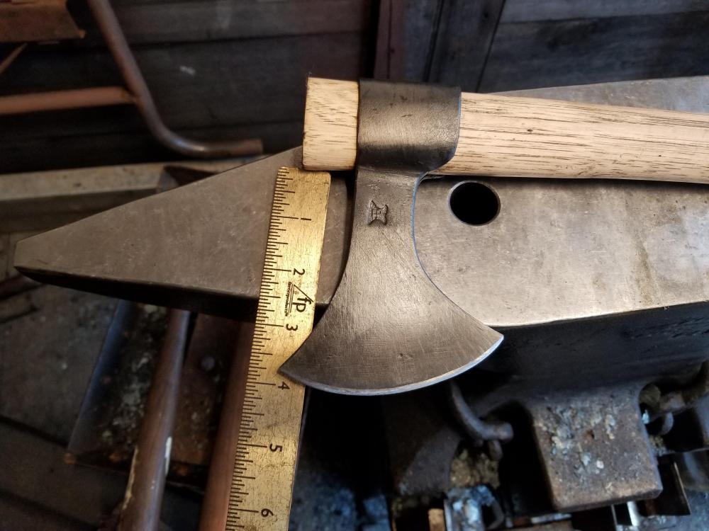

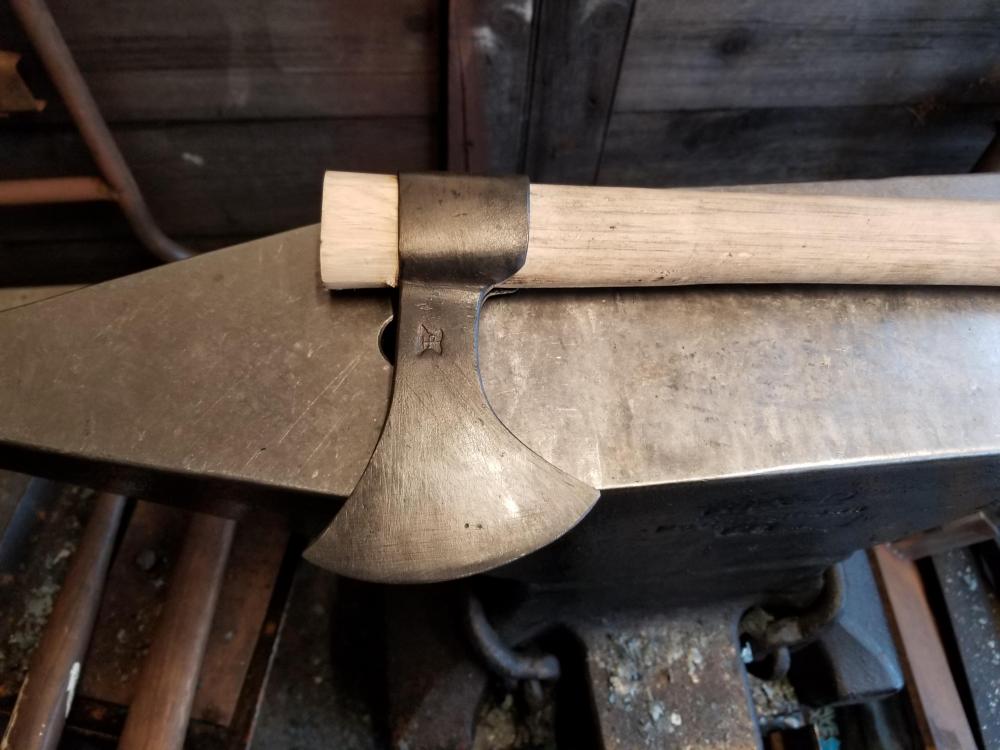

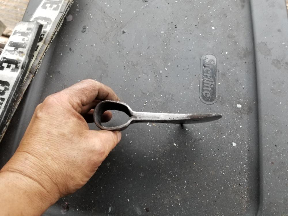

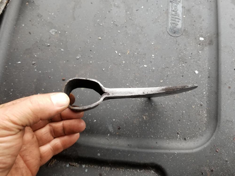

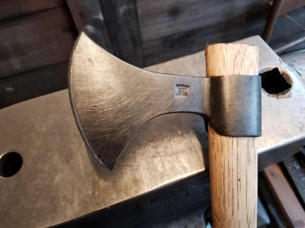

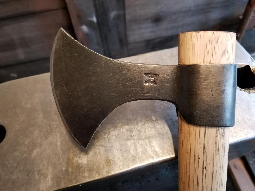

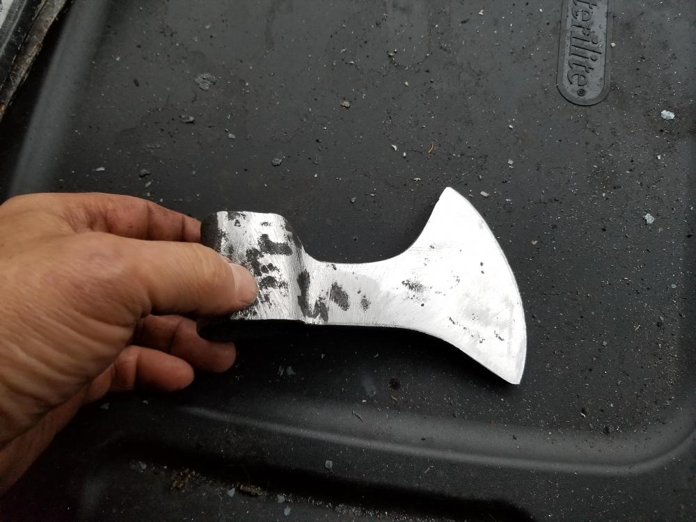

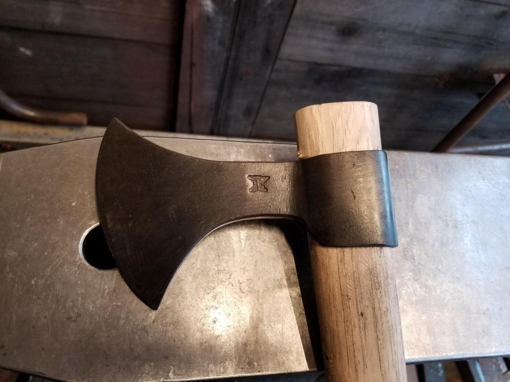

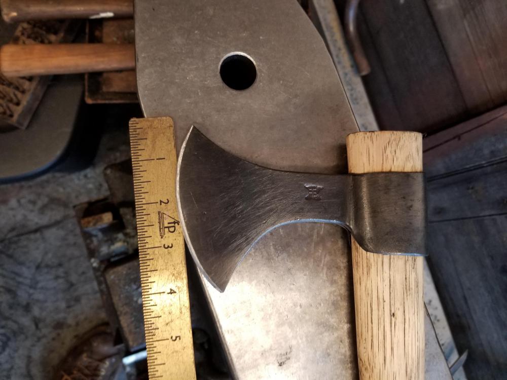

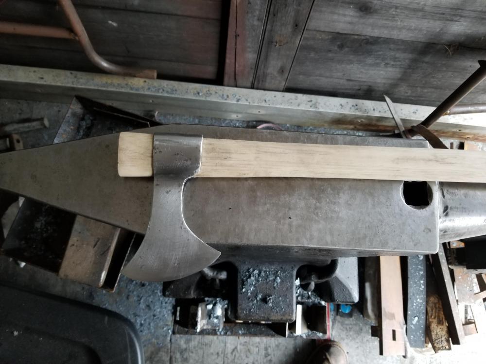

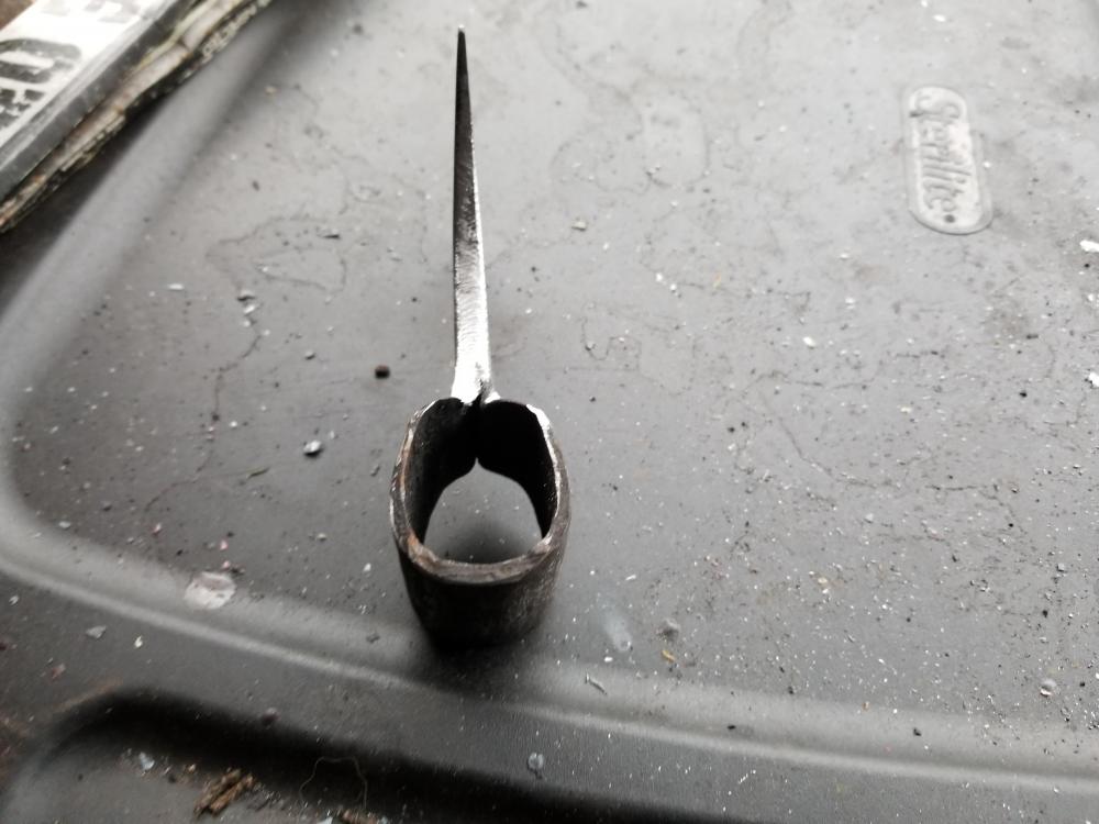

It was a great place to setup and demo..   This started as 1/4X1.5"X8" and then added into it a 5160 insert..  Just over a 1lbs..
What should have taken 45minutes to forge took 8hrs as there was just so much conversation vs forging..

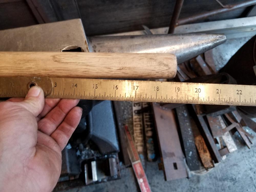

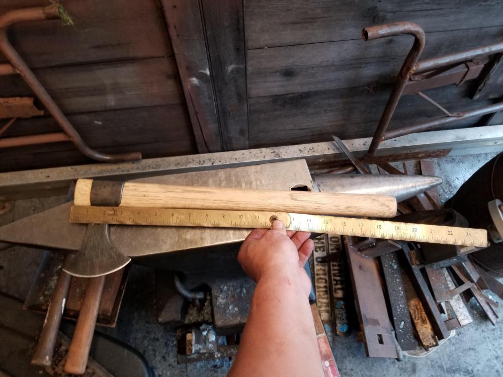

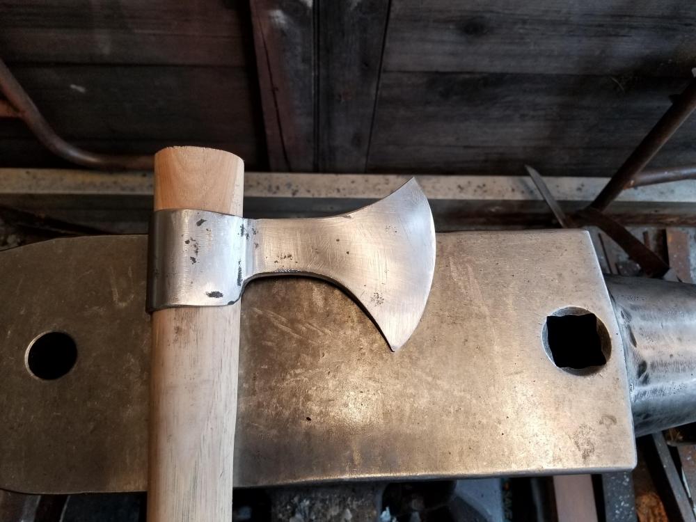

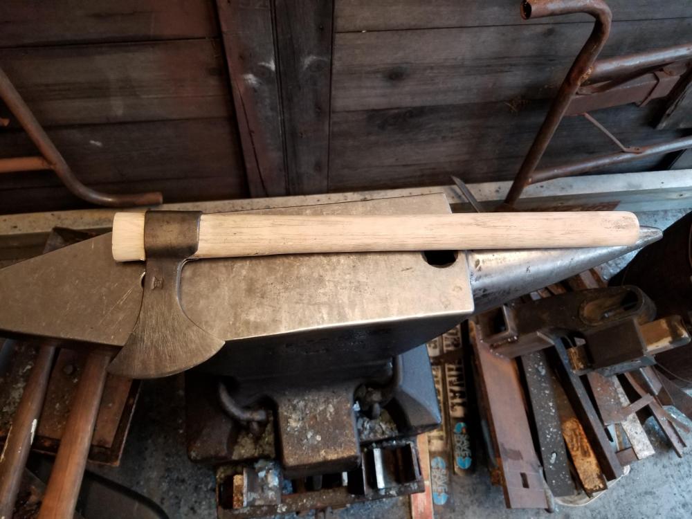

The handle was supplied at a normal catalog place.. Can't tell you where because I bought it from a friend.. 20180923_192337.thumb.jpg.51fa0391777623376461b9351959cf6e.jpg20180924_171201.thumb.jpg.8e603223829c2fe4cab227ee82c8559d.jpg20180924_172951.thumb.jpg.8dfd9bda336447960ab753cb42ed2bdd.jpg20180924_172955.thumb.jpg.6834e3a4766acfa9eae2af2871c61b25.jpg
