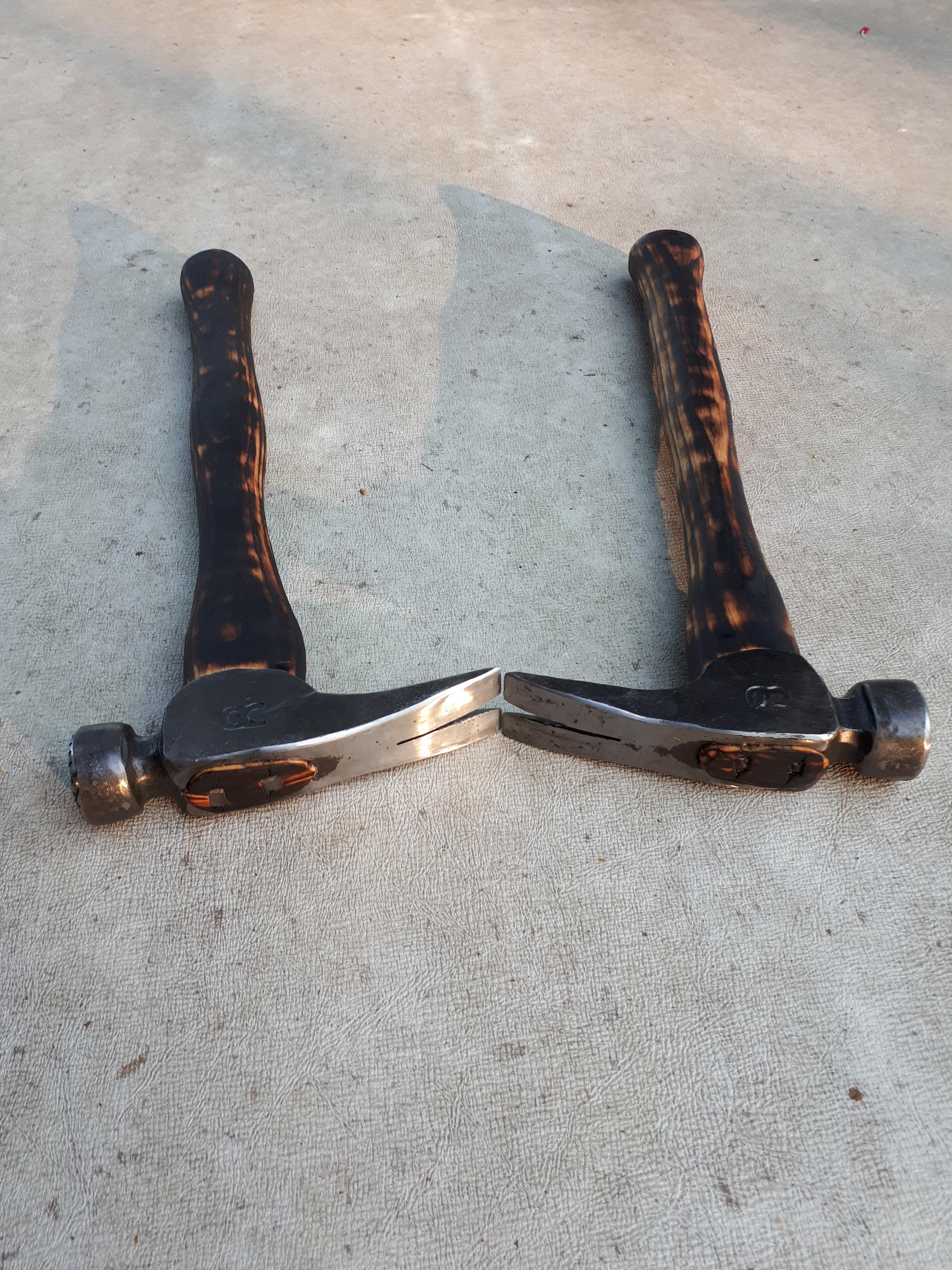

Looks like a Vaughan style. My day job is as a Carpenter, and one thing I've been thinking of making is some framing hammers.  They look good, the main thing with wood handled framing hammers is to have a large eye, thats a weak point. The only thing I see wrong with them is maybe taper the nail pulling side a little more consistently there are big nails and small, if its a gradual taper it'll fit them all. Also I'm curious how you hardened and tempered them, also what steel?
Thanks for the feedback. I'm happy to get feedback from carpenters!! I see what you mean about the slot for the nails. I'll try to fix that in the future.
I used 1045 steel. So I quenched in water and then stuck a heated drift through the eye of the hammer to do the tempering.
Have you tried hitting it on something relatively hard? Just to see if it wants to shatter? I know my favourite hammer as of the last ten years or so is a 22oz Estwing, I had a Vaughan California Framer that looked a lot like your hammers. My experience with the Estwing is that they tend to err on the tough side. Meaning that the head deforms over time and the nail pulling end tends to wallow out after a while, but they don't break. Seems like there is a fine line in there. I have a book around here that tells the preferred temper color of a hammer head, just gotta find it.
It’s tough to say what the proper temper color is for a hammer because steels vary so much even from batch to batch. I personally err a little on the softer side because I’d rather not worry about the liability of a sliver going into someone’s eye. Plus, the claws need to be a little softer and springier that the face so they aren’t snapped off.
I haven't done any real tough tests. The tempering colour obviously depends on the kind of steel as well. I figure for 1045, being a medium carbon steel you wouldn't want to temper it to soft. Just get the brittleness out of the eye and the areas next to it. But I'd definitely rather have the claws bend than have them snap.

I really like the hammer head and the handle shapes but I hate the handle finish. Either burn it or don’t, as it is it looks like it will give you leprosy when you go to hammer a nail.
Good point! Personal preference I guess... I hadn't really thought of it before.  I guess they are a little blotchy.
I don't know about the bending rather than the snap thing, I've snapped the claws off of a 4' nail pulling bar and if the texture of the break was anything to judge the temper was near perfect and hard as glass or nearly anyway. You sacrifice wear on the claws for toughness. And as for temper colors I straw temper most of my knives, sometimes deep straw. And the choppers hold well and sharpen decently. And the axes that I've made in 1060 and 5160 that I tempered straw chop through cinder block alright, though the 5160 tends to be much more durable.

You’re exactly right, it personal preference. If you fully burn the handles, as they are used they’ll develope their own patina as the burnt wood wears through to the unburnt. Same as an oiled handle will darken in spots from handling. You made some mighty nice looking hammers but to me the handles don’t do the hammer heads justice. If you’re happy, stick to your guns and I’ll keep my yap shut.

Interesting. I think what I should do is let a carpenter use some of the hammers I've made, and get him to test them on a real job site. I'd like to make them to sell, but I do want them to be worth buying.

Like the hammer, I agree that the finish on the handle needs work - I don't mind a burnt finish but that seems overkill.  I think I'd prefer just a stained handle of some kind, or just bare.

Really nice looking hammers JD, I loved my framer.  I'm not a pro by a long shot but I built our house with it. I believe if you're going to sell hammers you really need to pay attention to the steel and heat treat, you might run into liability issues. Maybe.
The slot in the claw of mine is sharp on the inside edges, it didn't need to come against the head to grip and pull a nail. Ufortunately I haven't been able to find mine since before the accident so I can't say what make it is and I'm afraid it grew legs. <sigh>

What are your suggestions as far as steel? Is 1045 a good choice for framing hammers. I like it because its fairly simple to heat treat with a coal forge, nothing to fancy about it.
