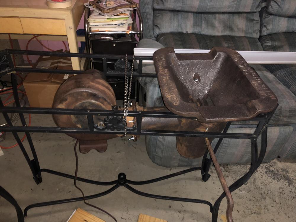

Pr3ssure Posted September 12, 2018 Share Posted September 12, 2018 So I need to build a nice permanent table to place my forge in. I have access to basically an unlimited supply for angle iron in the form of bed frames. I was thinking about using that as the frame. Would that be sufficient? Also the firepot has the front and back pieces lower than the sides, so I need to think about how to to make it support all sides. I’m also not sure about thickness of the table too. Would a thick gage steel work or should I just go with quarter inch or bigger? i already know about dimensions and all that that I’ll need just not so much the materials to use to make it. Of all the things I’ve read online and in books nothing really covered making a nice table. Edit: And as for what a budget is, I do have one but not so much as I want it done right the first time. I’m not trying to go all out with some giant brick setup but I want a nice solid table that will last, if it means paying a little more I can wait an extra week or two. I’ve been acquiring my setup for a little over a year. Just thought I’d add that. Link to comment Share on other sites More sharing options...
Frosty Posted September 12, 2018 Share Posted September 12, 2018 Unless you're going to be forging really heavy things there is no, ZERO need for a heavy table bet, 1/4" is giant overkill! My large forge table is 48" x 48" (New guy overkill, way too large) and is 14 ga. with a couple pieces of angle iron across the bottom to stiffen it. The legs and frame are 2" angle iron and the rim around the table is flange up to form a rim. Nothing fancy, 4 legs, spreader half way to the ground and a couple hips, pieces at a 45* angle from table to leg. The 14 ga is plenty strong, I covered it in fire brick leaving two out around the air grate for the fire. Like I said overkill across the board. It's WAY too large and the fire brick is completely unnecessary, an inch of packed clay would've worked as well. It's the first coal forge I made, full of ideas I had before I knew anything about coal forges. We all do that kind of thing so don't be upset of someone says an idea won't work or isn't worth the effort. I have LOTS of aren't worth the trouble things around you know. Frosty The Lucky. Link to comment Share on other sites More sharing options...

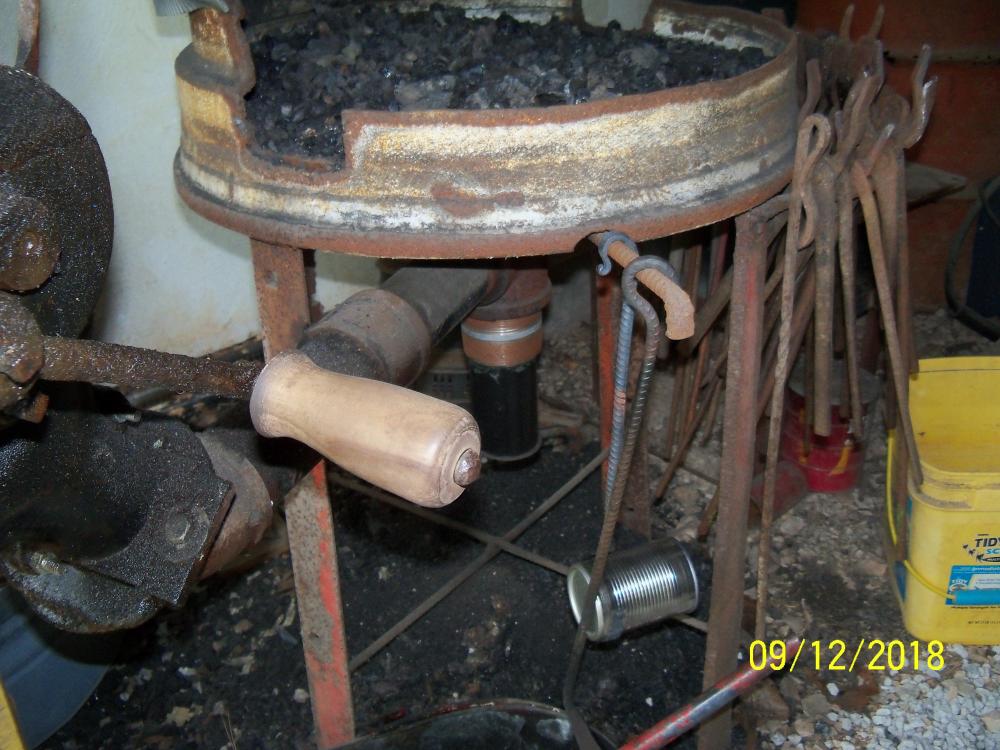

Irondragon Forge ClayWorks Posted September 12, 2018 Share Posted September 12, 2018 Talk about overkill for legs. When I built my forge in '84 I had an abundance of used grader blades the city gave me. I split the blade length wise and welded the sections to a 26 inch semi-truck rim cut down. The hearth table is a cast iron manhole cover ring that fit perfectly. The tuyere & piping is 3 inch black pipe. It takes 3 men and a boy to move it but it doesn't weeble-wobble at all. and will be around when I'm long gone. Link to comment Share on other sites More sharing options...
Pr3ssure Posted September 13, 2018 Author Share Posted September 13, 2018 Alright, so 14 gage is sufficient then? That’s my main concern. Just didn’t know how thick to make it. Regardless it will have a frame supporting the firepot but I wouldn’t want it earring or burning. I didn’t figure it would though with thin sheet even. Thanks. Update: I need to get some pipe or flex pipe because that blower adds a lot of weight but it’s basically ready. I just need to cover the hole on the bottom of tuyere. Thinking about just using foil tape so I can make sure that their is enough air to get the metal hot. But I suspect there is. So excited Link to comment Share on other sites More sharing options...

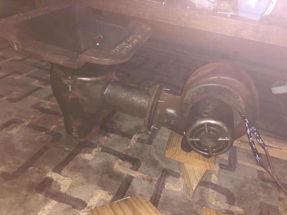

Jim Coke Posted September 13, 2018 Share Posted September 13, 2018 Greetings Pr3ssure, I think you will find your blower has tooo much air .. I would suggest a rhostat to control the speed. You could put some coal in it on a brick support and give it a try. I do not see the clinker breaker. The ones for that fire pot that I have seen have a boss that slides up in the airway. Forge on and make beautiful things Jim Link to comment Share on other sites More sharing options...
Pr3ssure Posted September 13, 2018 Author Share Posted September 13, 2018 It has the twist plate on the side luckily so I can close and open the air intake on it. But I would like to get a rheostat eventually. I forgot to pick up a light switch to wire to it, but I might have one around here somewhere. Would a light switch that’s a twist dimmer work as one? I actually just put it up on this crappy table I had lying around, so I can at least try and start a fire in the morning. It might work temporarily. Will need to reinforce it sideways though so it doesn’t fall. Maybe just tie it down like a tent or something. Link to comment Share on other sites More sharing options...
Jim Coke Posted September 13, 2018 Share Posted September 13, 2018 Greetings P3ressure. One of my forges has the same basic set up I use a simple wall switch and a rheostat so I can control the speed and an off and on switch.. Good luck on the first fire.. Forge on and make beautiful things Jim Link to comment Share on other sites More sharing options...

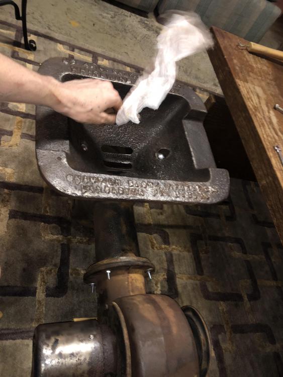

Pr3ssure Posted September 13, 2018 Author Share Posted September 13, 2018 Yeah, i'm super excited. I've been downstairs just looking and thinking. I hope I can fall asleep here soon. Otherwise I'm just gonna be up until 7am and start the fire then. I just don't like that I don't have any space around the firepot to make coke while the fire burns. I think I can make it work though. I'll take one my my steel plates and cover the rest of the table so I can at least have one side. Thanks for the encouragement Jim and everyone else. This site has been my main resource from, I think blacksmithing is cool to I really want to try that, to I would love to do that for a living. Then realizing that's going to take several years of dedication and work. Although, I have yet to find something else that's sparked my interest this much other than driving and professional driving is far out of my price bracket to get into. Even if I can't make money from it eventually I believe I've at least found a life long hobby. Link to comment Share on other sites More sharing options...

Frosty Posted September 13, 2018 Share Posted September 13, 2018 6 hours ago, Irondragon Forge & Clay said: Talk about overkill for legs. Holy Moly, you win the overkill award of the evening, IDF&C! I have a short piece of grader edge I brought home with the intention of brazing it to an ASO someone just left with me years ago. I had to move the thing last weekend as it was in the way of burying the electric supply to the shop. Cursed it again, it's brutally heavy. I can NOT imagine making legs from the stuff or is it there to keep the shop from blowing away in a tornado? 11 minutes ago, Pr3ssure said: Alright, so 14 gage is sufficient then? It should be more than enough with a little cross bracing. I'd just turn the blower over so it's hanging down rather than up and mount it attached. Can we get a look at the other side of the blower? There's a good chance it has screw holes in place to mount a choke plate so you can throttle the air blast. Counter to intuition blocking either the intake or outlet of a blower reduces the work the motor has to do to turn it so it'll run cooler. That one is also intended to draw air through the motor so it can't overheat. I have one of those old cast iron blowers and they are heavy but not too much with a hanger. Once you have it in place just run a strap down to one of the bolts or a screw hole in the blower housing and rivet it to the bottom of the table top. If it shakes while you're managing the fire or pieces install a second strap to a different location on the table, just drill and pop rivet it or use a sheet metal screw and you won't have to worry about removing clay or bricks on it. Frosty The Lucky. Link to comment Share on other sites More sharing options...
Kozzy Posted September 13, 2018 Share Posted September 13, 2018 There are some technical reasons* that the typical light dimmer or similar set-up is not the best choice to do speed control on a motor, especially an old motor. Lean toward using a choke plate or gate instead. You'll likely be surprised how little the opening needs to be to get proper air. On my similarly sized unit, the proper air is with about a 1/8" gap. Anything more tends to be too much air flow. * Most use a triac (or a pair of SCRs) which triggers in such a way that you don't get a nice sinusoidal waveform on the voltage output--you get a partial waveform with the SCR clipping the voltage harshly and abruptly. That's part of what causes the buzzing one often hears when they are used as dimmers. That can potentially cause eventual breakdown of the insulation on the motor windings and likely some over-heating of the motor at lower speeds. Some people have no problems for years or ever, some fry the motor quickly. Since that unit looks to have a motor that you can't easily replace off the shelf, it might be best not to risk it. Link to comment Share on other sites More sharing options...
Pr3ssure Posted September 13, 2018 Author Share Posted September 13, 2018 16 hours ago, Frosty said: Can we get a look at the other side of the blower? There's a good chance it has screw holes in place to mount a choke plate there are two holes on either side of the blower, I figured that's what they were for. I don't think they are centered though, a little towards the bottom. I will take a picture when I get home though. 16 hours ago, Kozzy said: There are some technical reasons* that the typical light dimmer or similar set-up is not the best choice to do speed control on a motor, especially an old motor. Lean toward using a choke plate or gate instead. Yeah, it seems with it just barely cracked it get's a lot of air to it. I'd say I will want a choke plate for better control because it does seem like a fine line between enough and too much. Link to comment Share on other sites More sharing options...

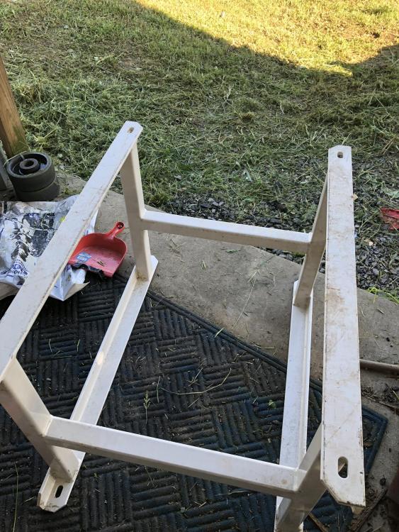

Pr3ssure Posted September 15, 2018 Author Share Posted September 15, 2018 So earlier today I was getting some marble tiles off my neighbor and I had asked him about a piece of steel he had that was a little under a quarter inch thick or so, he said I could have it. I continued on about how now I just need to build the table and I’d be pretty well set. So he says meet me by the basement door and he shows me this. On it’s side it’s right about knuckle height, I have some wheels that my dad found in a dumpster at a factory beside his work. Their like 6 inch dumpster wheels basically. I’d like to put bearings in them and set them up on this table and it would be perfect height I think. Either way it’s just what I wanted. Maybe a little small but plenty big to say the least. I didn’t measure but I’d say the way it is it’s about 30 inches wide by 42 or so inches long at around 30 high. The plate he gave me is plenty big to cover it all and he’s even going to help me cut the hole out with his torch set tomorrow. Turns out my neighbor is a great guy. (Fairly new neighbor) I’ve never had neighbors here before, there used to be a golf course but it closed and they moved in. Link to comment Share on other sites More sharing options...
