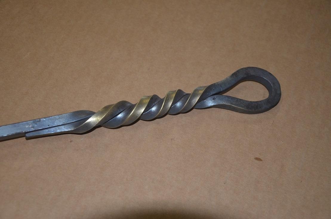

John B Posted November 9, 2018 Share Posted November 9, 2018 Thanks for all the comments, don't get much time to do bits now I am afraid, bit out of practice. 6 hours ago, ausfire said: I'm struggling to see how you managed the twist in the loop handle poker. It's good because it gives more width to the handle. I'm guessing that you tapered the end and bent the steel against itself. You held the lower end in the vice, while twisting with a bar through the loop??? If that's 10mm square bar, it would have to be very hot to achieve the twist. Pray do tell. Exactly as you describe. You can see the punch marks I use to align the bar when it is bent back on itself. Bar was marked out at 6" from end and another 6" beyond, Tapered the end , bent the bar back onto itselfto form a loop, aligned the marks and then closed loop between the vise jaws. Heated up the portion to be twisted, then chilled the loop in the water bucket to "freeze" it, Then held it in the vise at an appropriate length with the two bars at 90 degrees to the vise jaws as opposed to holding them side by side within the jaws (as this tend to allow slippage between the bars) Slipped a round bar into the loop and quickly gave it one and a half twists. and straightened it. This feels comfy in the hand, you can put more twists in, and another alternative is to then beat it down along the length making the grip diameter smaller and altering the appearance of the twist too. Quote Link to comment Share on other sites More sharing options...
ausfire Posted November 11, 2018 Share Posted November 11, 2018 Thanks for the detailed description. It certainly gives an attractive twist. I'll give that a try, but I think maybe 8mm square for the first shot. Quote Link to comment Share on other sites More sharing options...
ausfire Posted November 13, 2018 Share Posted November 13, 2018 On 11/10/2018 at 3:48 AM, John B said: Exactly as you describe. You can see the punch marks I use to align the bar when it is bent back on itself. I had a try using 10mm square bar. I used your punch marks idea and I did get them level. Quite pleased with the result. I thought twisting 10mm bar around itself would be harder than it was. Maybe another half twist or so would have been OK. Another variation for poker handles. Thanks, John. Quote Link to comment Share on other sites More sharing options...
John B Posted November 13, 2018 Share Posted November 13, 2018 7 hours ago, ausfire said: I had a try using 10mm square bar. I used your punch marks idea and I did get them level. Quite pleased with the result. I thought twisting 10mm bar around itself would be harder than it was. Maybe another half twist or so would have been OK. Another variation for poker handles. Thanks, John. Looks good, Another half twist , or more are other variations, but I find the one and a half turns are comfortable on the hand. Punch marks are the traditional way of marking key points when forging as they are visible when meatal is at forging heat. Tend to disappear at welding heat, so other methods required then if accurate location needed. Quote Link to comment Share on other sites More sharing options...

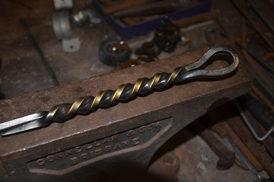

ausfire Posted November 25, 2018 Share Posted November 25, 2018 Tried another John B twist today. This one is 8mm square bar and was a bit easier to twist than the 10mm. I have not shown the side with the alignment punch marks because they didn't line up this time. Nevertheless, I am happy with it. I do a lot of pokers and usually make a leaf wrap handle, but this method is good for getting a wider and more comfortable handle. I thank John for the guidelines on forging these. Quote Link to comment Share on other sites More sharing options...

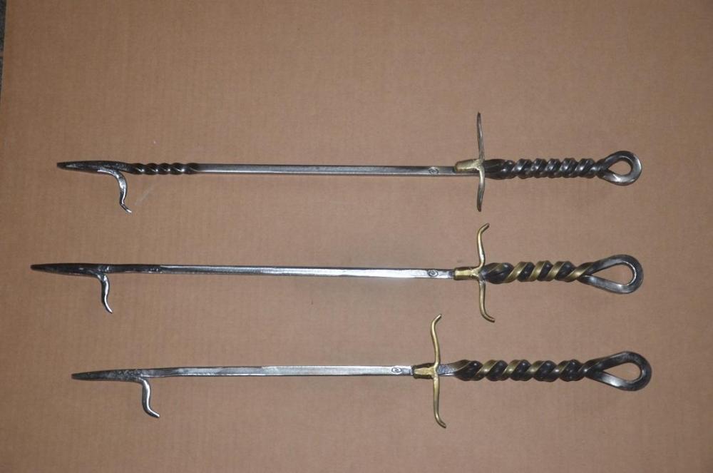

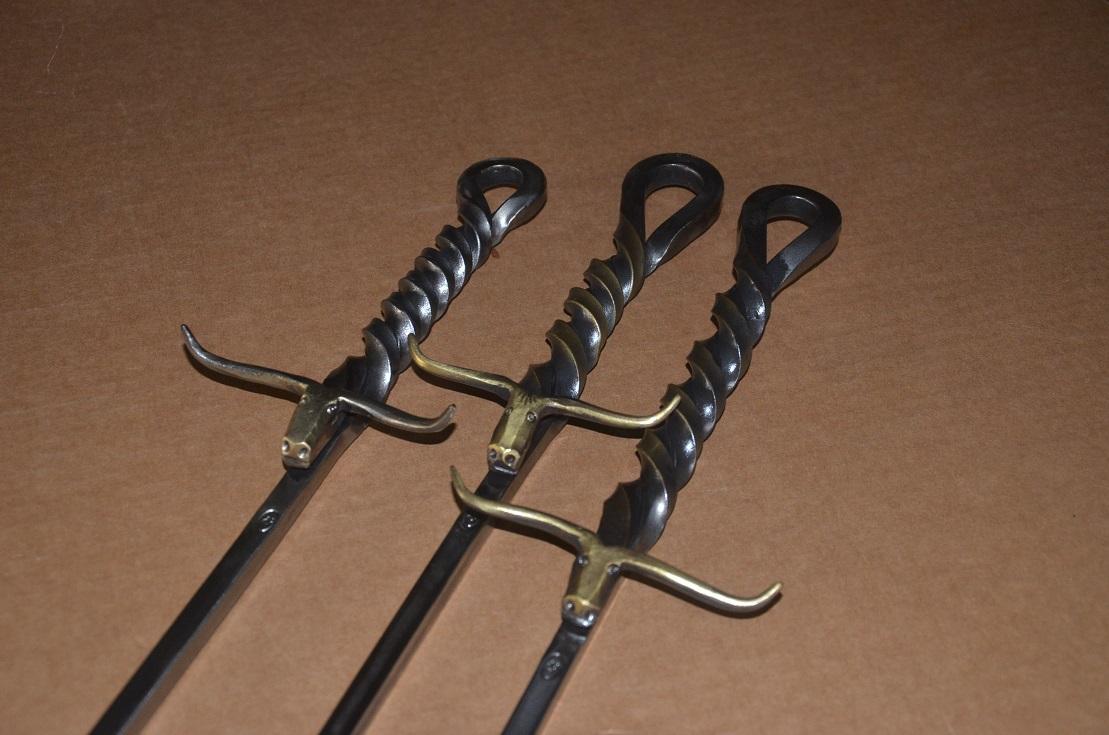

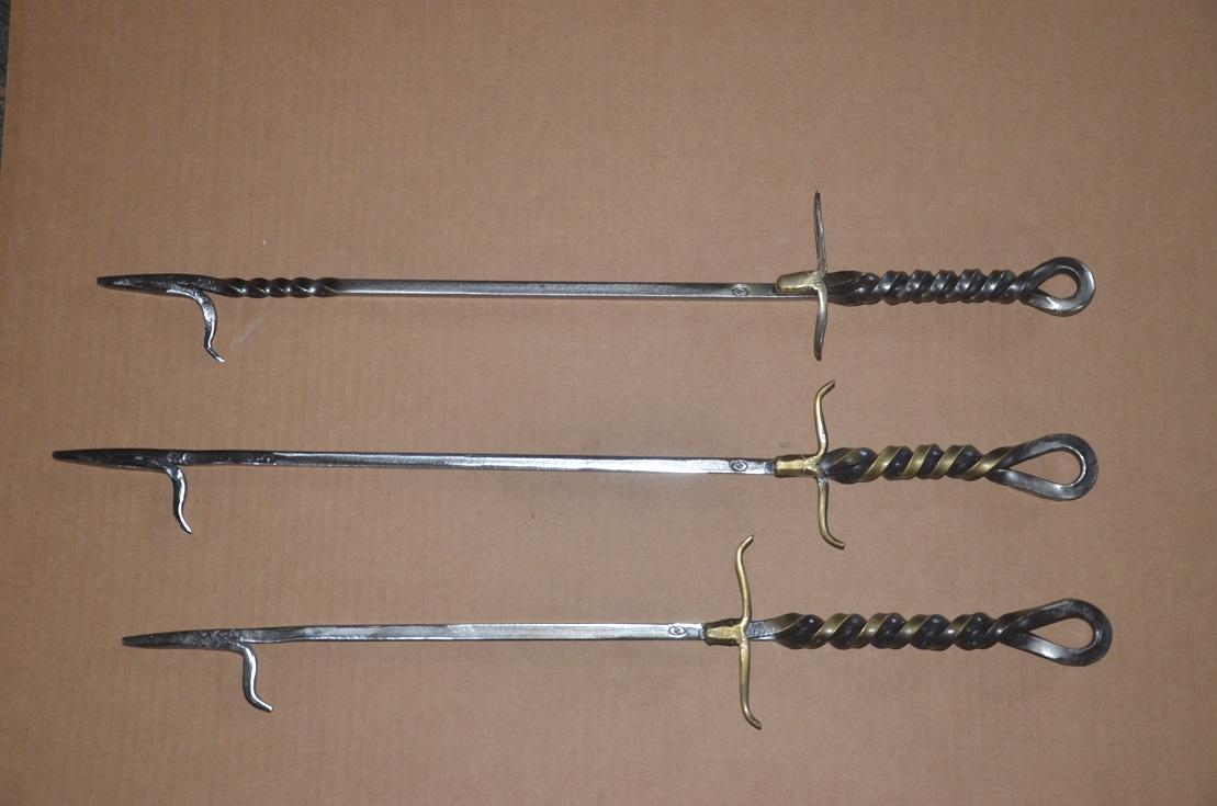

ausfire Posted December 7, 2018 Share Posted December 7, 2018 Been doing a few more of those full twists in 10mm bar. These longhorn pokers seem to have good balance and are comfortable in the hand. I like the heavier handles. Quote Link to comment Share on other sites More sharing options...
tkunkel Posted December 7, 2018 Share Posted December 7, 2018 Very nice work, Ausfire! Nice clean twists! I still need to do a longhorn. Yours are a good standard to aim for..... Thanks for sharing. Quote Link to comment Share on other sites More sharing options...
ausfire Posted December 8, 2018 Share Posted December 8, 2018 Thanks tk. I've done many hundreds of these heads (and rams) now and have then down too about 25 mins in 10mm square. You get faster as you refine the process and have the stuff ready. I would like to do a video demo of these but don't have the wherewithal. Quote Link to comment Share on other sites More sharing options...
Jasent Posted December 8, 2018 Author Share Posted December 8, 2018 I’d love to see a demo on those long horns Quote Link to comment Share on other sites More sharing options...
Irondragon Forge ClayWorks Posted December 8, 2018 Share Posted December 8, 2018 Those longhorn handles would make good knife handles too. The horns look like the guard. Quote Link to comment Share on other sites More sharing options...
ausfire Posted December 9, 2018 Share Posted December 9, 2018 Yes they would. The three in the first picture got sold, so I did a couple more for today's demo. It was suggested that they would make good handles for swords. Perhaps that's an idea … decorative only though in mild steel. I imagine it would be hard to keep the blade straight. Why is it boys always want you to make swords? Quote Link to comment Share on other sites More sharing options...
