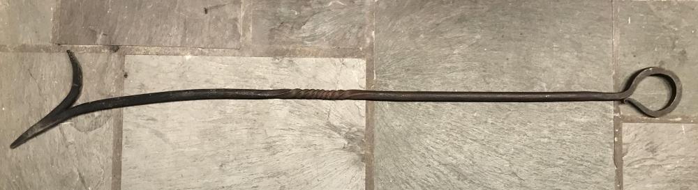

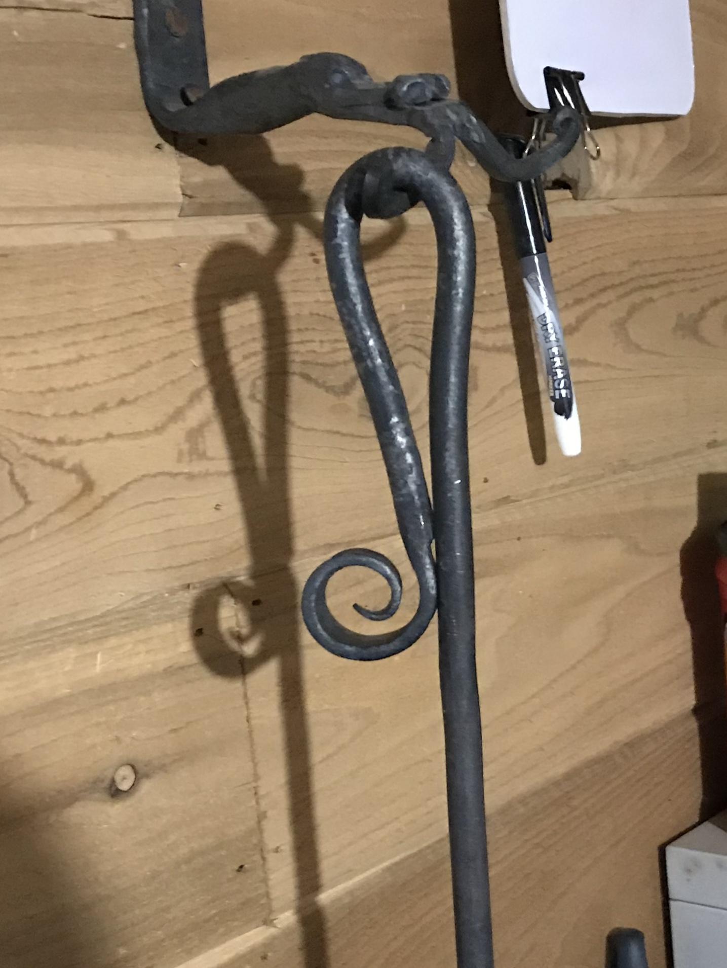

JHCC Posted October 6, 2018 Share Posted October 6, 2018 Here’s a poker I dashed off when I was still in my teens. It still functions better than just about any I’ve seen. Quote Link to comment Share on other sites More sharing options...
Irondragon Forge ClayWorks Posted October 6, 2018 Share Posted October 6, 2018 That qualifies as an antique then. Quote Link to comment Share on other sites More sharing options...
anvil Posted October 6, 2018 Share Posted October 6, 2018 inspiring stuff! Quote Link to comment Share on other sites More sharing options...
SLAG Posted October 6, 2018 Share Posted October 6, 2018 Mr. Dragon, Then, does JHCC's semi ancient work product qualify as an hysteric piece. I wonder, SLAG. Quote Link to comment Share on other sites More sharing options...
Irondragon Forge ClayWorks Posted October 6, 2018 Share Posted October 6, 2018 Don't know about that. My first fire poker I made when in my 40s was hysterical though. Quote Link to comment Share on other sites More sharing options...
JHCC Posted October 6, 2018 Share Posted October 6, 2018 My mom still has the one I made in my “Introduction to Blacksmithing” class back in 1983. It was my first drop-tong weld, and at my first much-too-hard hammer blow, the upper piece shot across the room and burned a hole in my backpack. Making this one was much less dramatic. Quote Link to comment Share on other sites More sharing options...
