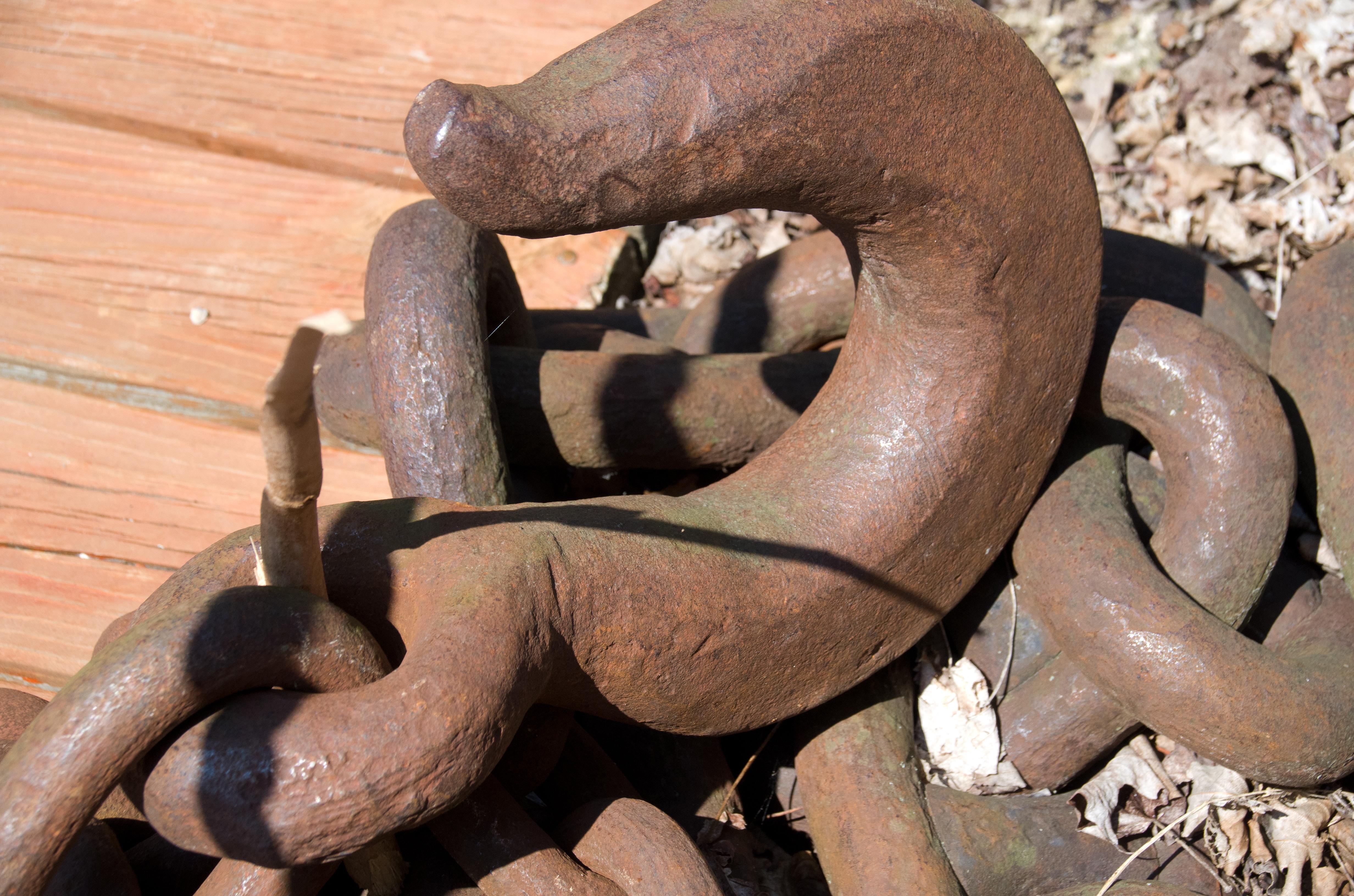

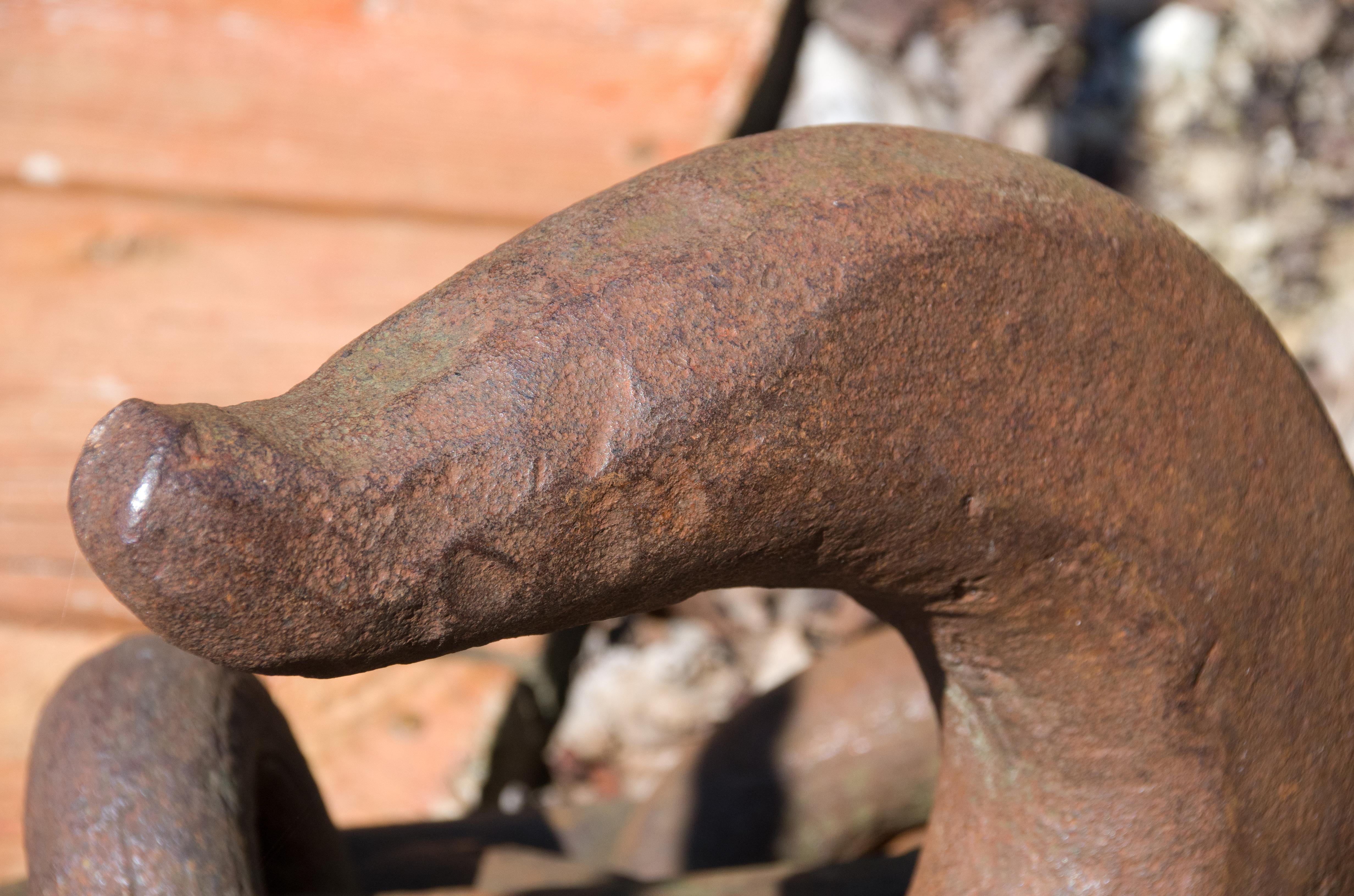

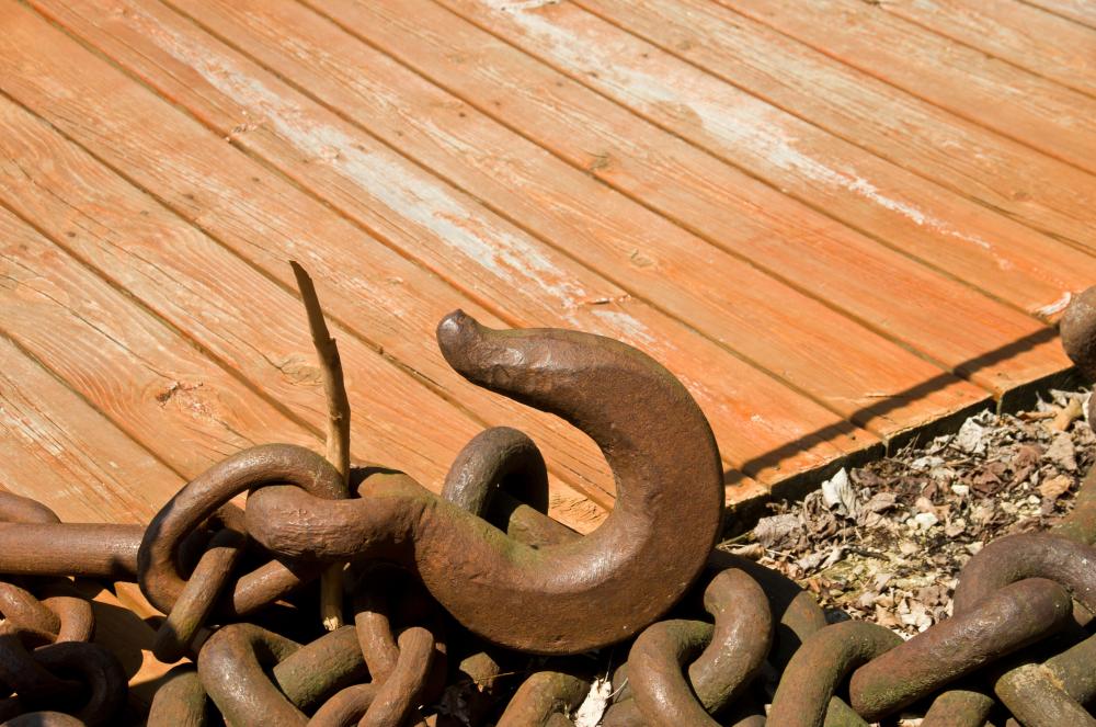

Recently I was in Door County Wisconsin.  Stopped by the Maritime Museum at Gill's Rock, (AKA Deaths Door)  Outside this hook caught my eye.  do you think it is wrought?  was it the product of a steam hammer?   You can still see hammer marks on it.  for scale, that it 5/4"x6" deck boards below it.
I would say Yes: the grain pattern visible on the side of the eye and on some of the chain links is pretty typical of WI.
Maritime ironwork that's exposed to salt air and ocean spray shows this kind of pattern even more vividly.
