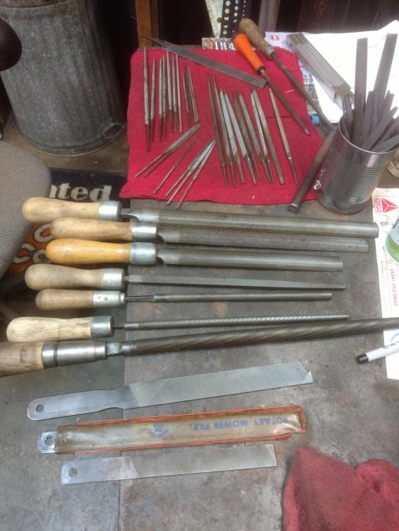

Went thru the files today,  cleaned up some and sprayed.  I keep a USA Nicholson bastard and smooth at the vise stand.  All my files are USA , most being older Nicholson and some Simmonds a couple Heller,  two made in Australia. The 3/8 round smooth Heller is my go to finish file
