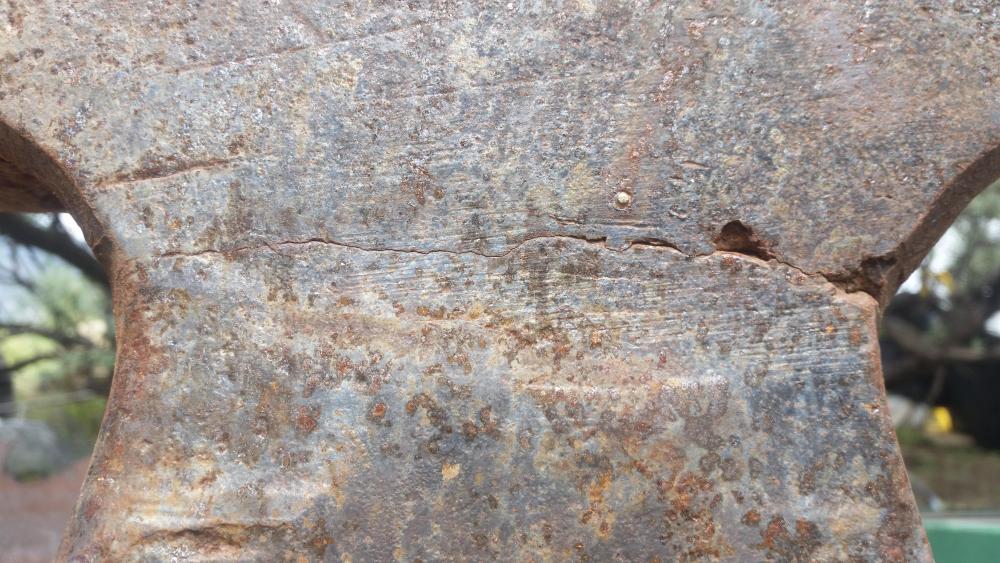

Jclick45 Posted August 10, 2018 Share Posted August 10, 2018 Hey guys, looking for some advice on this Trenton! On the left side base under the horn looks like "I546" and on the right "81". There might be more but unrecognizable. I found this hanging off the back of a farmers disk for extra weight . It was in bad shape, pix attached. The tool plate top was mostly gone. I cut the rest off and used the Robb Gunther method to repair the top. Well, I'm half done, the stoody 2110 is on, the 1105 is waiting to be burned. I'm curious how old this is? It doesn't have the "X" it is a clear "N". It weighs about 175 lbs, and she's gonna gain at least 10 lbs when I'm done. The thing that bothers me, it has what appears to be a crack all the way around the waist. I know this is somewhat common on these, but looking for more info. Is it a crack? It rings great, and the rebound isn't bad considering I'm not done restoring yet. It is also crooked, the top sits unlevel. The base is level, and the surface is level, its just welded crooked at the waist. Should I grind out and weld up the cracks assuming they are shallow? (I am a professional welder by trade) Last question, I hate the tilt. I would rather add material on the bases high side rather than mill off material on the high side. I was going to add weld to the base on the low side, then mill it off parallel with the top. What rod would you use? I was going to use 6013 as I think the body is wrought. Opinions? Quote Link to comment Share on other sites More sharing options...

Jclick45 Posted August 13, 2018 Author Share Posted August 13, 2018 Lol I agree with you completely frosty, been welding and fabricating for about 30 years now. Thanks for the replies! The face is already half done, the 2110 is already on and the 1105 is waiting to be burned. My question was more directed towards the base of the anvil, the lean drives me crazy and forces me to work with the horn on my left (hope I don't start a war there haha). I was going to build up the base on the low side and mill it flat, so the face would sit level. I have been using 6013 for the wrought repairs, like where they beat the cutting shelf to death. It has held up well, I will probably do my base build up with that. And I might just grind out some of that crack and fill it too, just for asthetics. I feel like she's solid it just bothers me to look at. And Anvil thank you for the cross reference on the rod, I wasn't able to find anything with my supplier, and as Frosty said the stoody is pretty hard to get Quote Link to comment Share on other sites More sharing options...

Frosty Posted August 14, 2018 Share Posted August 14, 2018 For reference use a "steel on stone" hard facing rod, it's impact deformation and chip resistant intended for things like loader bucket and crusher drums. Steel on steel hard facing is abrasion resistant but can be chipped under impact. If it's not too far off build a stand that's off level to compensate. Or just shim it. Frosty The Lucky. Quote Link to comment Share on other sites More sharing options...
John McPherson Posted August 14, 2018 Share Posted August 14, 2018 Or you could just consider yourself lucky to have found an anvil that dumps the scale on the far side of the work, instead of in your socks...... Seriously, some great smiths like Bruce Wilcock used anvils just like that to great effect for a lifetime. Many old anvils were off kilter, either fore and aft, or port to starboard. You simply adjust. Don't let a machinist's mindset take over and ruin a perfectly usable blacksmith tool. More anvils have been ruined by well-meaning people trying to "FIX" them than by neglect. A bubble level is only used by a blacksmith for product installation, never on his shop tools. Shim the base with a wedge if you have to, in order to sleep at night. Or build a stand that compensates for the angle. Quote Link to comment Share on other sites More sharing options...
