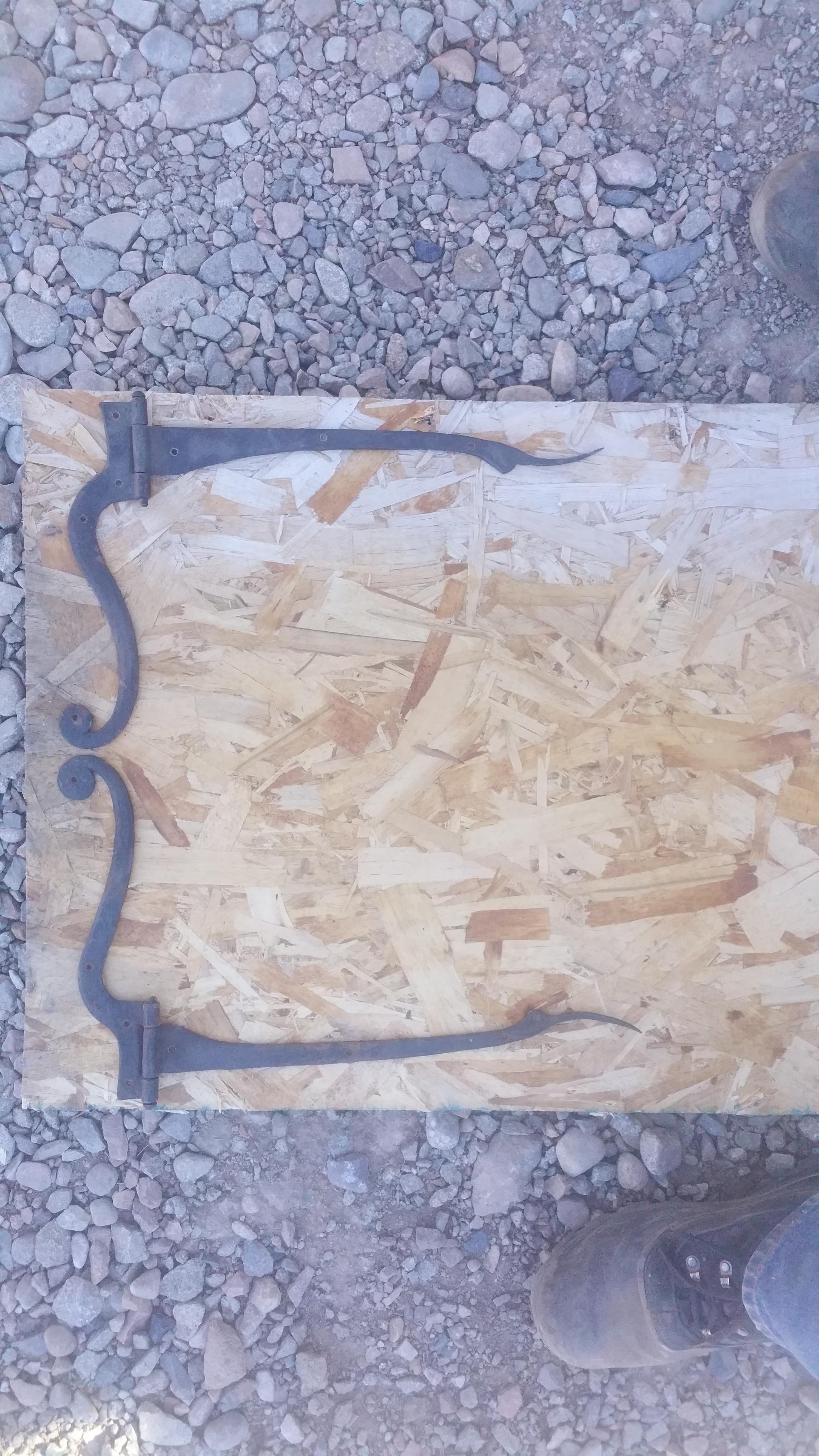

anvil Posted July 23, 2018 Share Posted July 23, 2018 19 hours ago, jlpservicesinc said: When I need the weight of a smaller item like a thumblatch reproduction or a hinge or fork or really any item up to hand forging size I just put it on a scale and weigh it.. much faster than a formula.. A simple example of a spatula. How do match this by weighing the whole spatula? Do you cut off the spatula and weigh it?how bout the tapered shaft? Or the finial? Jen, I showed you the bottom two pics a while ago. I included a write-up to explain my layout. Your response was,, "nice design" and "you rolled the barrels". NO coment on layout. That's ok, like you said somewhere in another post concerning "if you aren't ready for it,,," I'm posting this for those who ask how can you make a living in this craft, it's so time consuming, or whatever I cant stress enoufh both proper layout and understanding equivalent masses. From the simple to the sublime, these two skills will save you much time, and simply said, that saved time is money in your pocket. And they are really not that difficult to understand. Link to comment Share on other sites More sharing options...

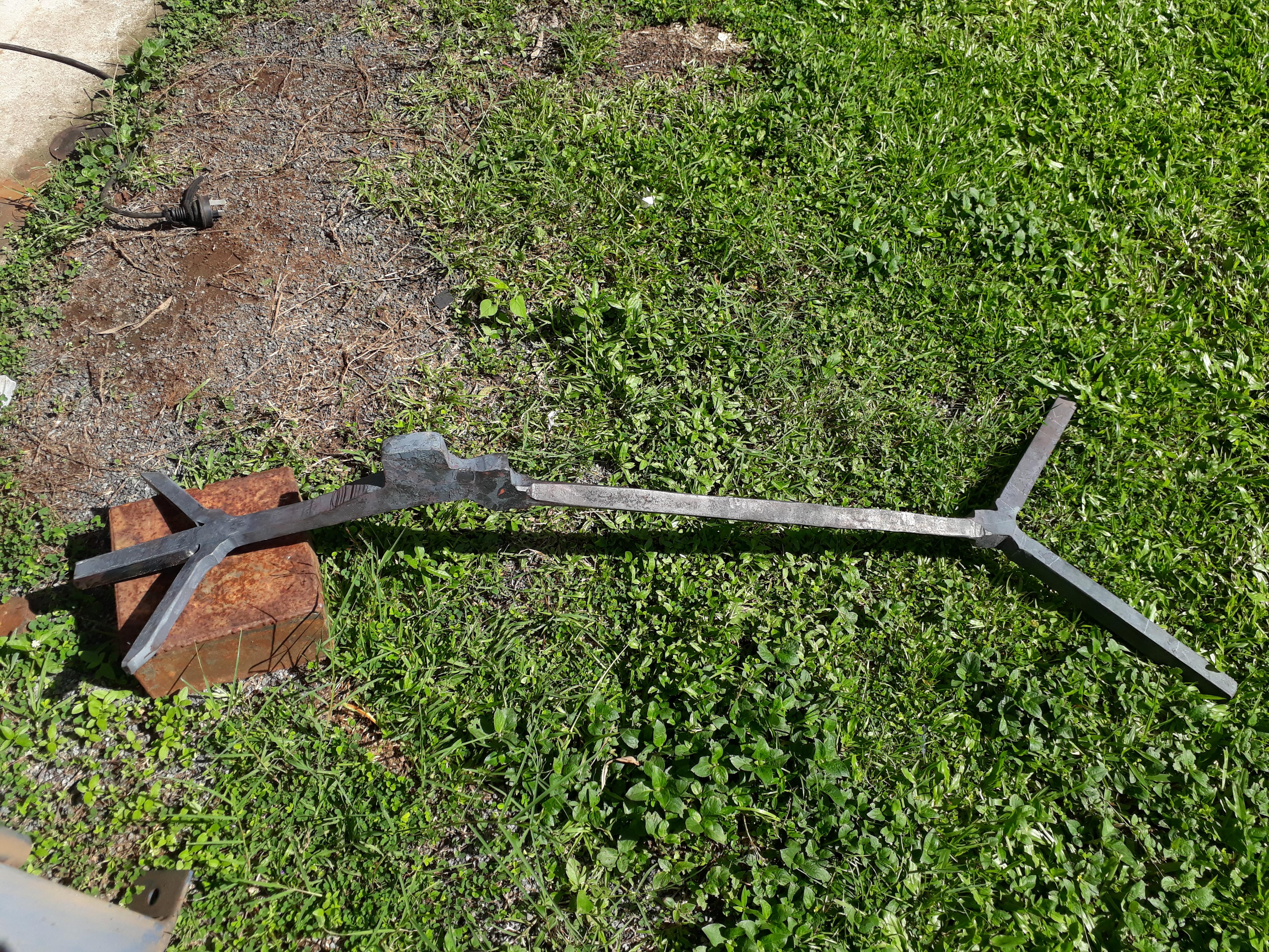

iron woodrow Posted July 23, 2018 Share Posted July 23, 2018 Calculating volumes is how i do my forging. Thats how i was able to work out the forging of my replica one piece solid backbone velocipedes, down to the cubic mm. Initial billet size 75×25×600 Link to comment Share on other sites More sharing options...
anvil Posted July 24, 2018 Share Posted July 24, 2018 18 hours ago, iron woodrow said: Calculating volumes is how i do my forging Excellent example! All Blacksmiths get to the point of using equivalent t masses or calculating volumes. And there are a number of ways to do it. Trial and error leads to "experience". A simple example is to make a 1/2"x1"x6" foot on the end of a 1" bar. Nothing simpler. Trial and error means guessing how much" is needed, and like Goldilocks, one is too short, the next is too long, and the third is just right. Now you have experience! And no need of math,,, U til the next one. Sheesh, now I want the same from 3/4" square! And 3/4" wide. Trial and error again will work. It what do you do when it gets complex? Well, you can turn it down, spend a lifetime or days of trial and error gaining the needed experience, or learn a few simple math concepts and spend a few hours drawing your dream and figguri g out equivalent masses. Considering one of the most often asked questions about our craft is "it takes too much time! I can't compete!". Seems a little math will put you on track for actually making a profit. Link to comment Share on other sites More sharing options...
jlpservicesinc Posted July 24, 2018 Share Posted July 24, 2018 On 7/23/2018 at 2:45 PM, anvil said: On 7/23/2018 at 2:45 PM, anvil said: A simple example of a spatula. How do match this by weighing the whole spatula? Do you cut off the spatula and weigh it?how bout the tapered shaft? Or the finial? Jen, I showed you the bottom two pics a while ago. I included a write-up to explain my layout. Your response was,, "nice design" and "you rolled the barrels". NO coment on layout. That's ok, like you said somewhere in another post concerning "if you aren't ready for it,,," I'm posting this for those who ask how can you make a living in this craft, it's so time consuming, or whatever I cant stress enoufh both proper layout and understanding equivalent masses. From the simple to the sublime, these two skills will save you much time, and simply said, that saved time is money in your pocket. And they are really not that difficult to understand. First I will apologize to all that this doesn't concern and it's going to be long.. I've given this much thought and frankly I lack the words to express "It". Anvil (Lee) and I have had a few conversations via PM which deteriorate sadly into nothing,.. He has shown me wonderful pictures of work that he supposedly did.. Very nice wrought iron work.. He (Lee ) is a nice guy and reached out with comments about the videos I had produced and He offered to give me some insight into gaining more hammer prowess.. And he also introduced me to Francis Whitakers cookbook.. Thanks you for that Lee.. I'm not a word smith, nor a person who uses words to fence with others using words.. If this is the case.. I don't have time for that.. I work very straight forwards with.. "How do you do this'? This is how it is done.. Or Here, let me show you.. If there is a question I don't ask the person a question as the answer to their question.. This is what ended up happening and it's happening here as well... I gave up.. I find it to be to daunting to be worth it.. With this said... I don't think like anybody else.. Nor do I care to.. 30 years ago, as I explained early it was all about formulas and oh, look how smart I am.. Now I don't care.. I don't need to impress my friends.. When I decided to make the "How to video" and add my opinion to any topic on this forum It's done with only the regards for the information as I see it, based on my experiences with an in-depth knowledge with forging the types of items I forged and forge today.. Blah, blah, blah... What a person takes away from it or doesn't is up to them.. It was a struggle as to whether or not creating content as what I promote is not in favor with the outspoken and it's the outspoken here and everywhere that turn the wheels and have the most influence... At some point it takes to long writing wise to clarify these questions with questions and it gets " created into a chess match with words" which others find pleasure in.. This just wastes my time.. If you want to see what I can really do with forge, anvil and hammer, see me at a blacksmithing meet or demo.. It doesn't get any simpler than that as well.. I have no problem being asked how to make something and then just making it.. So I will address your statement of: ( Jen, I showed you the bottom two pics a while ago. I included a write-up to explain my layout. Your response was,, "nice design" and "you rolled the barrels". NO coment on layout. )I didn't know you needed a comment on the layout.. If you needed a comment the conversation goes kinda like this.. (What you think of the hinges??? Also what do you think of the layout of the hinges. This is what I do to get the measurements... ) I can not read your mind nor do I try to jump to conclusions.. Besides that as I have all ready explained I don't " DO" abstract conversation... The hinges and the spatula are not my particular style but nice forgings just the same.. It was the hinge eyes I was interested in as "Hinge eyes" are something I am always on the look out for.. Guess you didnt' know that.. I really enjoy seeing a well forged hinge barrel especially if it's welded. .. Wrapped hinges again.. Eh.. But a nice welded hinge barrel.. Well that is nice to see.. So, My lack of input towards your layout had nothing to do with your skill set or showing it to me.. Again, it's something I had done many times and not new.. As I have all ready stated multiple times which you refuse to address: Figuring out via formula to find the given mass or volume for a forging isn't a "New skill to me".. That was a basic skill back in my 20's... So dismissing what you really wanted me to be acting over is just run of the mill Forge work.. The " AWE" factor just isn't there for me on hinge layout.. Again, been there and done that.. (A simple example of a spatula. How do match this by weighing the whole spatula? Do you cut off the spatula and weigh it?how bout the tapered shaft? Or the finial?) I don't know how to address your comments on the spatula and it's taken me this long to respond because of the things all ready mentioned. I'll assume you really don't know and have never forged anything so will answer your question though I know it was sarcastic in nature: Again, for the weight of it and cutting it in half.. I know this is another Question which you really don't want an answer to. so it's really more of a sarcastic remark than a question.. So, If you need to cut the spatula in half to get the weight for you to be able to forge it. Than I guess that is what you will need to do.. Personally, I would weigh it,, Then start with a piece of metal that will offer me the width I need with the spatula part forged to the correct size.. Once this is done.. The handle will have the correct amount of material all ready in place for all the shaft, hand and finial.. Simple and forged to dimension.. If you want exact starting metal size with the bar punched for where things will be.. This is all on you.. As I have no interest in doing that kind of thing for a spatula.. Why because I don't need to, to get to the required exact specs.. I would eye ball it and just forge it out.. Some people have different skill sets and some are more talented than others in certain areas.. As a pro I could look at something and know instantly what size stock to use without measuring anything and yes it would be forged to dimension.. Today.. Nope, I can come close just by eye but now it takes me awhile to think about it and process how many inches can I get from X and Y and Z. Measuring things makes it a whole bunch easier.. So yes I do measure things more to be a certain size as I can't figure out as quickly in my head that there are 8, 1/8" in an inch and lay this out in metal.. I used to be able to see it as clear in my mind as this computer I am typing on.. If you need more than weighing the metal to get a starting size, to make something than I suggest that is what you do.. But weighing something will give you a starting figure to work with so you can do it simply and quickly.. you don't agree.. Oh well, didn't cost anything. Since you guys love formulas: One cubic inch of steel weighs 0.283 pounds.. So a 1" sq piece of steel 1ft long weighs (1"X1"X12 X 0.283) 3.396 lbs, a stocking list from a steel supplier will give you the weight per foot for a given bar size.. It's pretty easy from there.. Or maybe it isn't for others.. Maybe you can't see it? So maybe you need or do best with getting everything straight before you start.. This is ok.. Do what you must to get to the finished product.. Once you know the basics of forging one can envision what is needed for a starting stock to get to the completed item with little fan fair.. Especially if you have made a few hundreds with a few hundred variations.. If not in the "Know" because of a lack of experience and you feel so inclined, there are books that will give you the formulas and maybe Anvil will even supply it on a separate thread.. If one is making " Copies" of parts for other things that can not be weighed on a scale this becomes a different animal all together and then it really becomes a matter of measuring the pieces and then averaging and finally figuring out where to mark it for a given size or volume of stock to get to the desired sizing and length.. Which is what you showed in your drawing/ layout which is very important if you need it.. All of this blacksmithing stuff " Is not brain surgery".. And again if you guys want to keep going on about " Oh, well I do this and you do that. Or just expressing your brain muscle so be it.. I find the back and forth banter, to be useless.. Back 30 years ago, I would have jumped on the band wagon with you shouting formulas for all to hear.. it was much more important back then for what I did vs " Now".. And I don't want to sound dirogitory, negative, or sarcastic, but if you are really trying to teach something to someone or a group.. This isn't the way to do it.. As I have said, Don't answer a question with a question.. or as a question so you can play with it to ask another question.. If a question is asked simply answer it.. Be a teacher the student needs not the kind of teacher you feel they need.. There is a very large difference.. I don't know you.. And you don't know me. The only difference is I have put out information and videos because I wanted to share it in a way that may or may not help someone.. I sent you the phone mount so you could make a video and show me your hammer method with increased prowess and join the revolution.. LOL.. If you really want to get "Your point across with your method" Start a thread and explain your method for all to see.. While I value the work you have shown It really doesn't tell me via still pictures what kind of smith you are.. Someone can make a really beautiful forged knife, but in reality the person just forged out the tang and ground the rest.. This is an extreme example, and is on par with the comment about splitting the spatula.. If it continues with a Question with a question of non sense I won't be responding back to this thread.. Coming from as skilled arenas as both you (Anvil) and Marc1 and Ironwoodrow are supposed to be it was funny that after the fact of me asking or commenting on differences on anvil sizes and both touting formulas you both finally came forth to say you own and use larger anvils than the 120 somethings.. Yes I could go back and quote it.. but no need.. If you really want to show your prowess both with formulas, and forging to dimensions than start a thread dedicated to it with pictures and explain what you are doing and why.. Or better yet a combination of pictures, diagrams and videos.. Again, It's not something i need but since these seem to be important to you, I"m sure it would help others since one works in "inches" and the other in the metric system.. Iron Woodrow,, That is cool.. What's it like to ride? What was your starting stock size? Sullivan metals Stock_LIST.pdf Link to comment Share on other sites More sharing options...

iron woodrow Posted July 24, 2018 Share Posted July 24, 2018 Jen, the starting stock size was 75×25×600 (millimetres) They were called boneshakers for a reason!. Once complete they will have timber cart wheels with steel tyres instead of the plywood display wheels on it now. The calculation of volume is exactly the same in metric and imperial, as long as you dont mix anything up (ie: mm with m, or ' with ".) That said, it is far more favourable to use decimal, since dividing or multiplying fractions by pi is a brain melter, which i guess is why users of the imperial system usually dismiss formulas as hocus pocus (too hard) Your method of using weights from lengths in stock catalogues is pretty much the same, with the exception of tapered sections, and i was told of the weighing technique by the boss when i did my apprenticeship. While i see your the point of your previous posts, i still believe that in a forum such as this, the positives of pointing out the multitude of ways to skin a cat far outweigh the negatives. This trade draws from so many different types of people with more backgrounds than one can poke a pointy stick at, and some are learners through trial and error, whereas others prefer theory. It is important to point out that there is no one way to be a master of this trade. I learned when training apprentices that there is no fix all way to teach, and some loved calculating volumes, while some loved wasting the bosses time, stock and money by not taking on simple mathematics and just going for it. Unless you have years of experience through working out how much 90mm round it takes to make a 25mm square 500mm long, or have someone to give you a table of volumes, then how hard is it to string a few numbers together? 500× (25×25) = 312500 The area of 90mm round is determined by using pi×(r×r) 3.14×(45×45) =6358.5 312500÷6358.5= 49.14 (round up to 50 for scale loss) 50mm of 90mm round will give 500mm of 25 square. This was not intended as a lecture to anyone in particular, but since examples were called for I thought why not (smileyface) I hope someone finds this thread one day and learns something from us, since each one has a different style! Link to comment Share on other sites More sharing options...

anvil Posted July 25, 2018 Share Posted July 25, 2018 On 7/24/2018 at 1:14 PM, jlpservicesinc said: Personally, I would weigh it,, Then start with a piece of metal that will offer me the width I need with the spatula part forged to the correct size.. Once this is done.. The handle will have the correct amount of material all ready in place for all the shaft, hand and finial.. Simple and forged to dimension.. Now we are getting somewhere. You write very long posts. So flesh it out. There's no way a total beginner could get anything out of that. Show a beginner your process. Here's some dimensions, but feel free to make this to your design, just a one piece spatula. Spatula ~3"x5"x1/8" Handle and shaft. How you want. And comfortable length for a outside charcoal grill 18"-24" length? Full taper from say 1"x 3/8" to 1/2"x 1/4" and whatever you choose for length. As a beginner, I'm interested especially how you do the transition(change) from spatula to shaft. Im also very interested in how you figured your parent(initial) stock. Meaning "What do you start with and why?". And "how do you get from the start to the finish? Your words. A good session from you to all in understanding the process. Who knows, it might be a good handout for any kind of demo you do anywhere. Oh, an exit. You have this amazing deja vou that this guy will be back and want a match. And sure enough, it happens! A year later this dude comes back and wants an exact match! His bud challenged him to a beer drinking burger flipping challenge from Hell and they need matching boy toys!(or girls,) And that's the process I want to see. Link to comment Share on other sites More sharing options...
